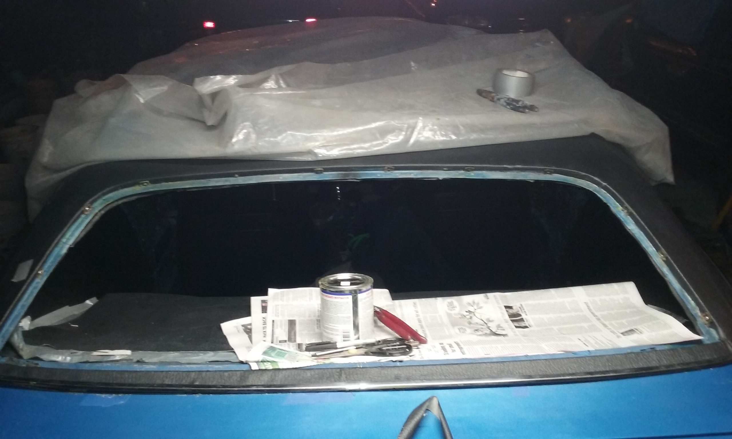

Hello gentleman a question please,
I am close to installing the glass on my 72 Challenger, some of the rear window studs are missing where the clips for the stainless trim attach to. I have the push on clips for the current studs, is it possible to to screw on the push on clips? Or is there another option? Thank you.

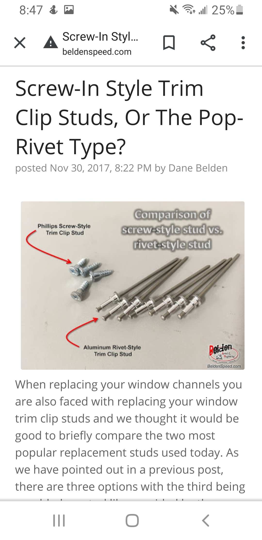

There are also rivets available, that's what I used. Gotta hunt down where they were obtained and get back to you.

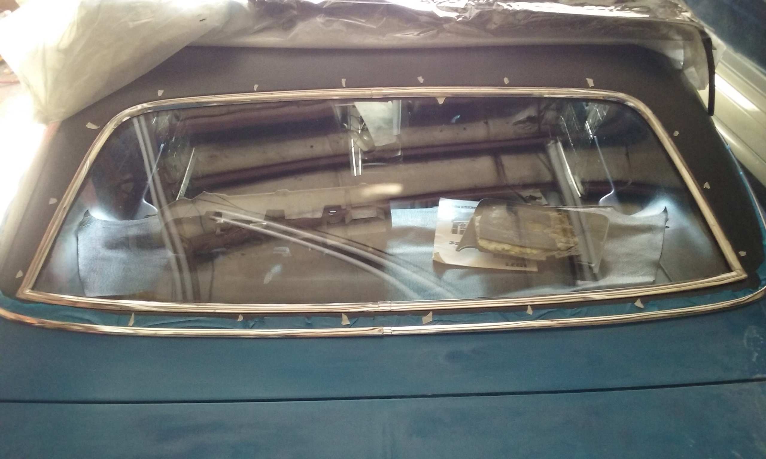

So the next question if you don't know. Where do they go? Not on the radius. Having tape in place helps when you are installing the trim.
