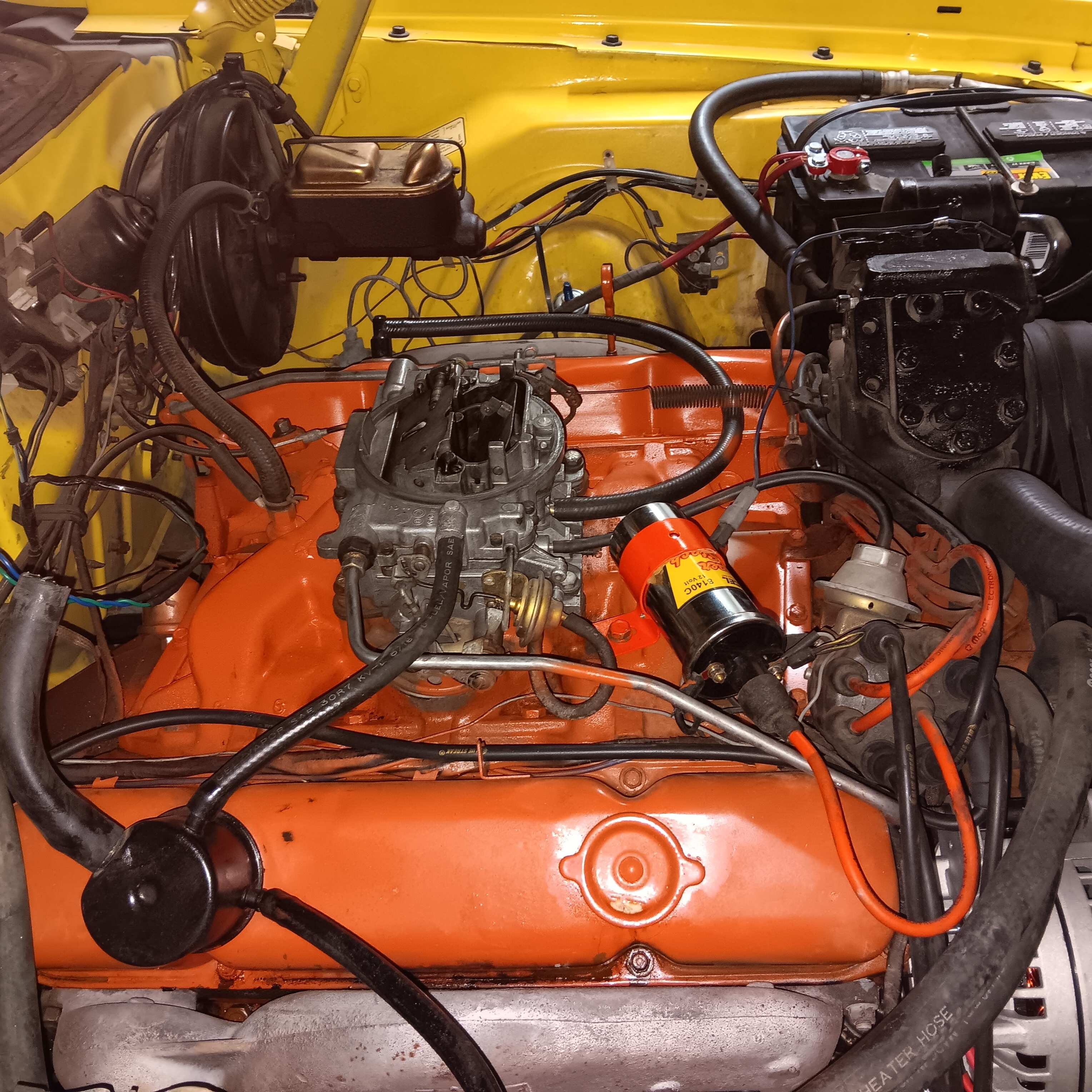

Looking for a stock appearing performance recipe. I know it's not stock appearing, but will be running 1-7/8" headers through stock mufflers and resonators. Would like to retain A/C and ower brakes.

Street car I already have a Edelbrock Performer. Considering aftermarket alum heads, if anything, to get some weight off the nose. I would have both powder coated or painted to match block. Want to end up with a setup that would work with minimum 93 pump gas.
