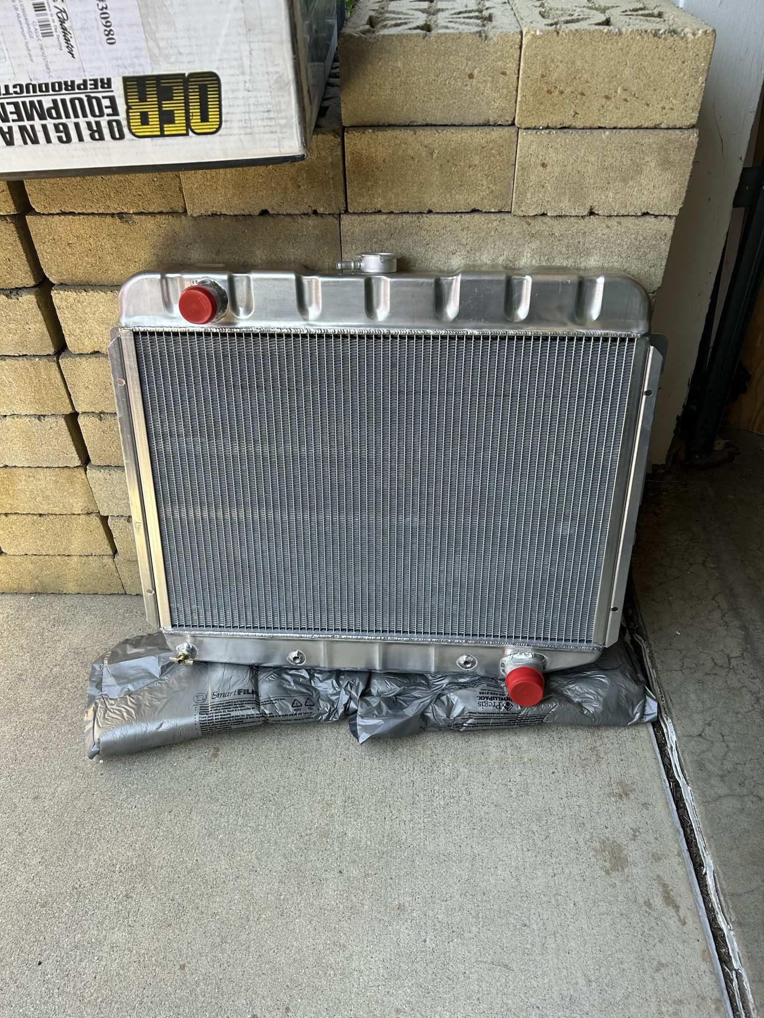

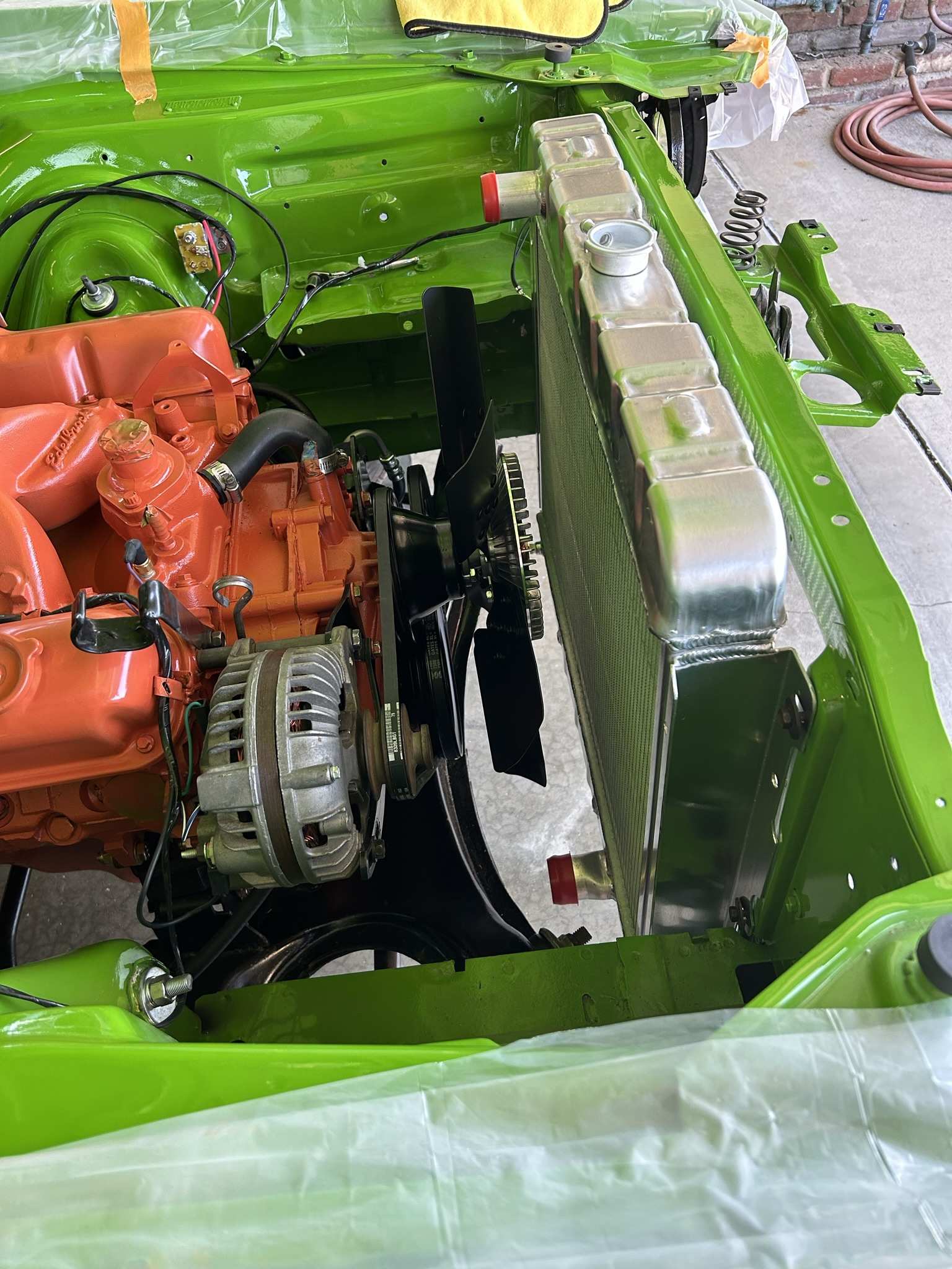

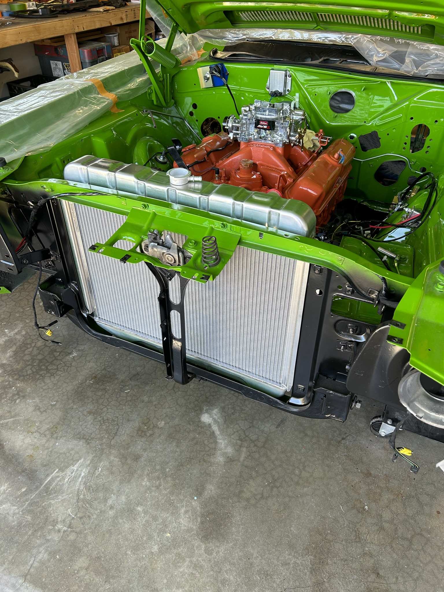

I'm working the same engine/trans combo and I just went through this myself, I spent over a month looking for one and finally found this:

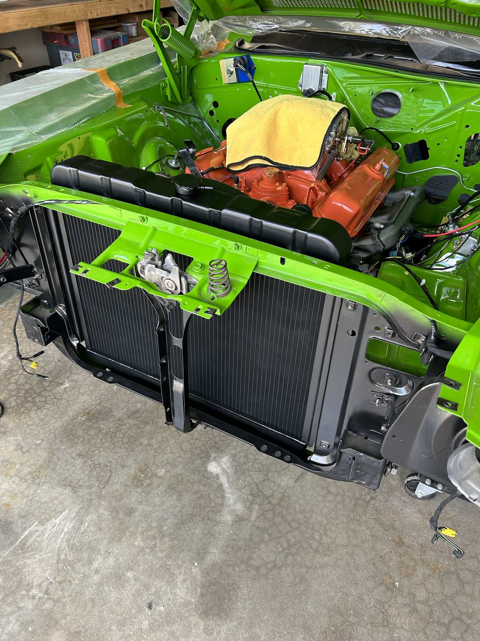

If you don't need original looking I think it's a good solution. USA made 2 row aluminum 26". It's $587 list from C.I. but I got 10% off during their labor day sale. I've sprayed it with Eastwoods Radiator Black since I took these pictures because I don't want that bright silver behind the grille. If originality is your thing then a Glen Ray is the only way to go BUT it's about $1200.00.
OER offers a straight brass version as well in 3 AND 4 ROW also USA MADE. However, the 4 row was out of stock when I pulled the trigger on this one. Champion and Cold Case are cheaper and seem decent but I just couldn't pull the trigger on non-USA made parts... Just wanna keep my fellow Americans employed, can't help it.. Not bagging on other countries btw, just my personal preference when it comes to parts, and a lot of other stuff.

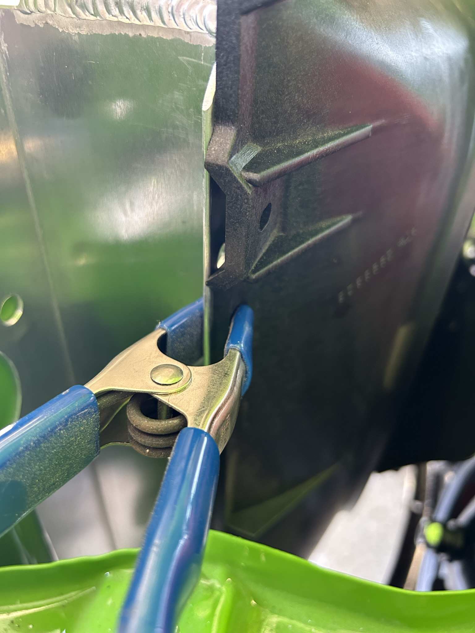

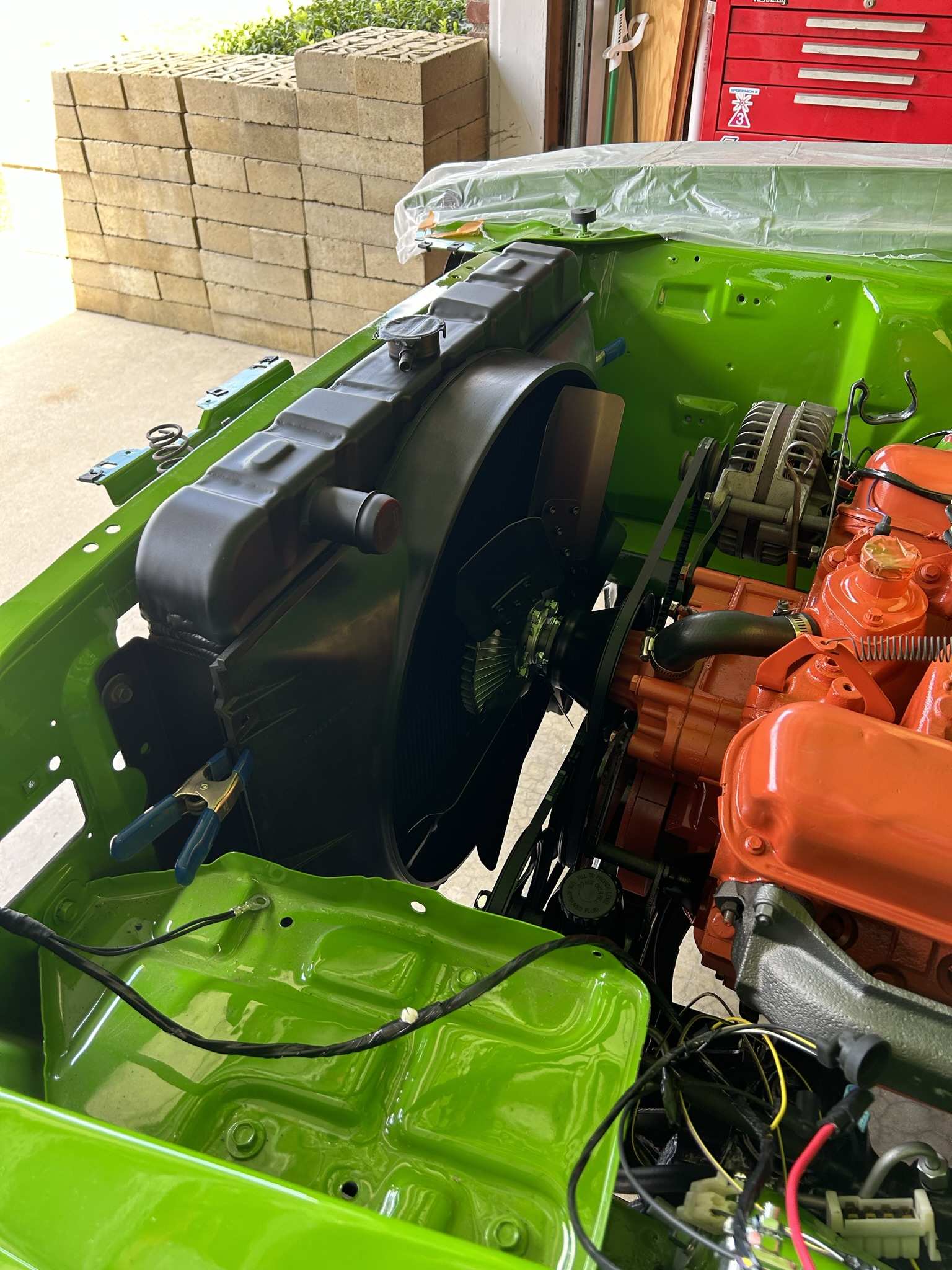

My only very small complaints would be the fit at the bottom drivers side mount. I had to remove material from the radiator frame (not the car) to get the bolt where it needed to be. It's a snug fit. The other issue I ran into is my fan shroud. The holes that are provided were too low so I had to re-drill them about 3/4" higher to clear the fan. I'm also using 1/8" thick hard rubber washers between the radiator and the support to mitigate any flex from the radiator... some folks say ya need it, some say ya don't 🤷‍♂️
