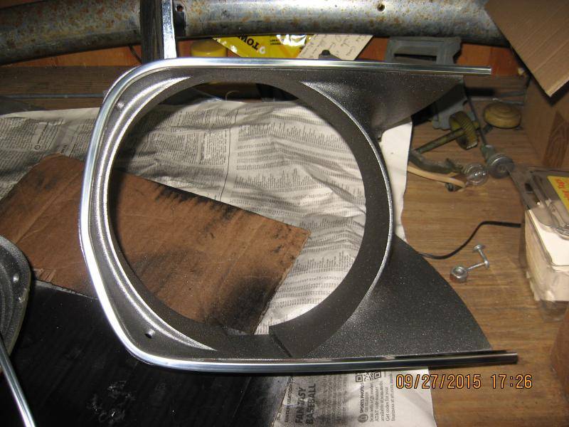

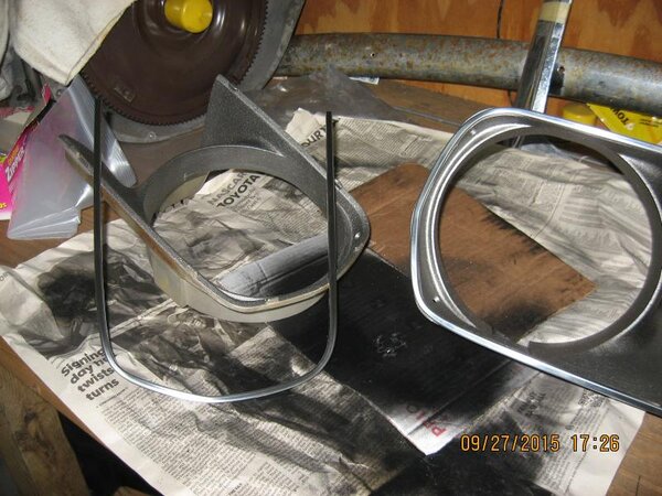

- The new stainless steel trim pieces slid onto my original Grille and Bezels fairly easily, but again, patience was key here.

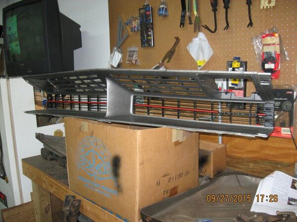

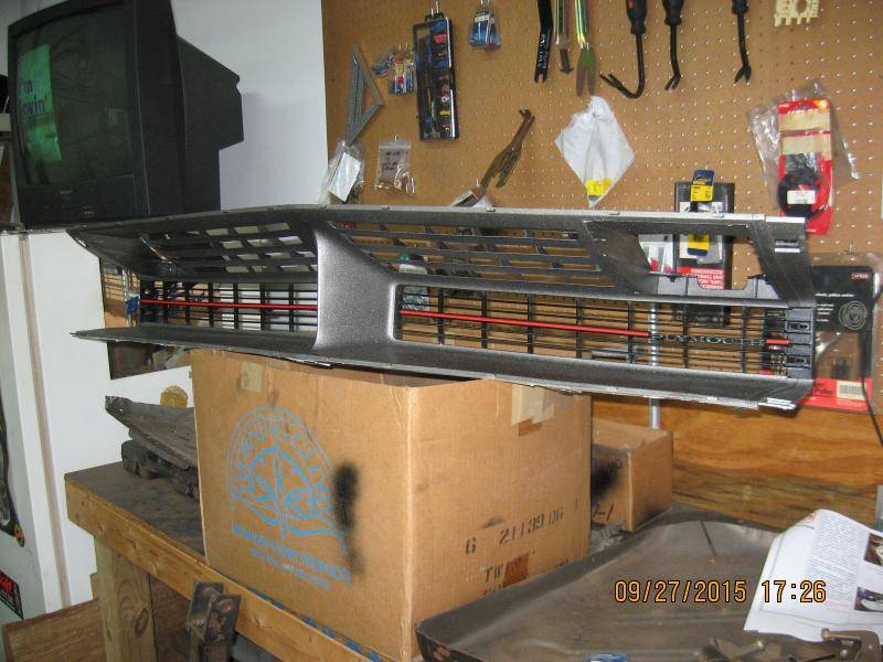

In the pics, you can see the new SS Trim on the repainted Bezels, and you can see the center Grille painted but I hadn't put the 2 long trim pieces on it just yet.
