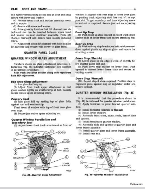

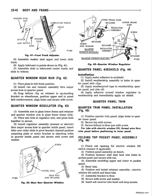

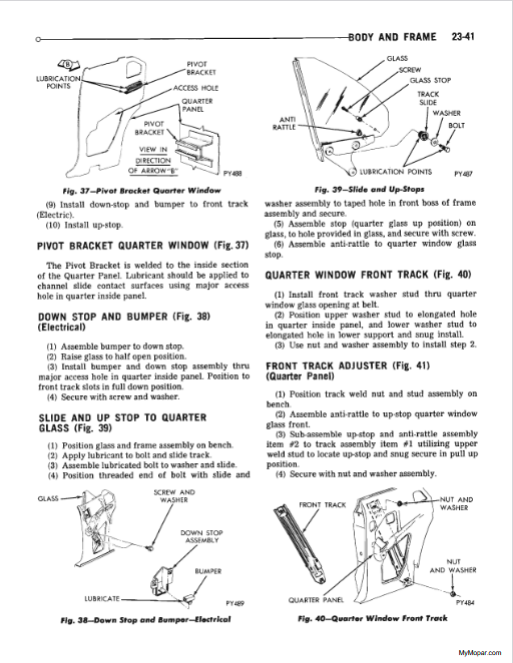

RH Rear Sail Panel Window won't mate up correctly with Passenger door glass
SRKlegin
Oct 11, 2021
245
56
Roy, UT
Can someone supply me with an assembly drawing so I can figure out how to adjust it? I appreciate it immensely!!!
