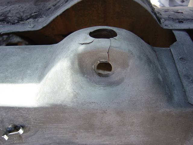

The ride tech system looks like it eliminates the leaf springs and uses an inflatable shock to support the rear. Problem is the rear upper shock mount is too thin and not designed to support the weight of the car, it will crack without reinforcement...
