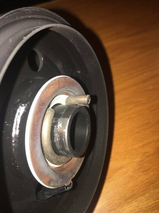

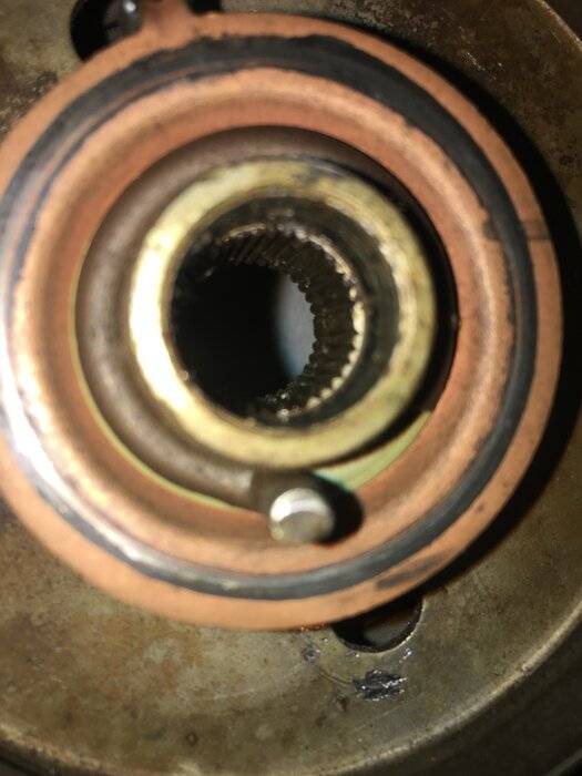

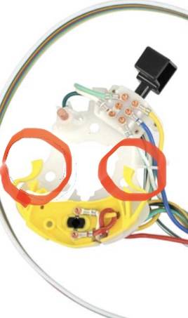

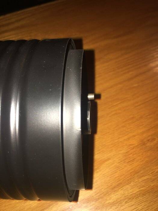

I recently restored my 71 vert, working on some of the small problems now. My turn signals did not work, purchased a new turn signal switch from Classic industries and installed it with no problems. Both L and R turn signals are very crisp and they work. The Left turn signals cancels after turning L. The R turn signal will not cancel after turning the steering wheel. I’ve pulled the steering wheel and can several times and everything looks fine. The crush can has a slight groove and will only go on one way. Question, when installing the crush can, does the cancelation pin has to be in a certain position?? Any help would be greatly appreciated. Thank you
