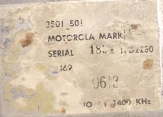

The radio should have a label on it with some Motorola information and Chrysler part number, if not worn away or too damaged to read. A Motorola label for a 1972 - 1974 E-body AM/FM-Multiplex radio with cassette player connector, Chrysler part number 3501501, is shown in the following image:

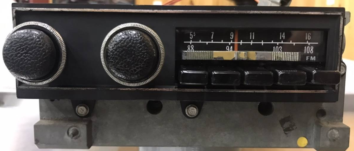

The 3501501 radio is shown in the following image:

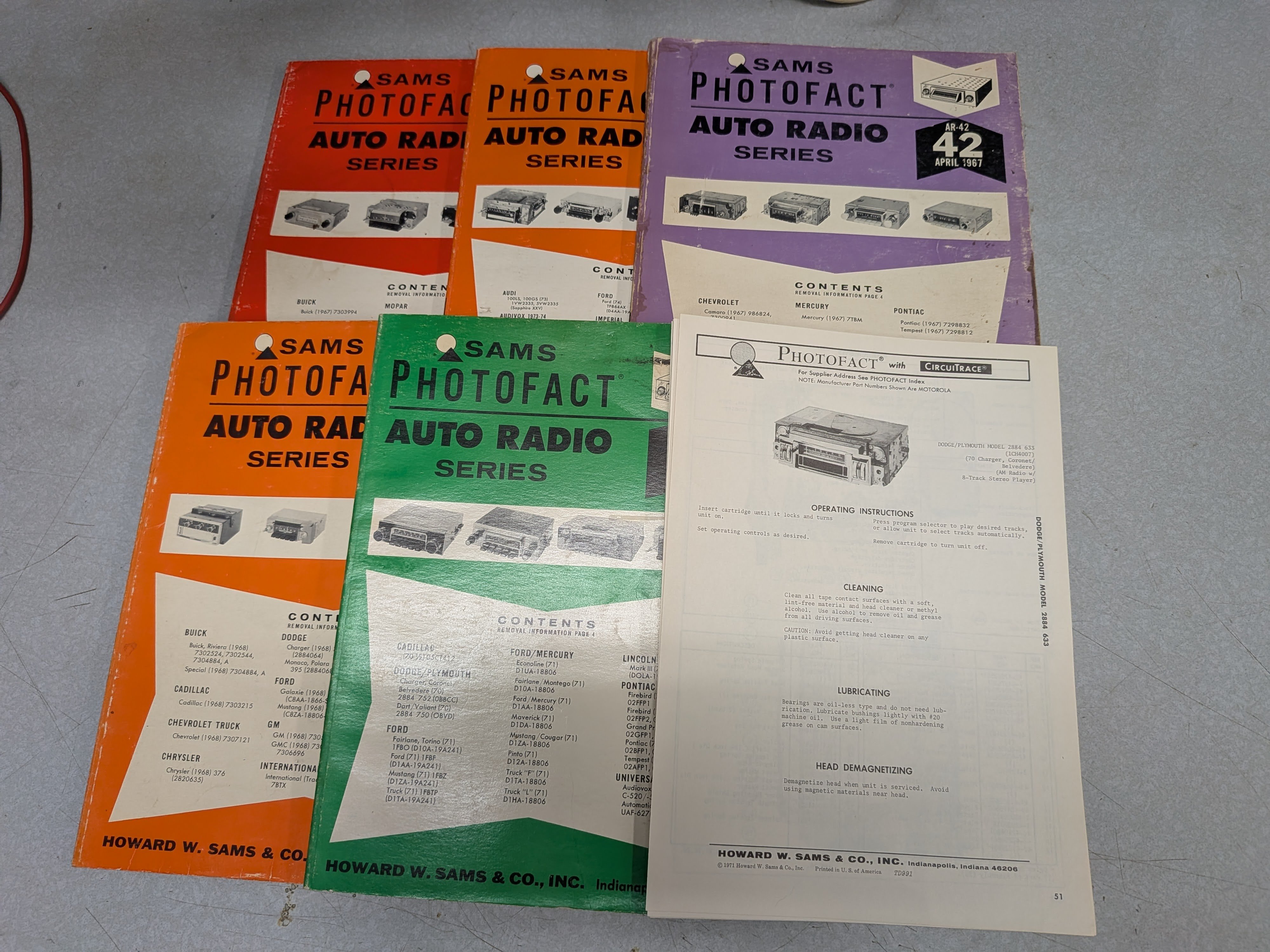

The manufacturers that built radios for Chrysler produced their own service manuals. Chrysler built some of their own radios as well, particularly in the later 1970s. With the part number and vendor information, a service manual, including schematic diagrams, might be found. The following image shows some radio manufacturer service manuals:
Sam's Publishing has produced a series of service manuals for a multitude of electronic items since 1946, including car radios. The Sams Photofacts Auto Radio (AR) series cover these. Several collections covering different models were released each year, usually a few months to several months after the model was released. The following image shows some AR manuals and an except from one:
Sam's Photofacts can be found online for free download, but not all are available. Some are available to purchase as download or paper manuals, including from Sam's Publishing.
The AR-135 and AR-152 contains the 3501501 radio.

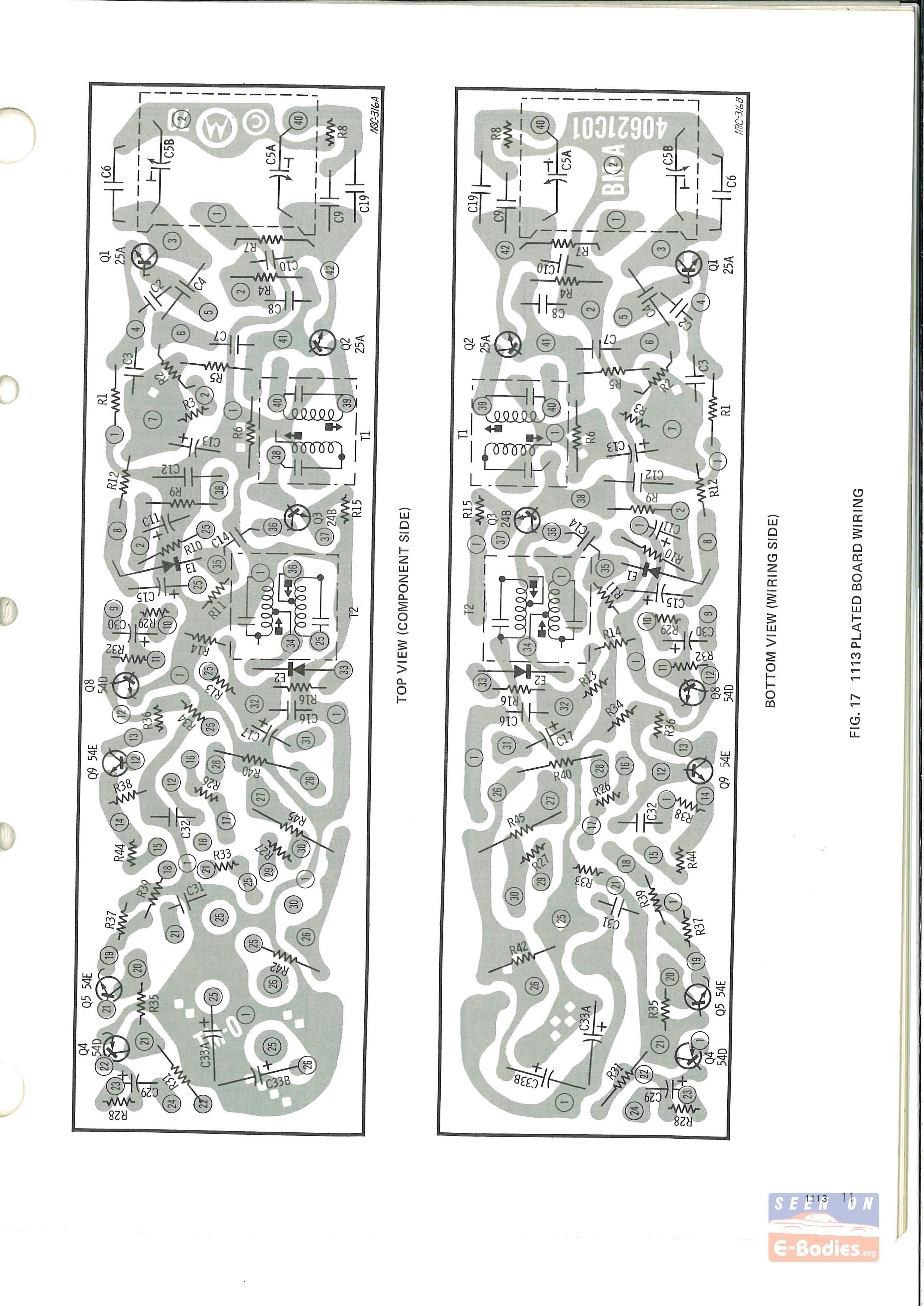

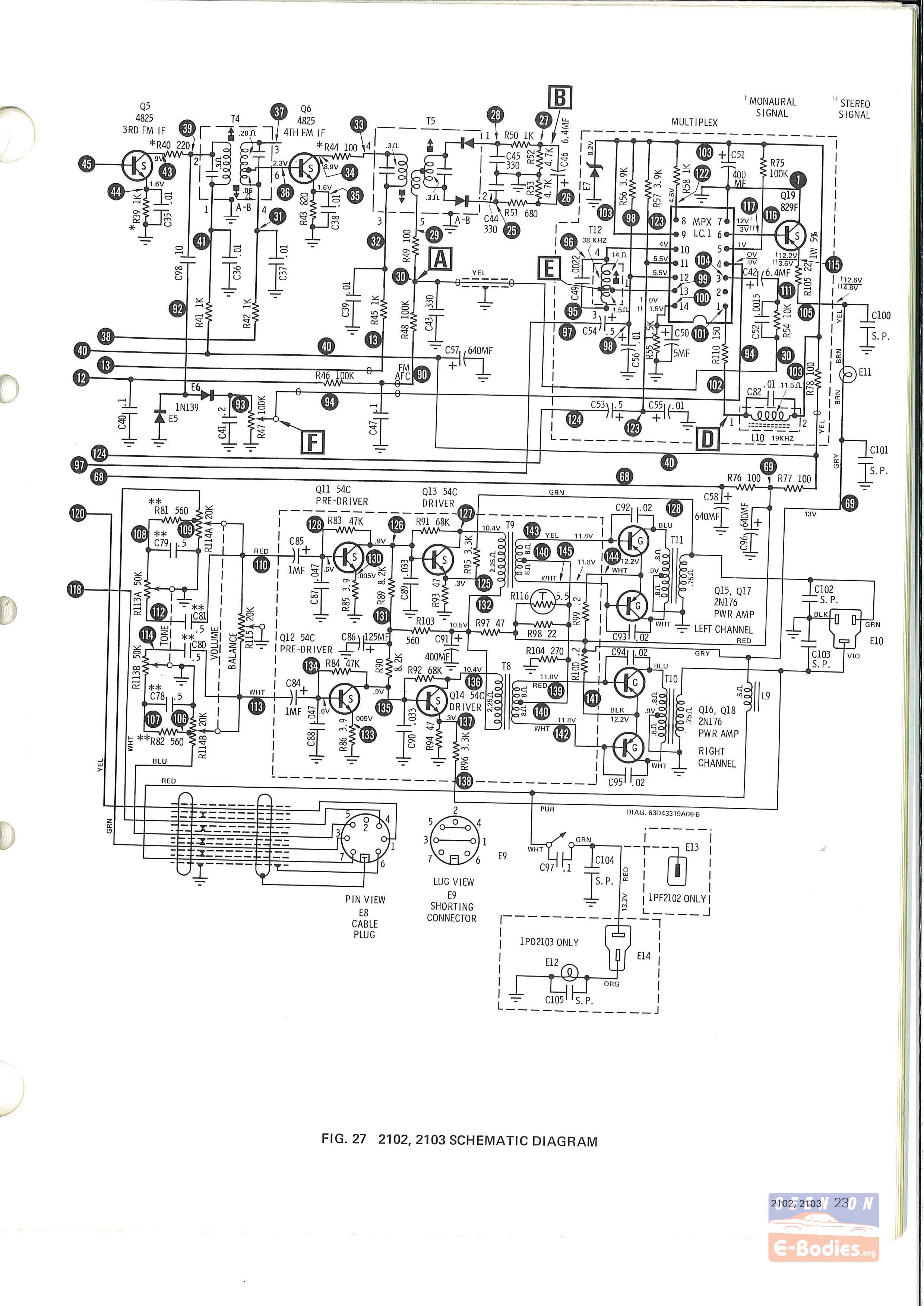

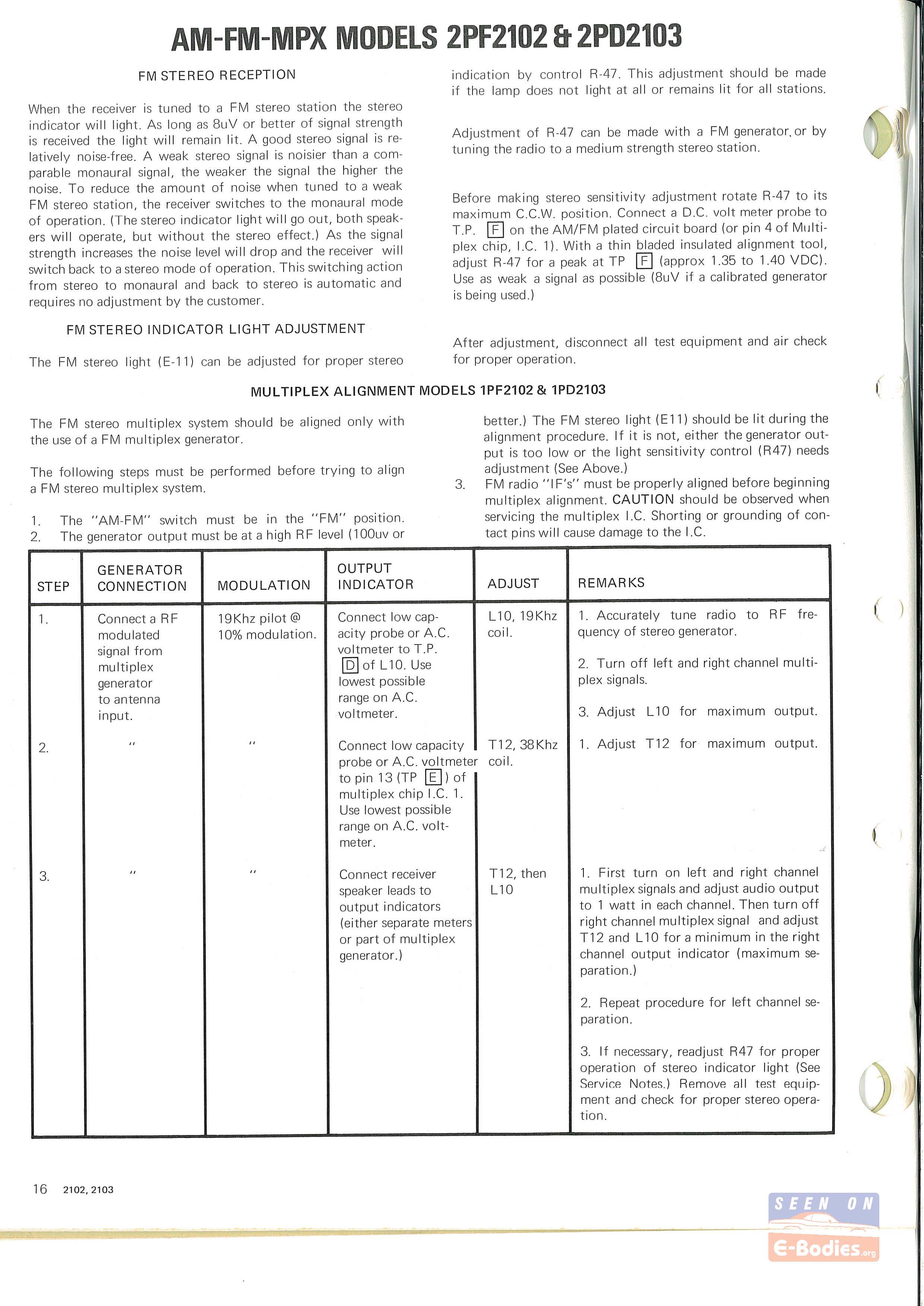

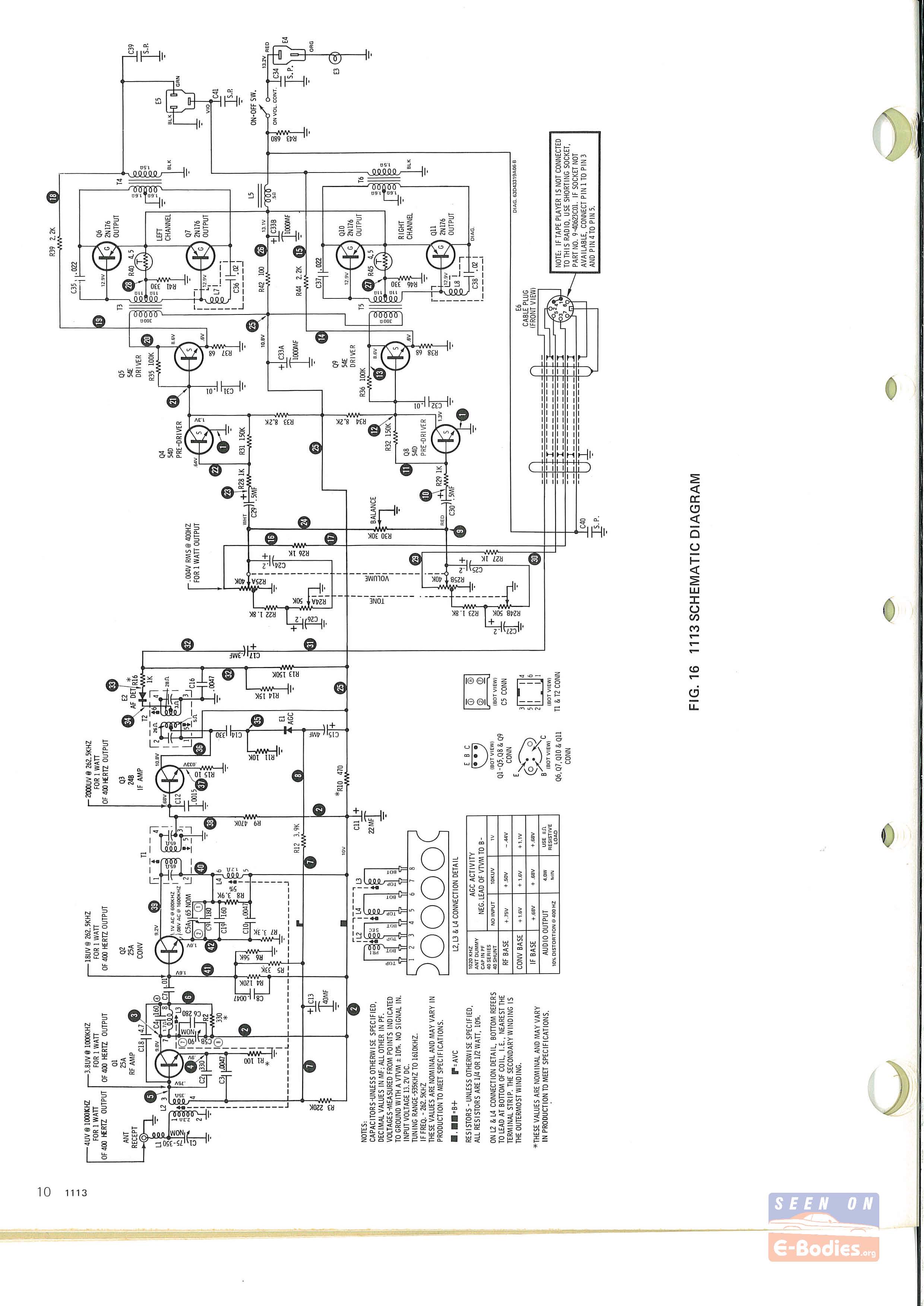

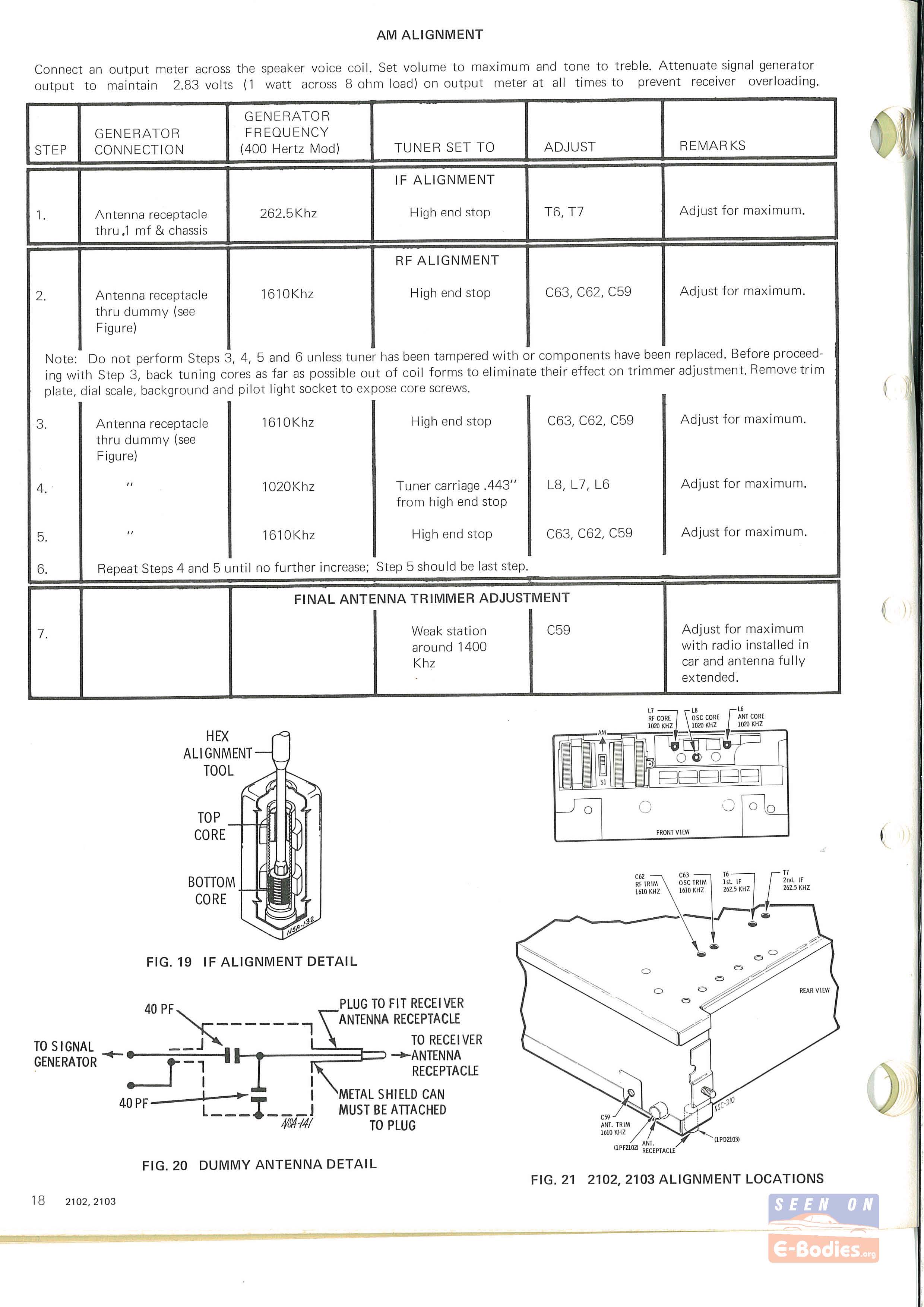

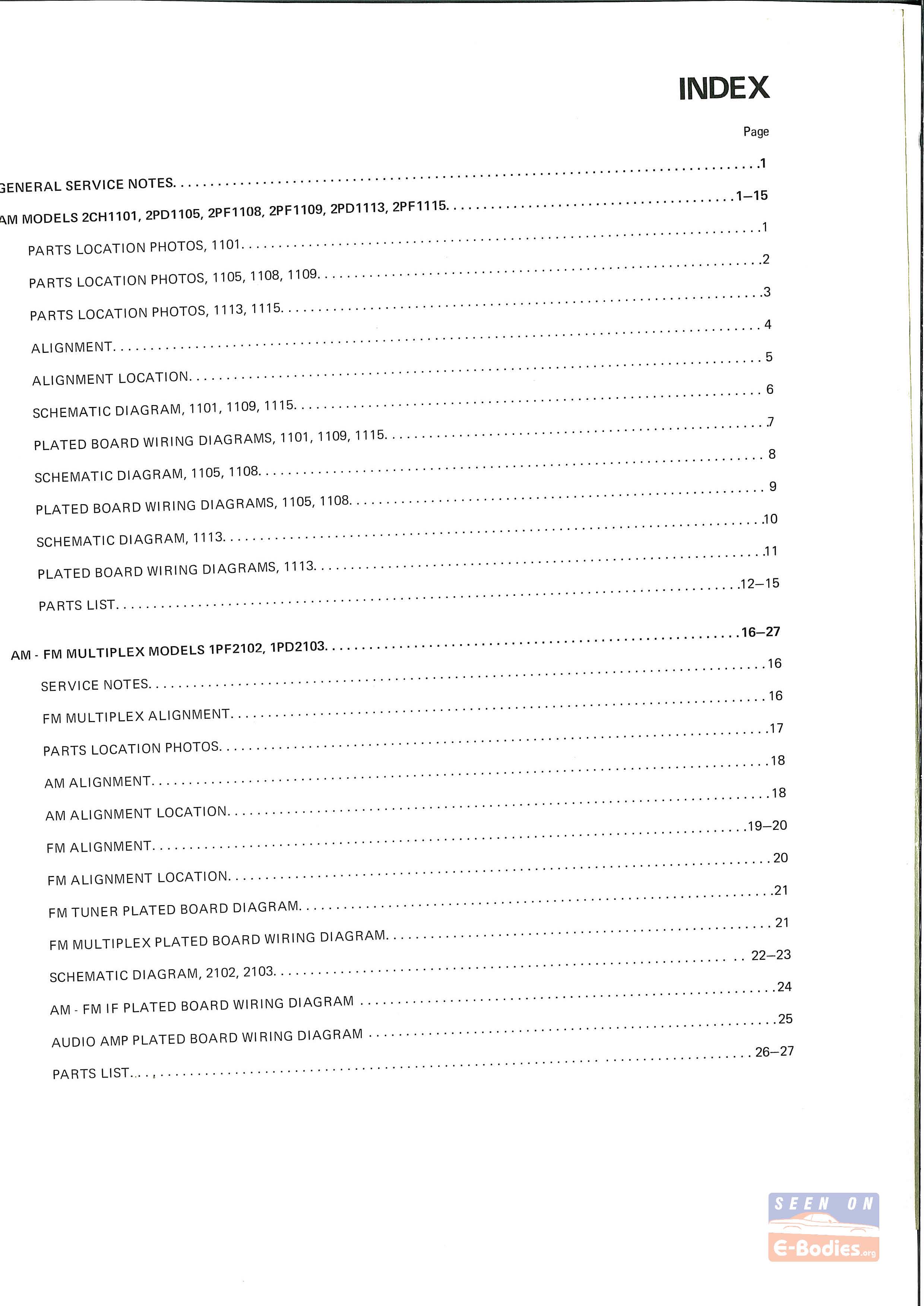

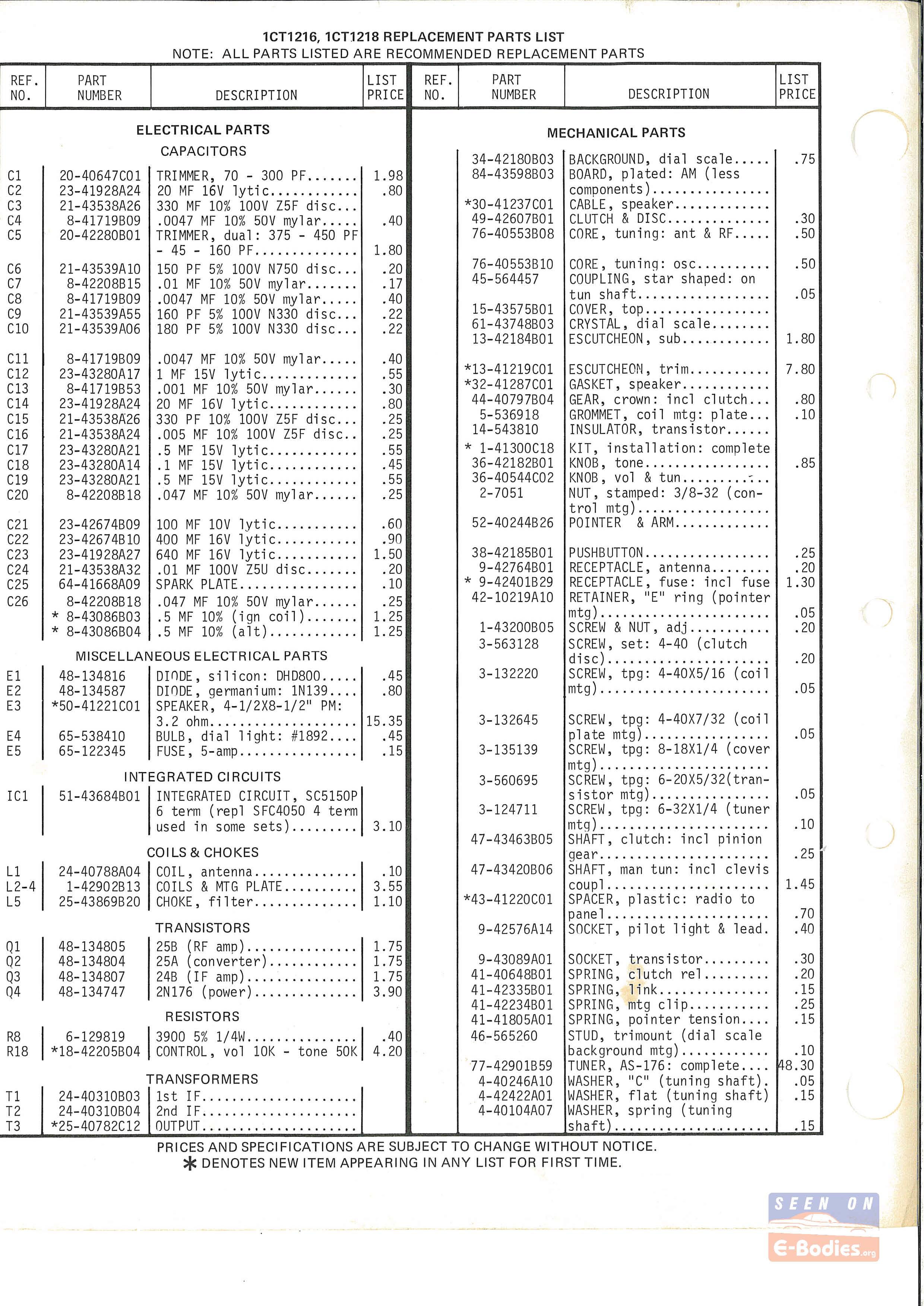

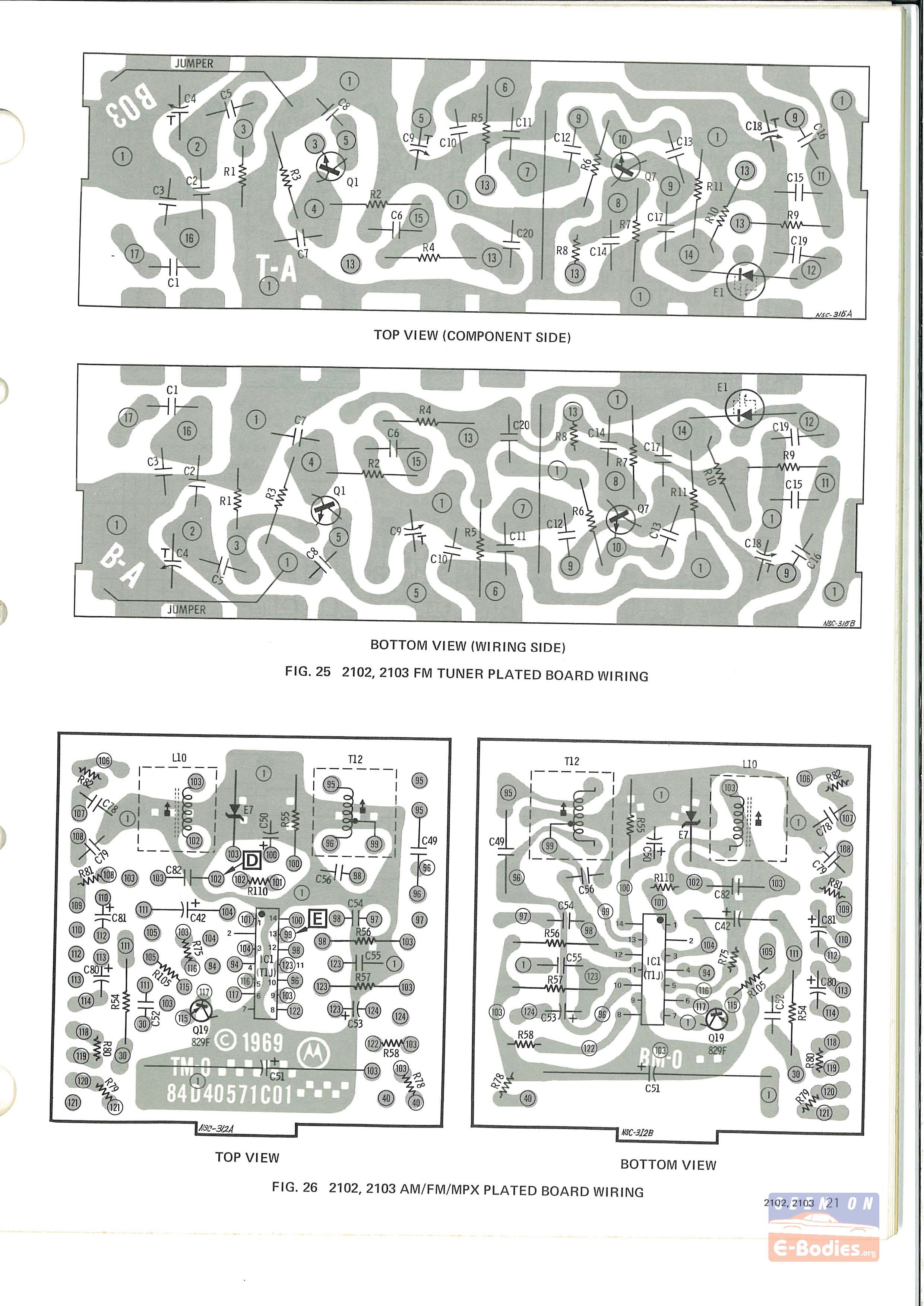

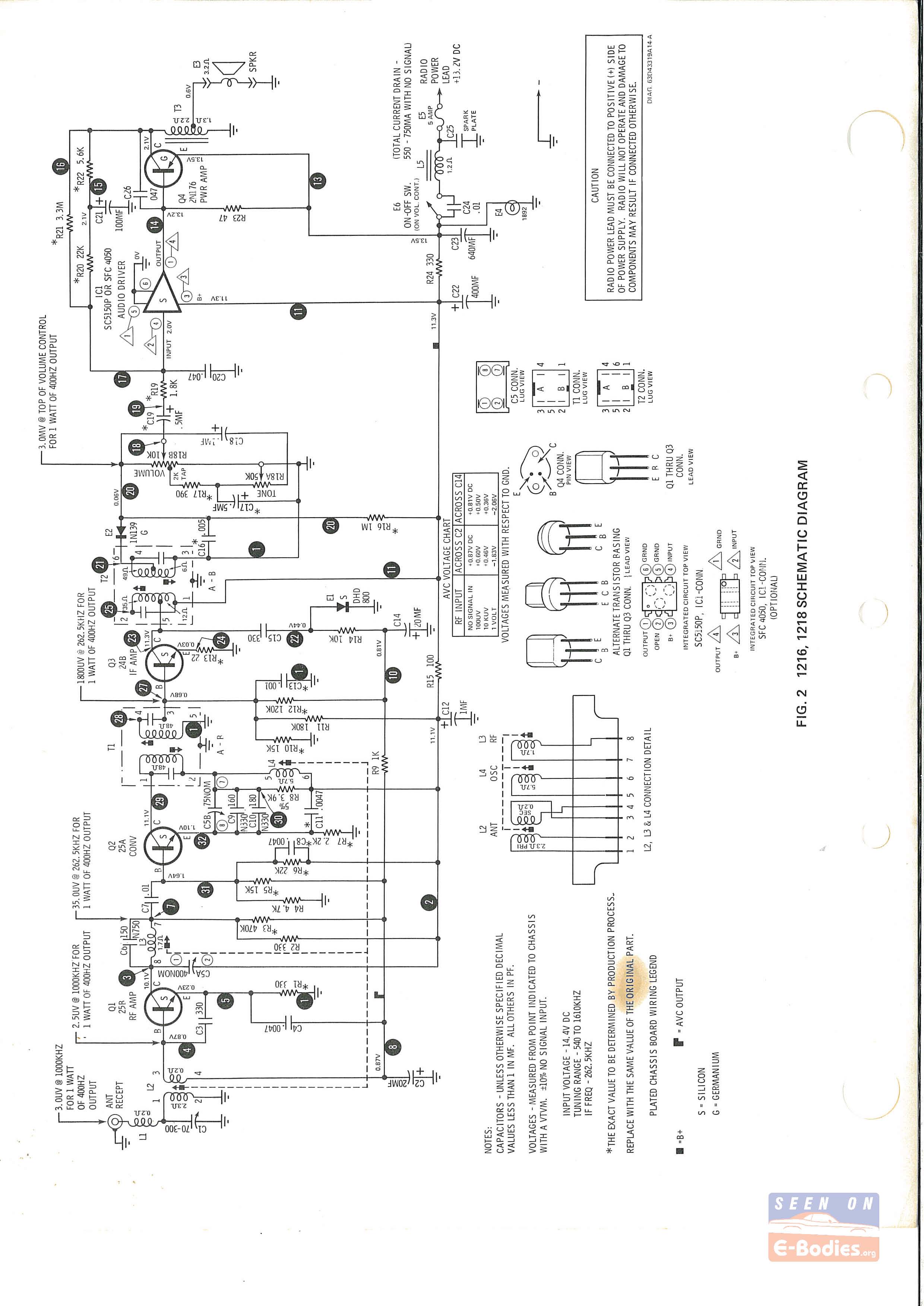

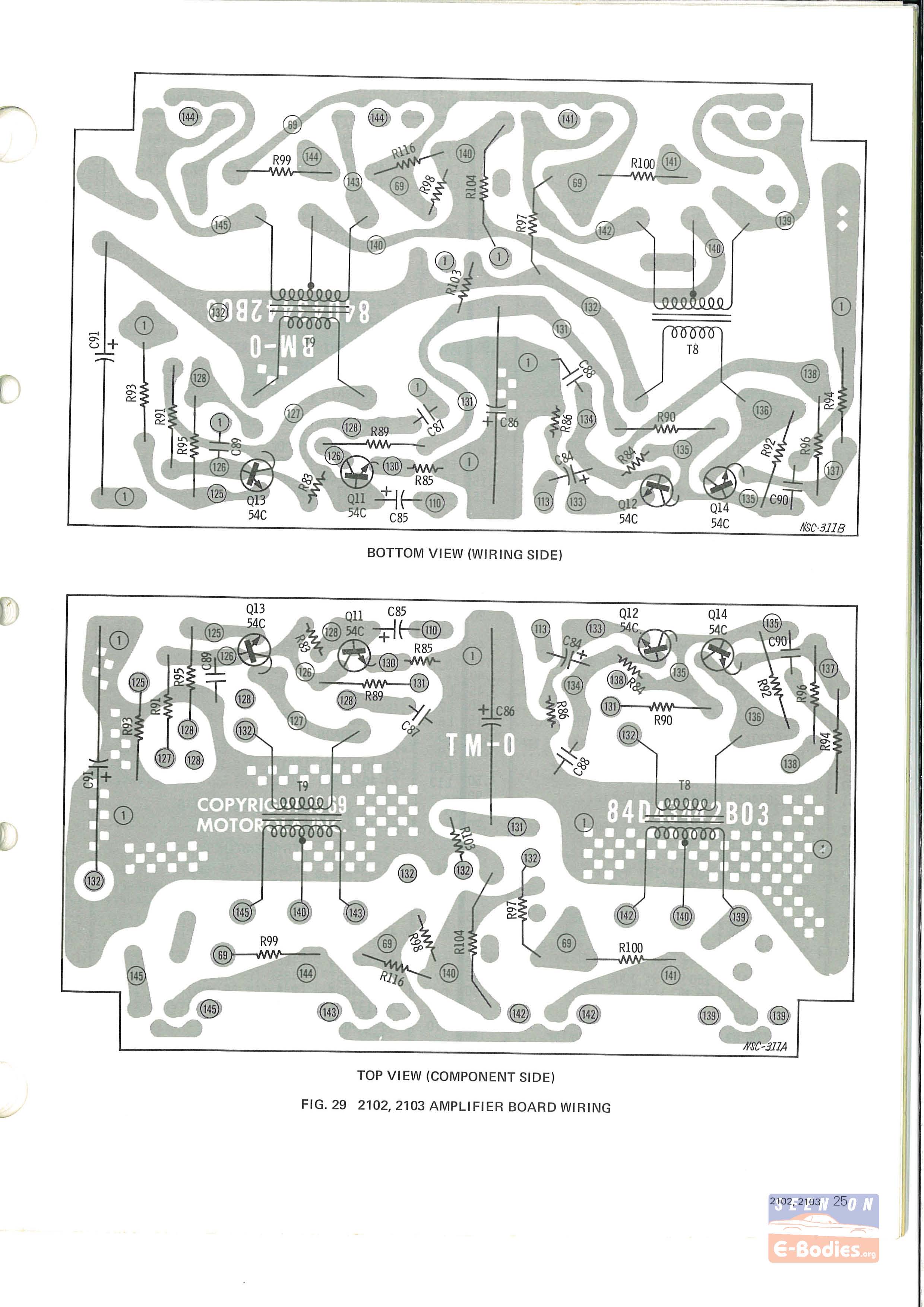

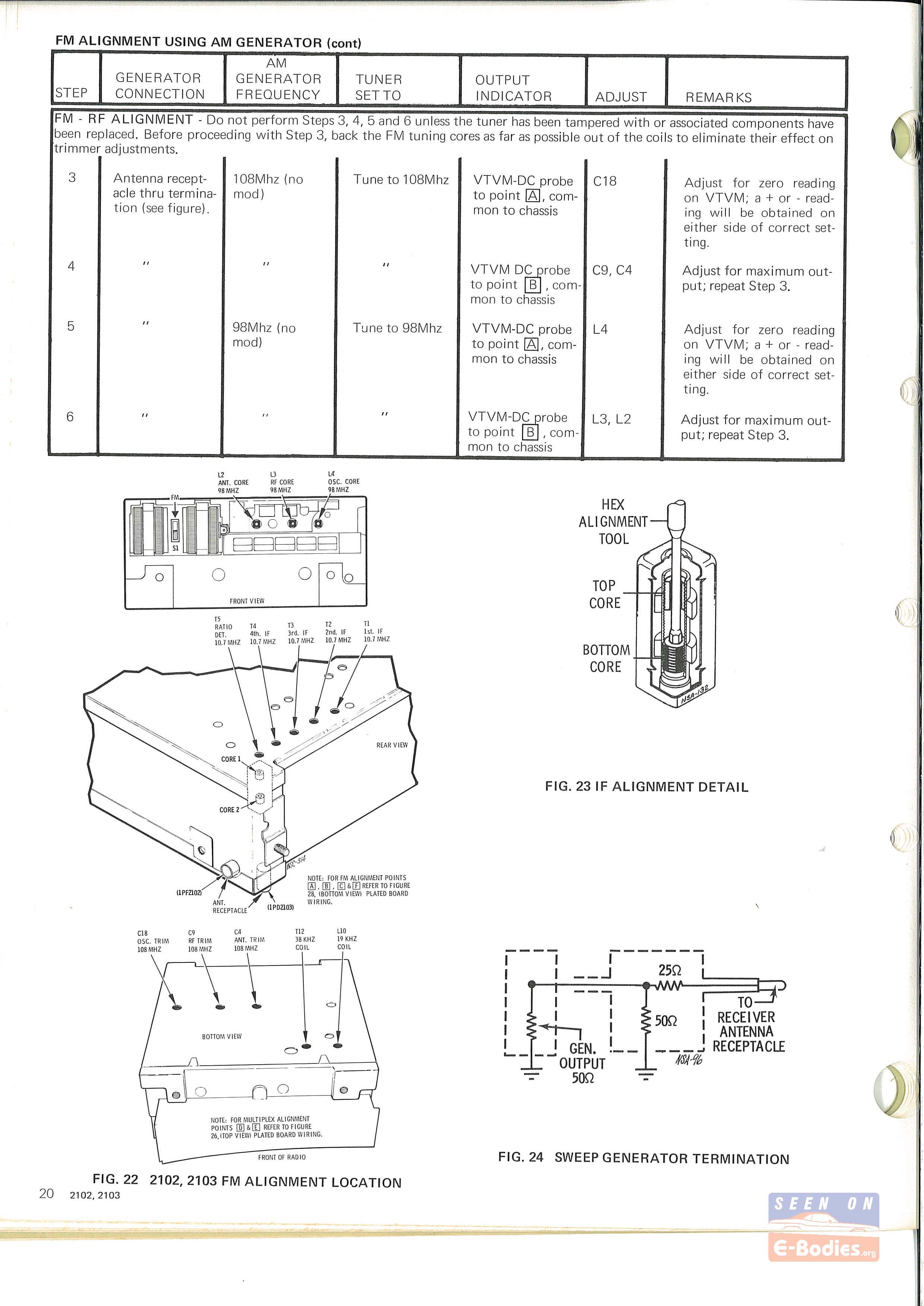

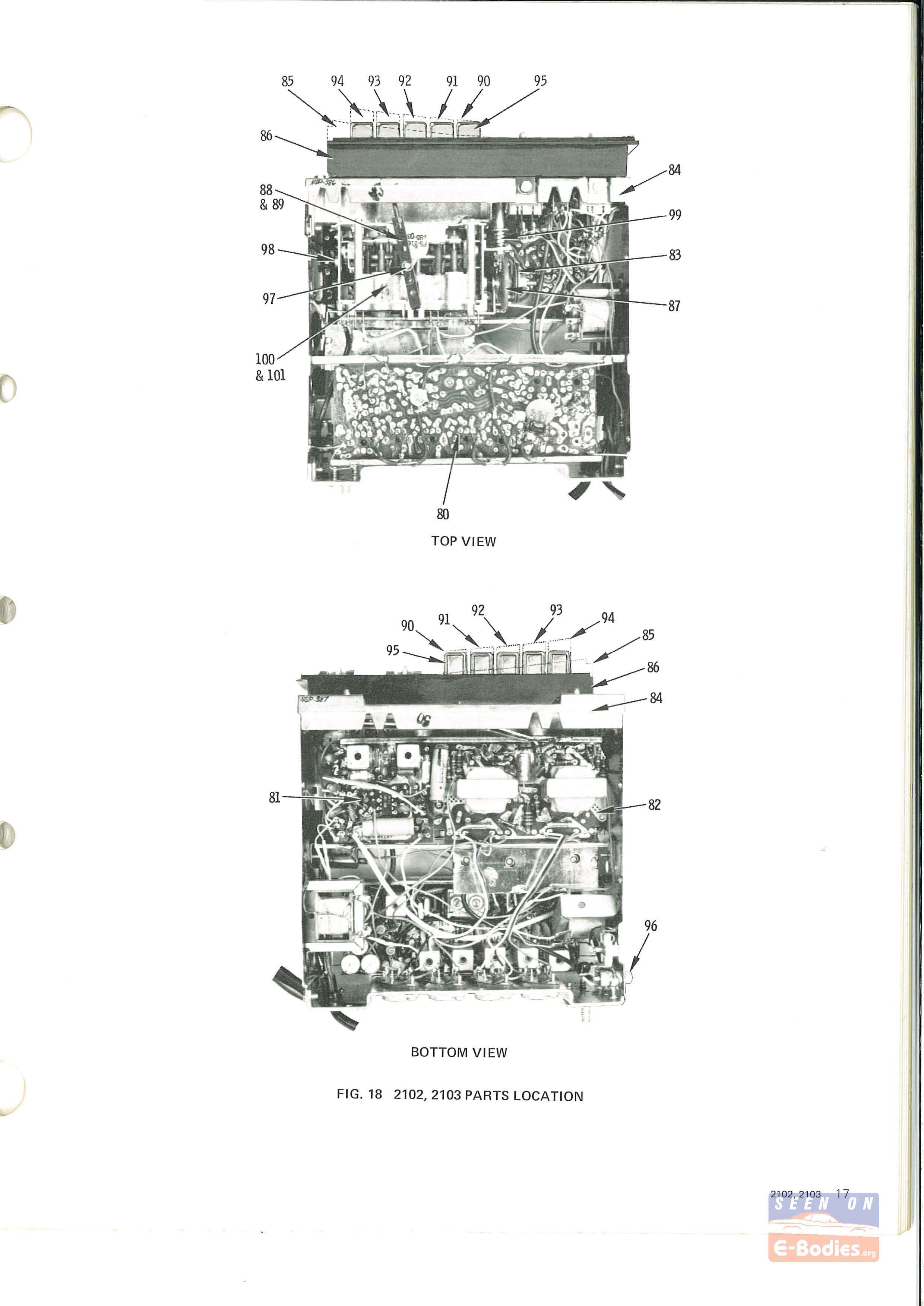

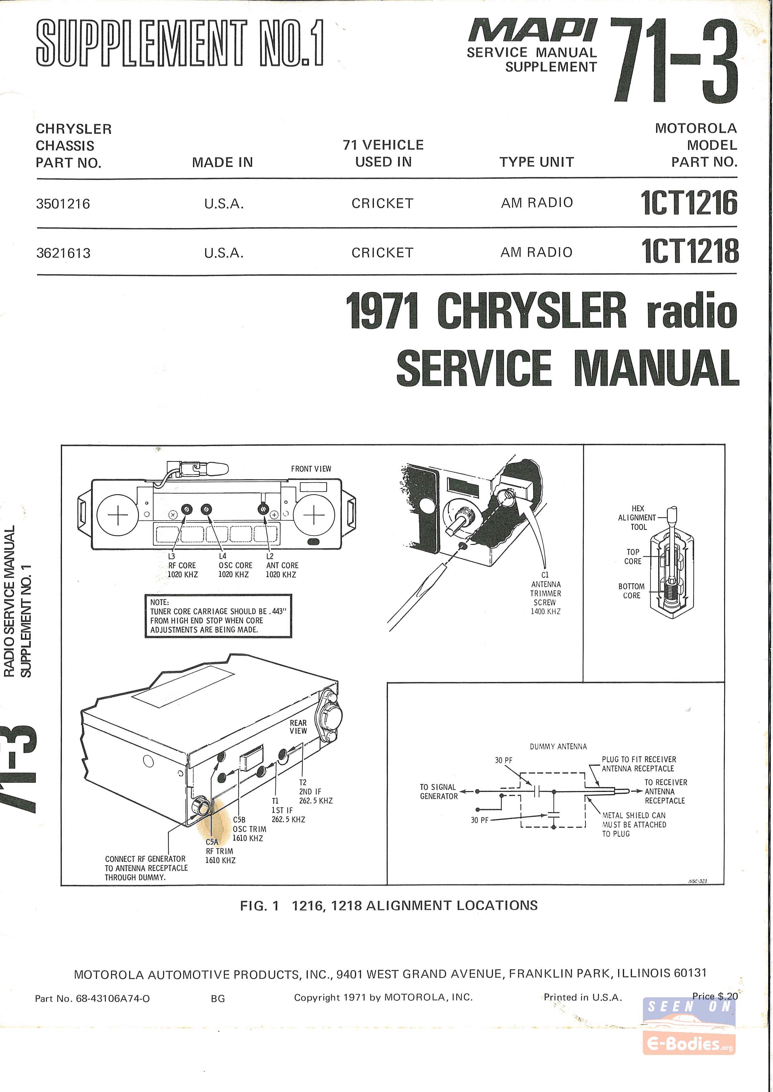

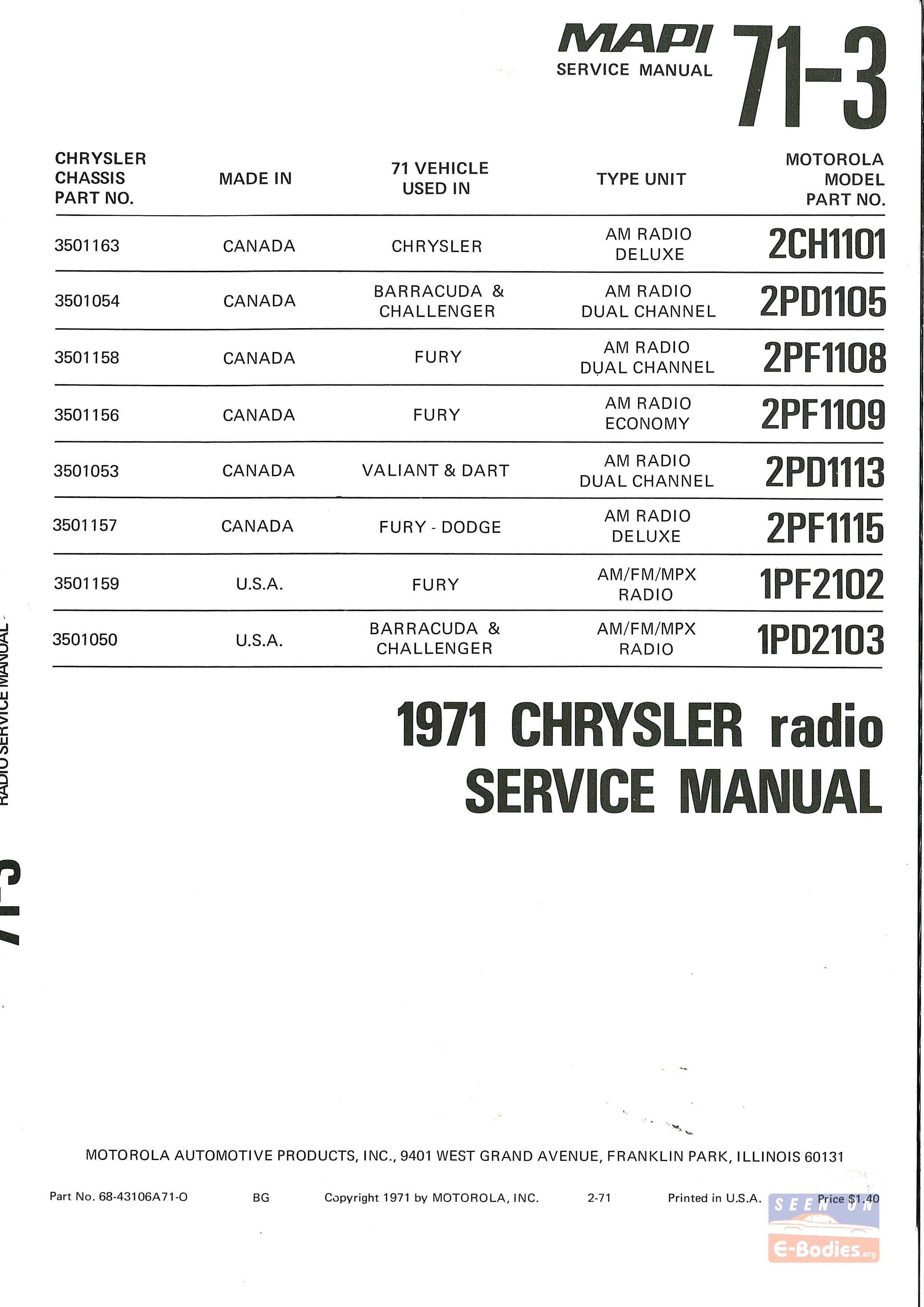

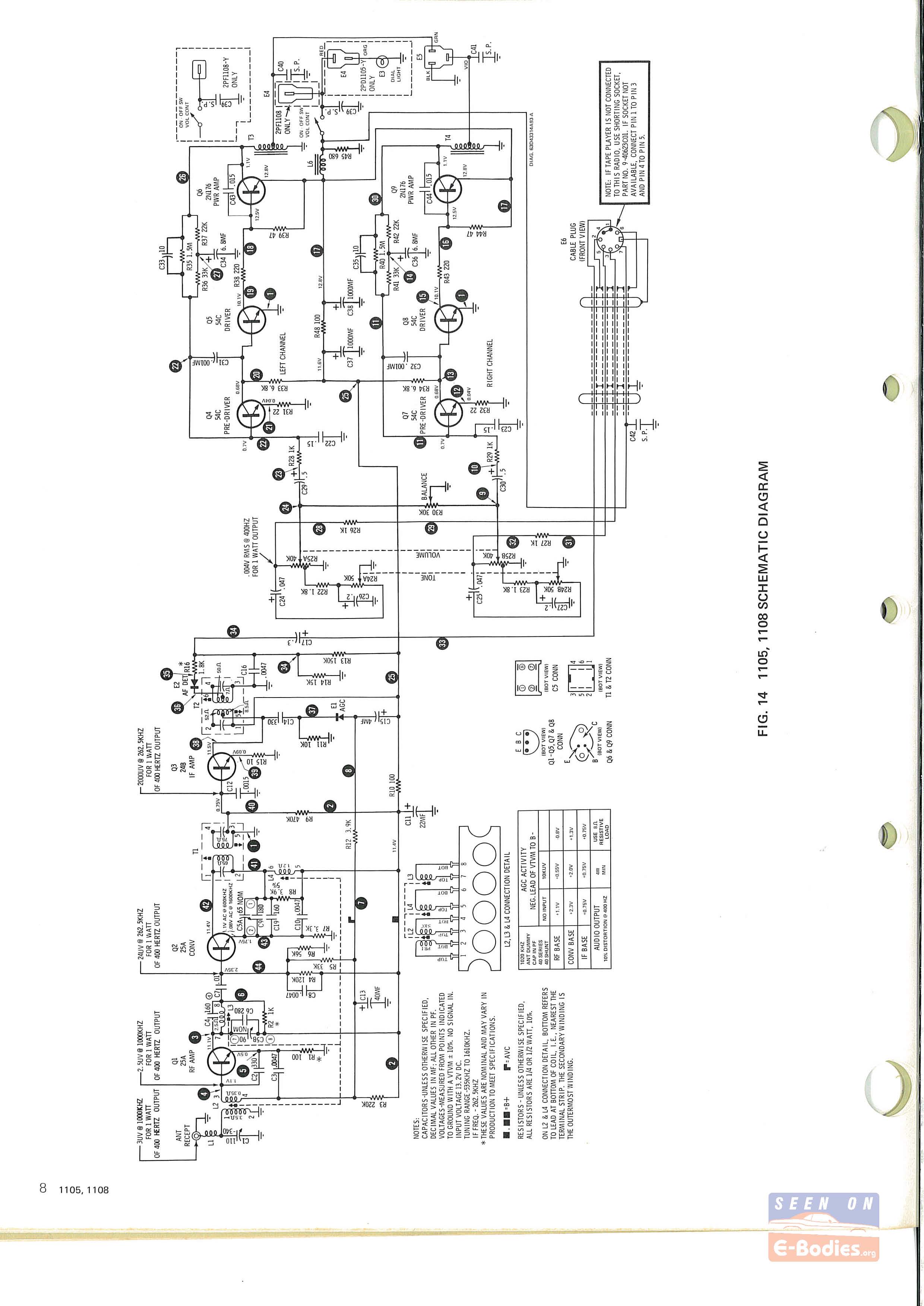

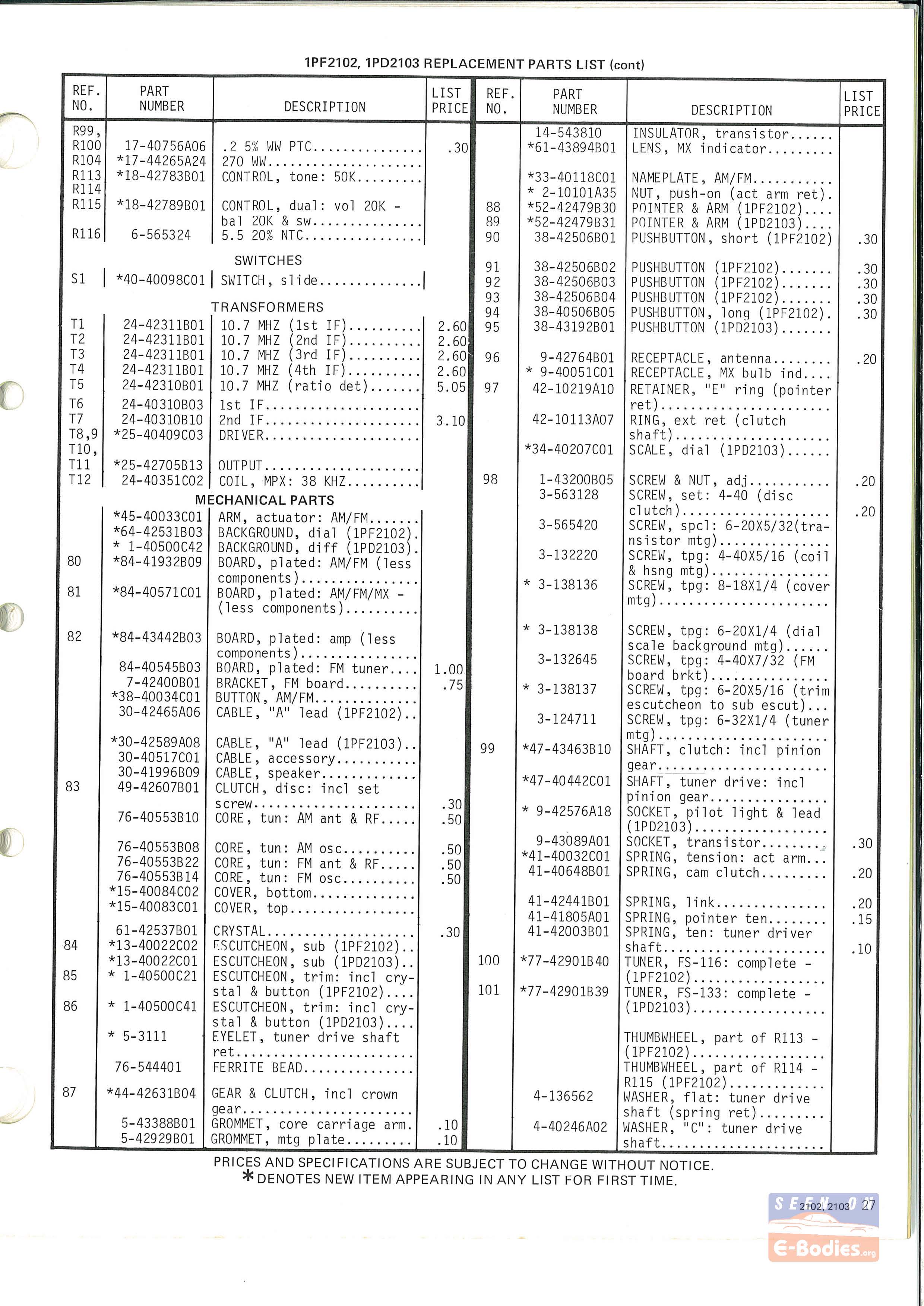

The 1971 Motorola service manual info from Motorola Automotive Products, Inc. (MAPI).
1-10 of 32 total pages.
You might consider buying the new reproduction AM/FM radio versus attempting to fix the original.

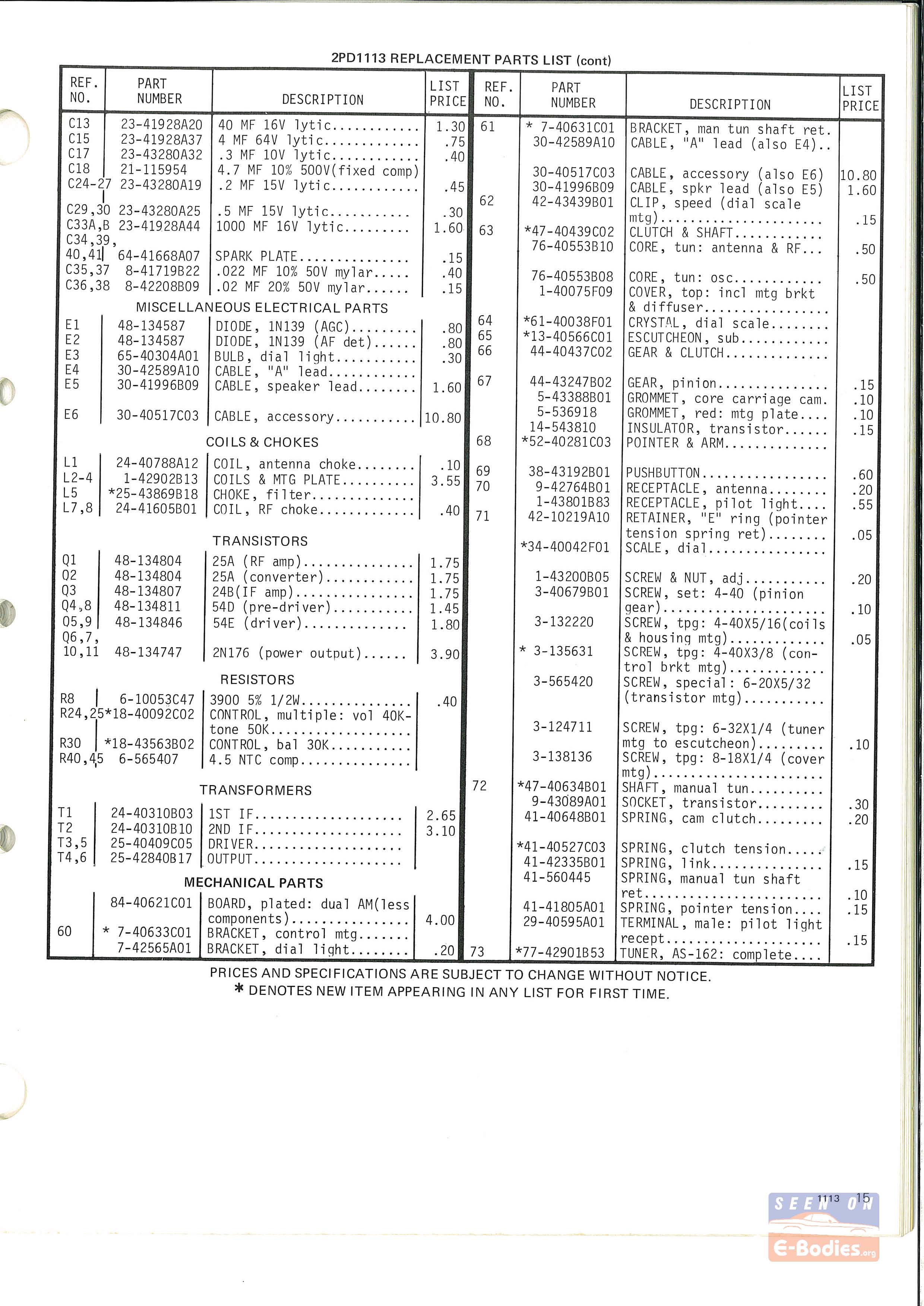

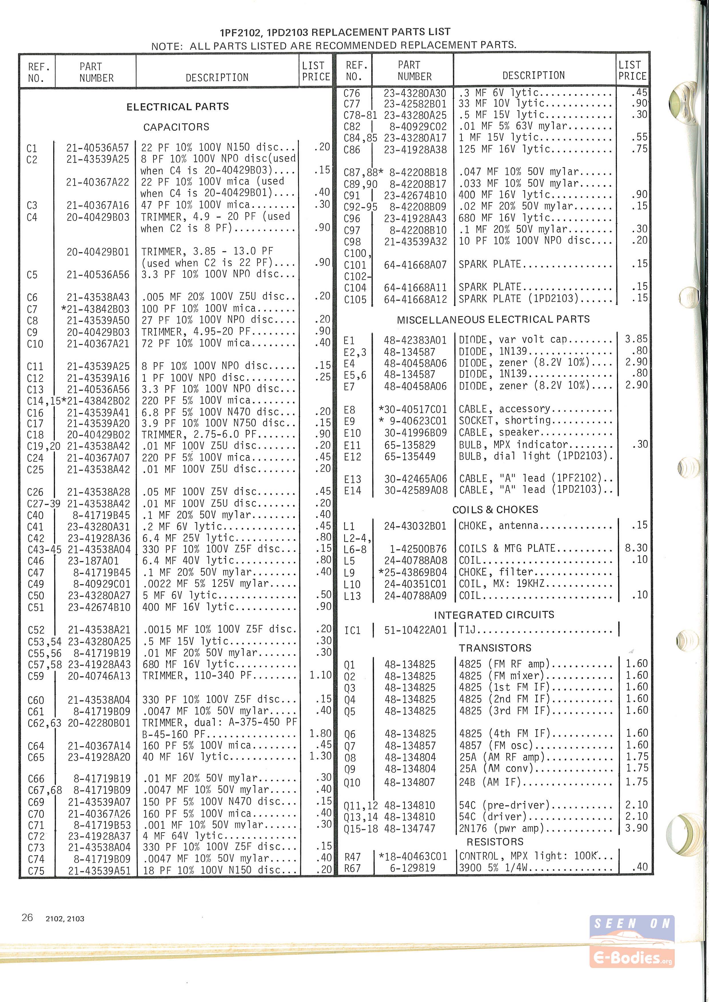

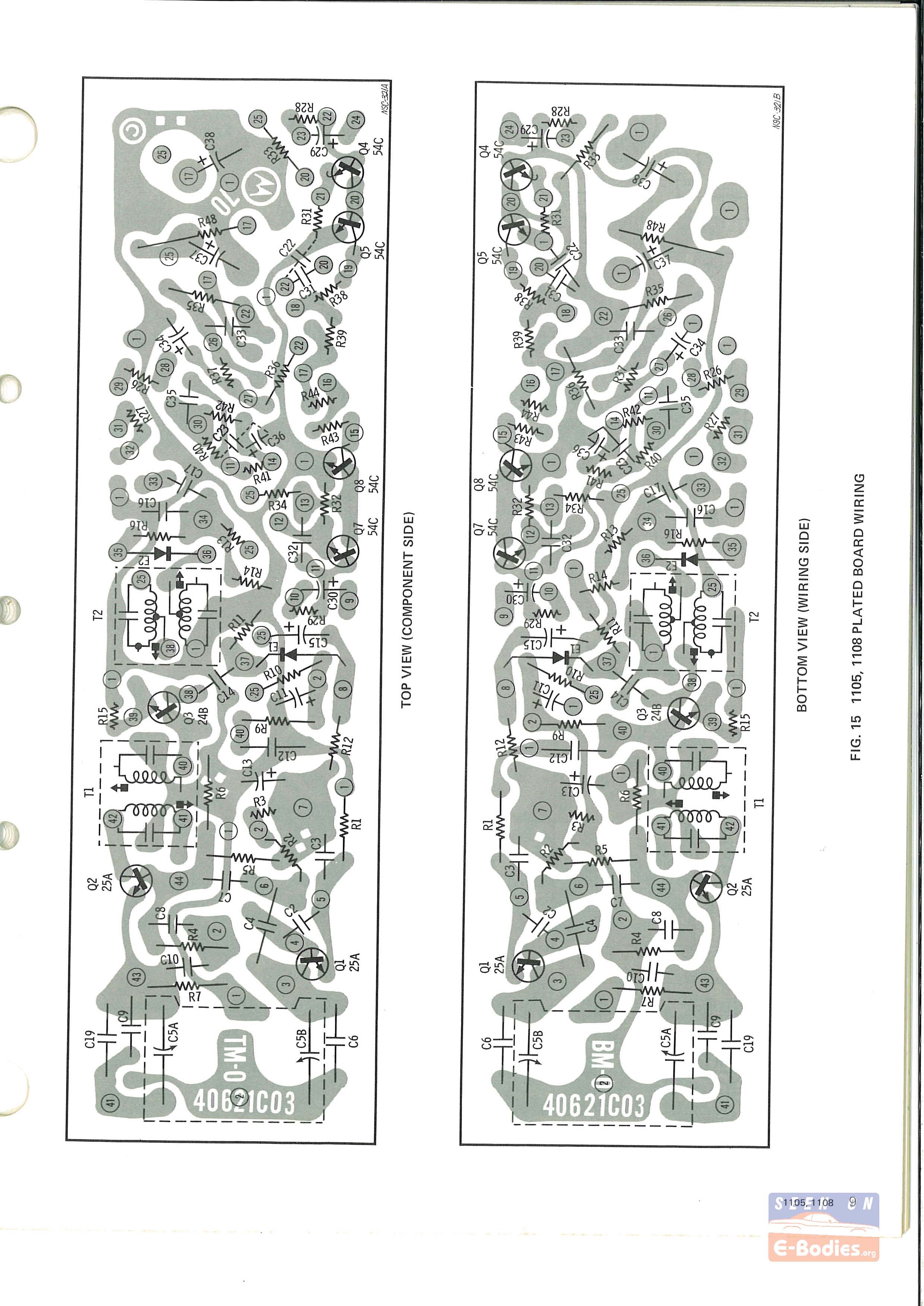

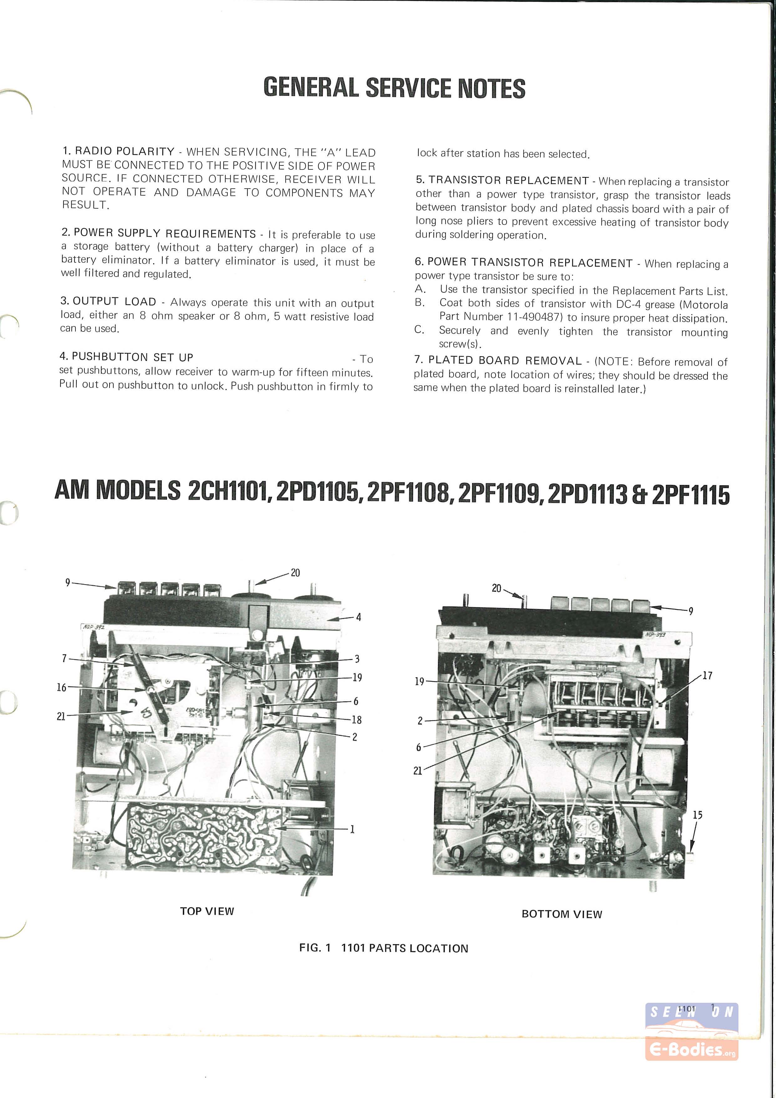

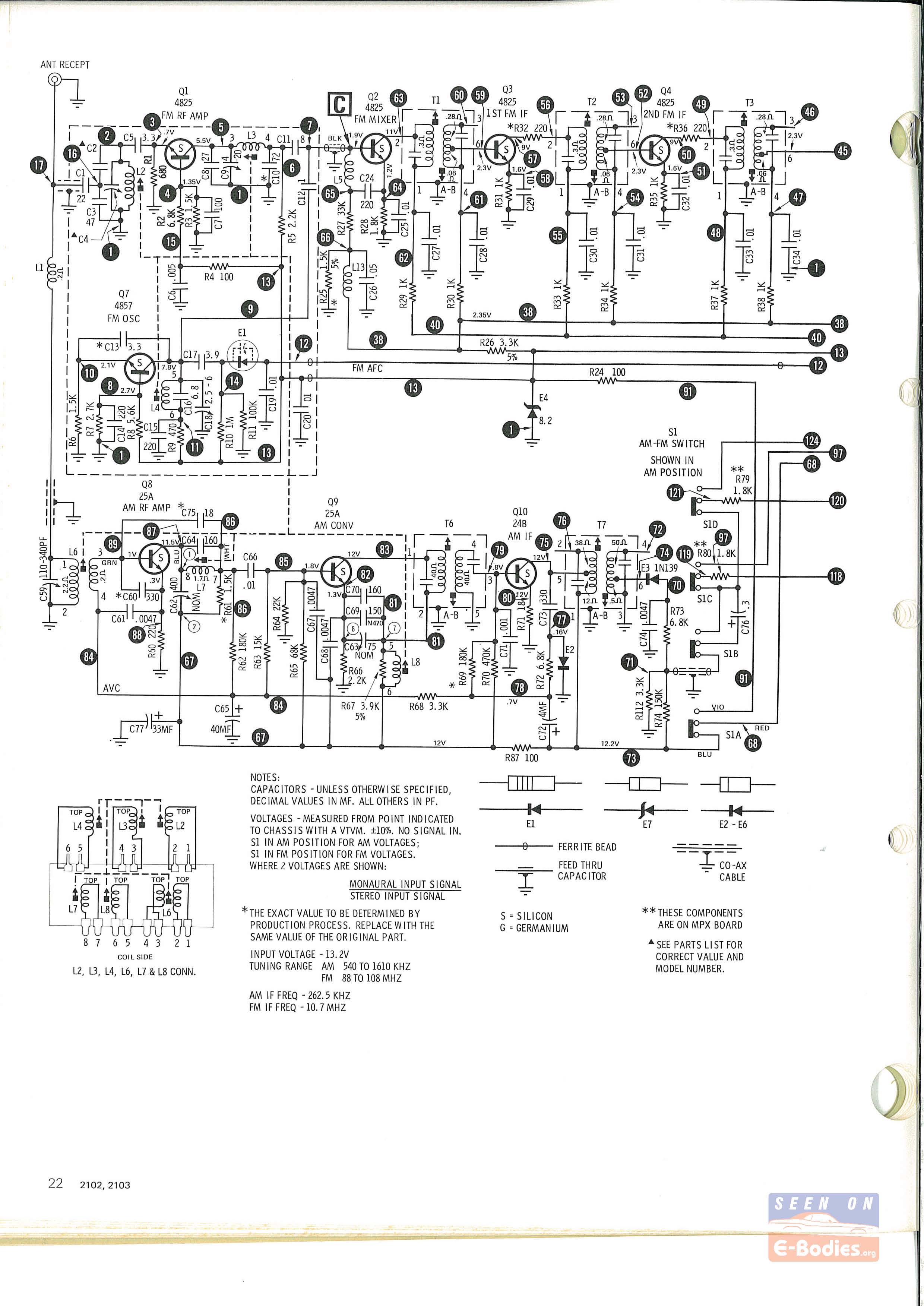

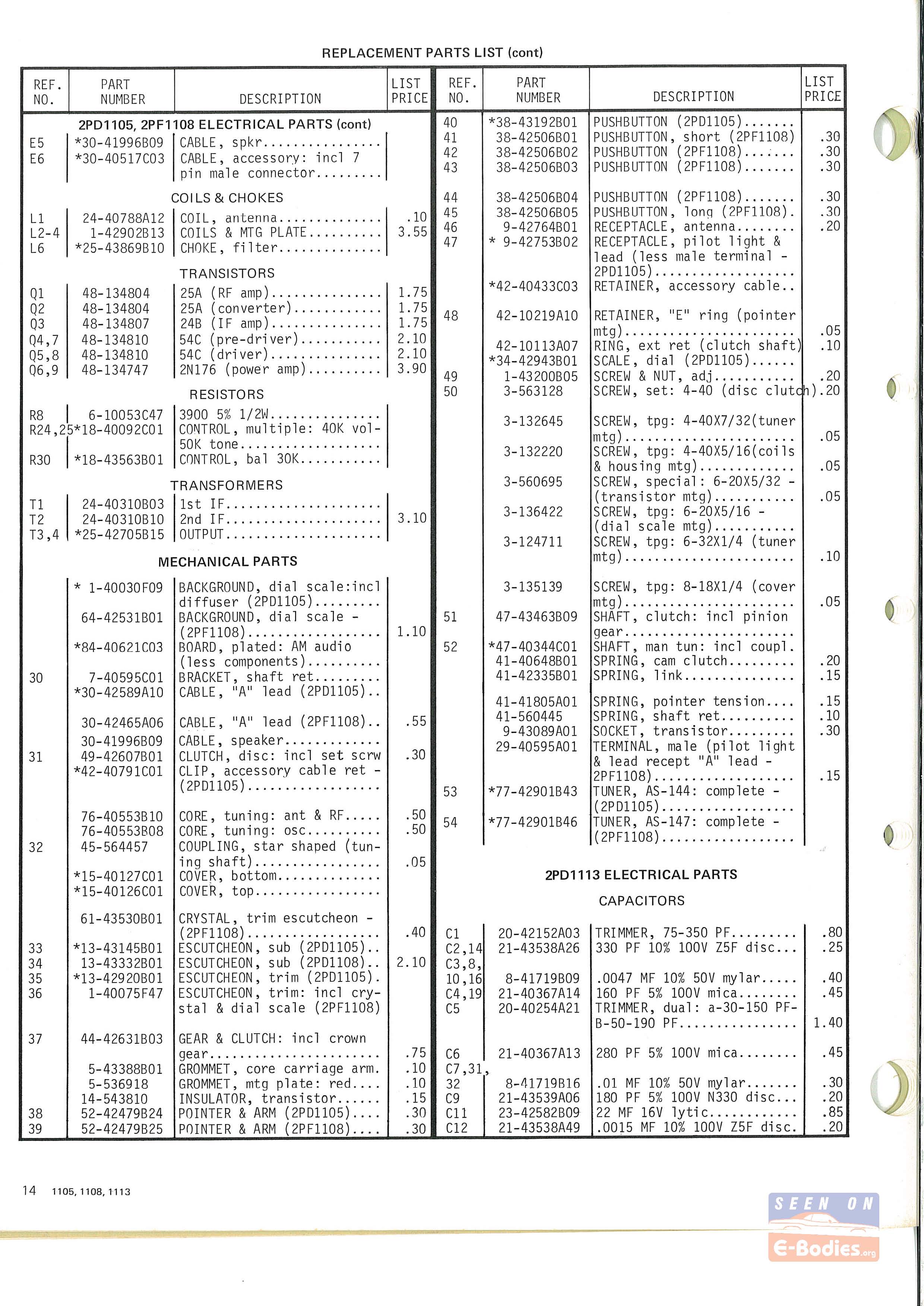

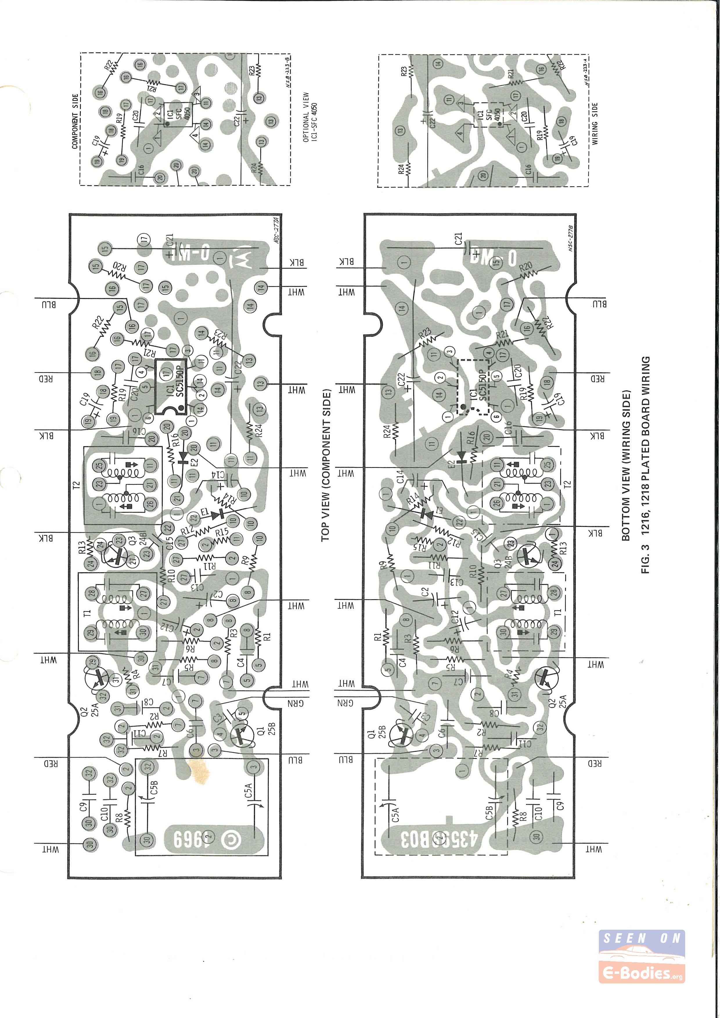

11-20 of 32 total pages.

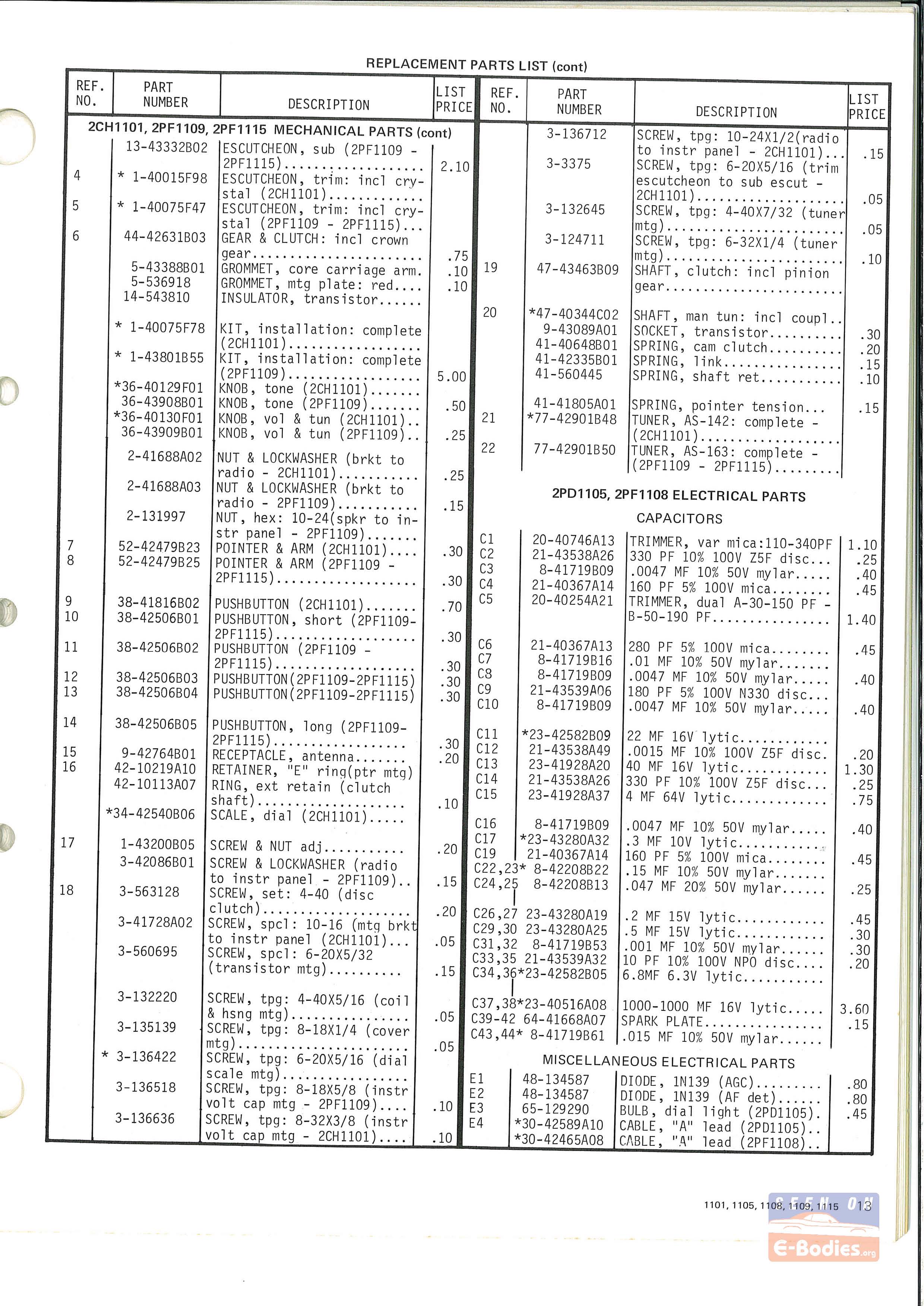

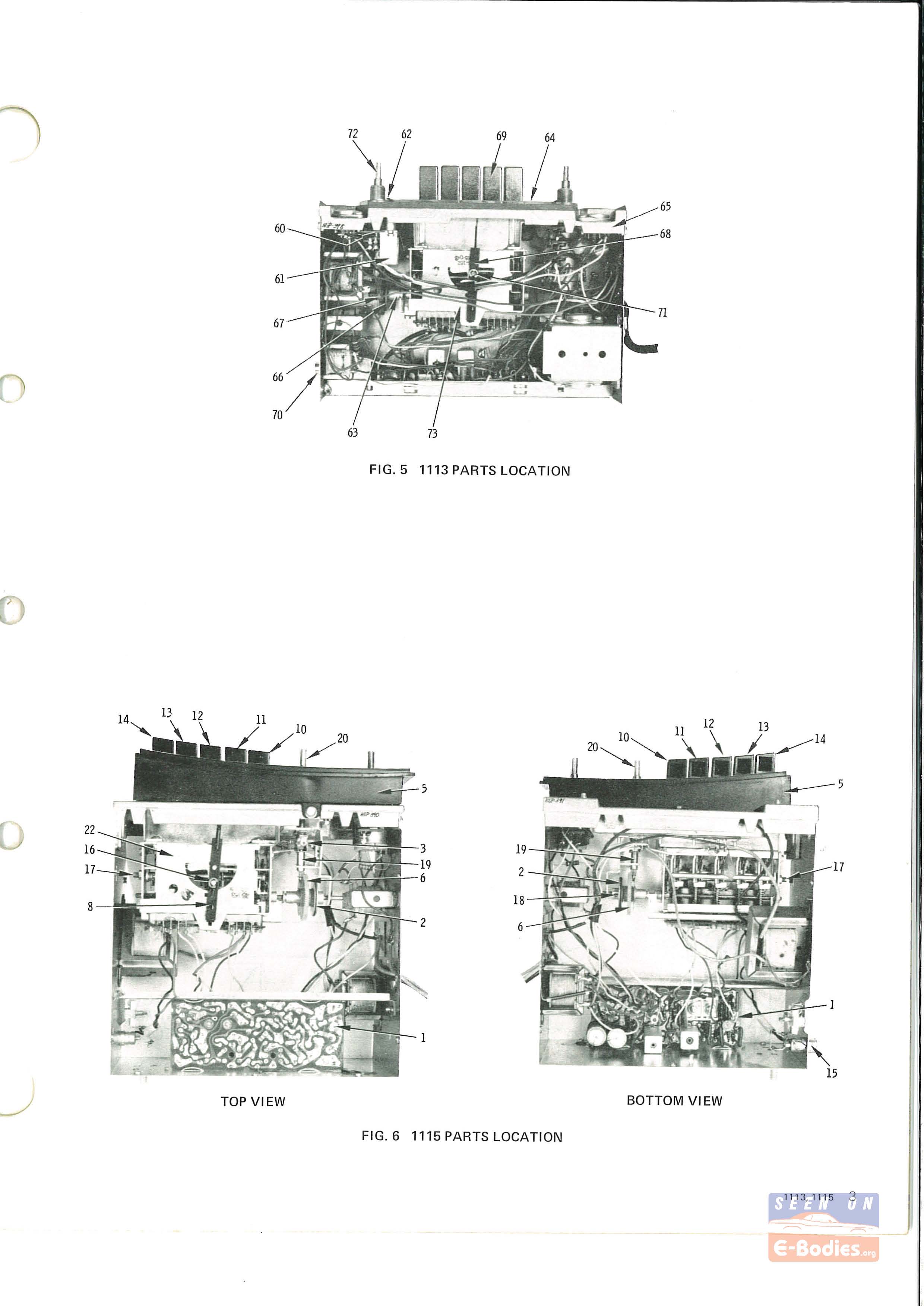

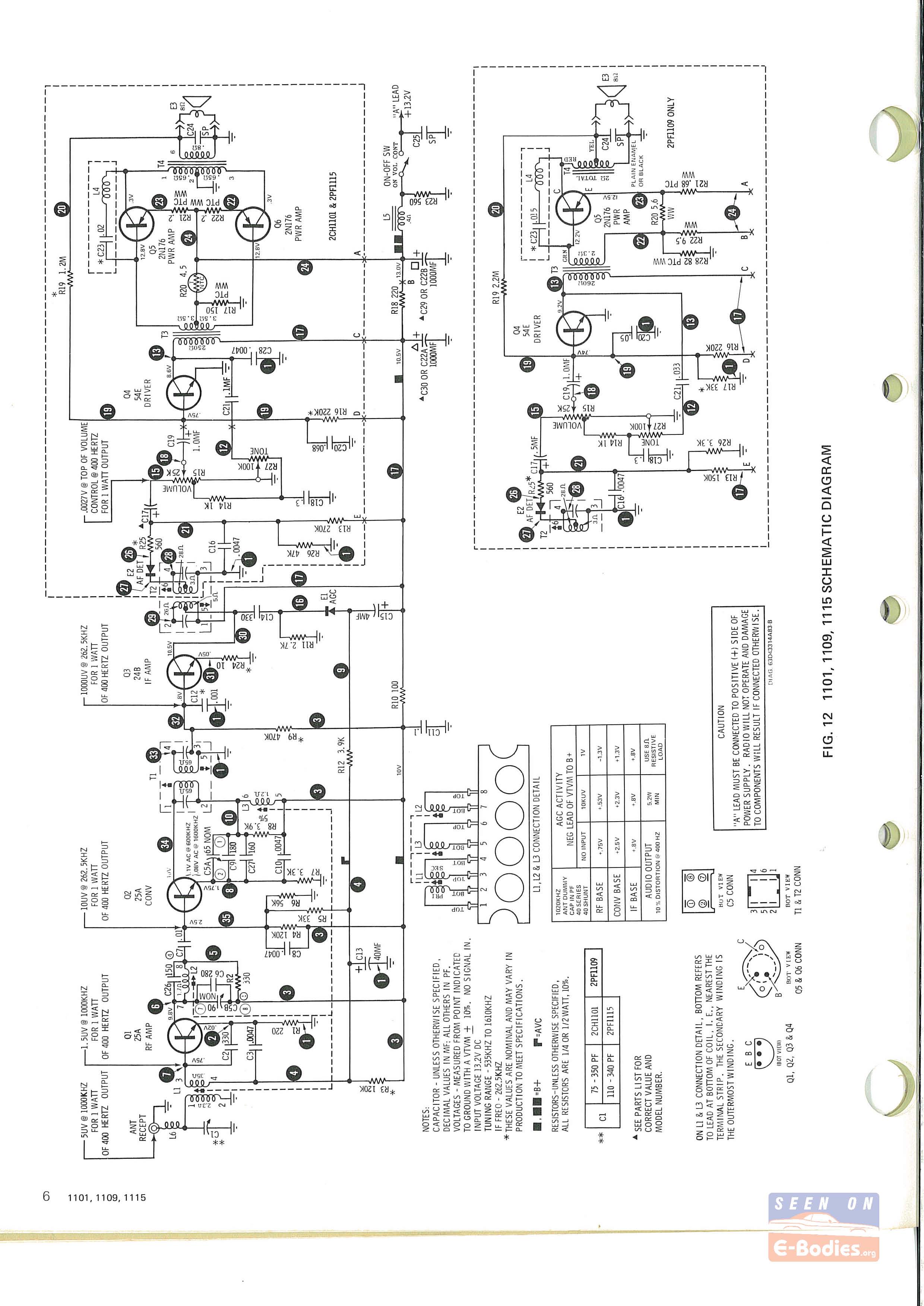

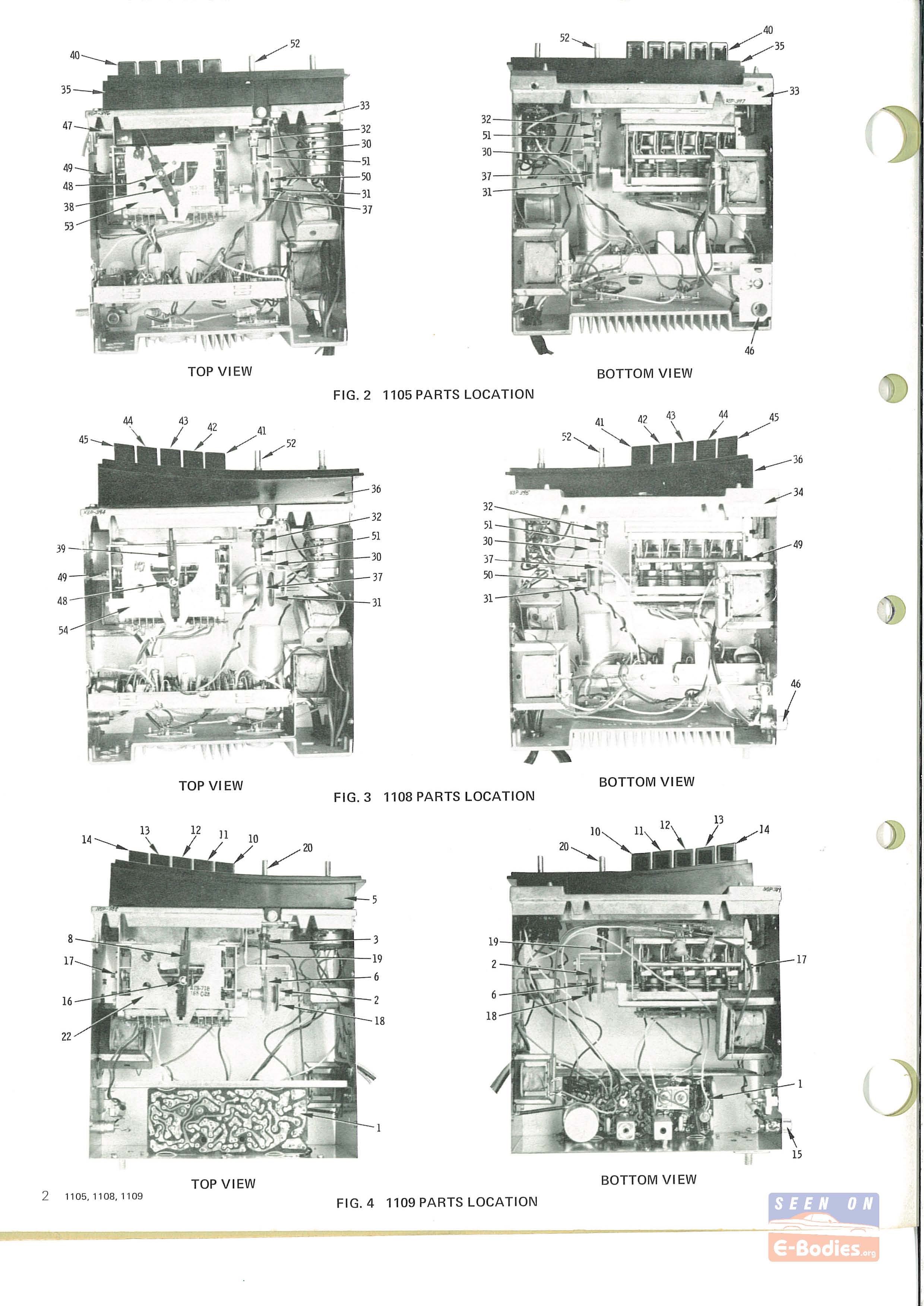

21-30 of 32 total pages.

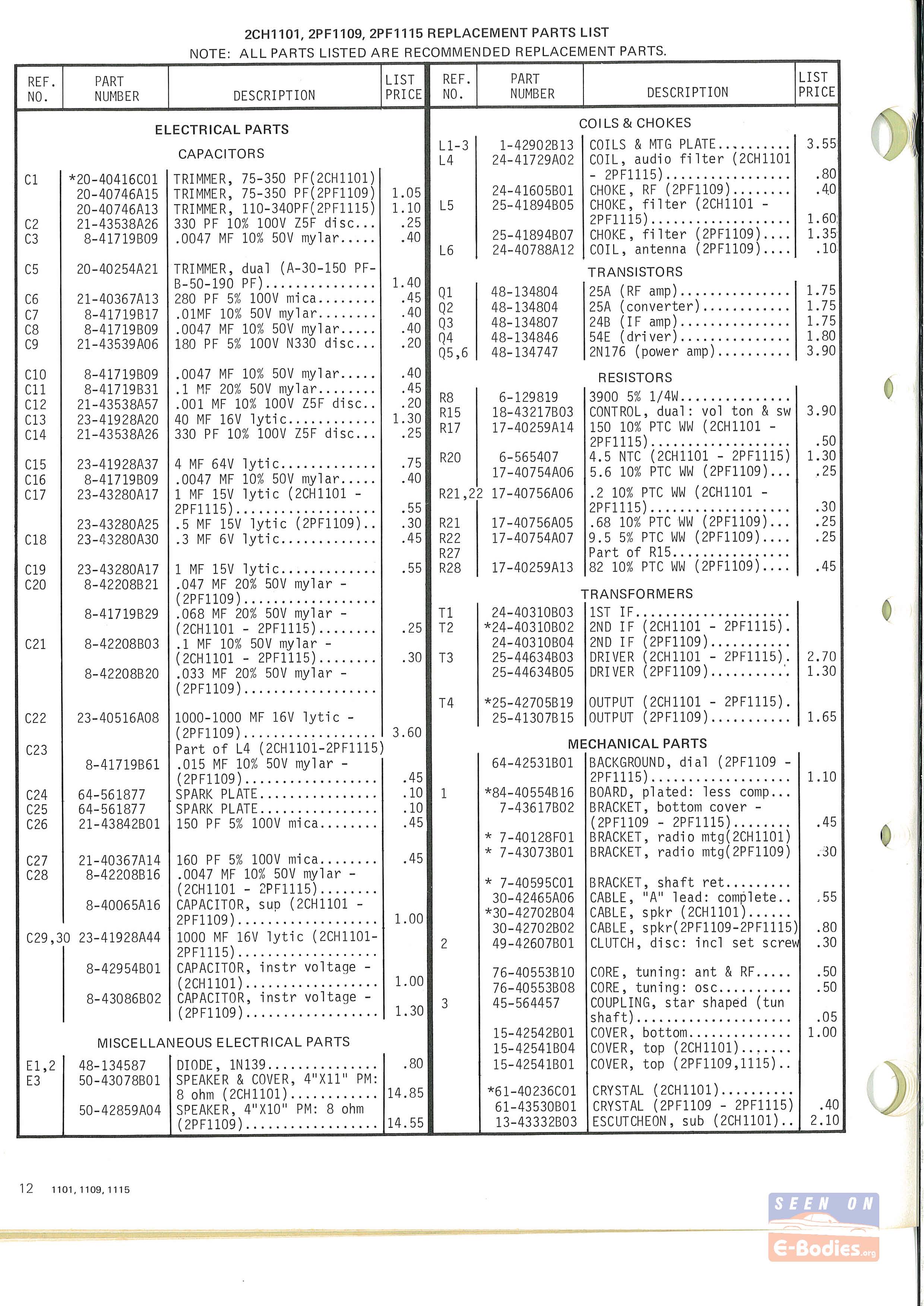

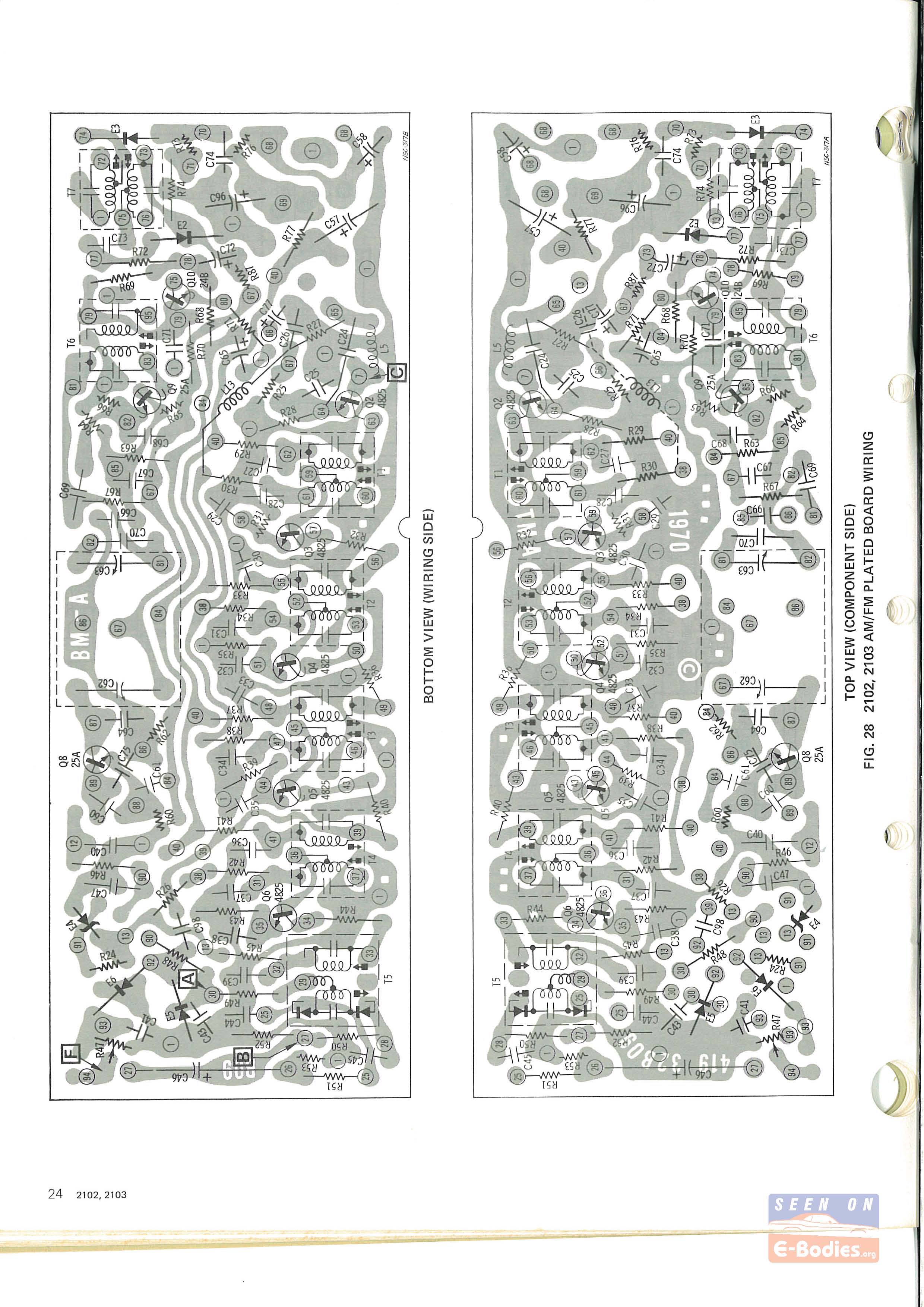

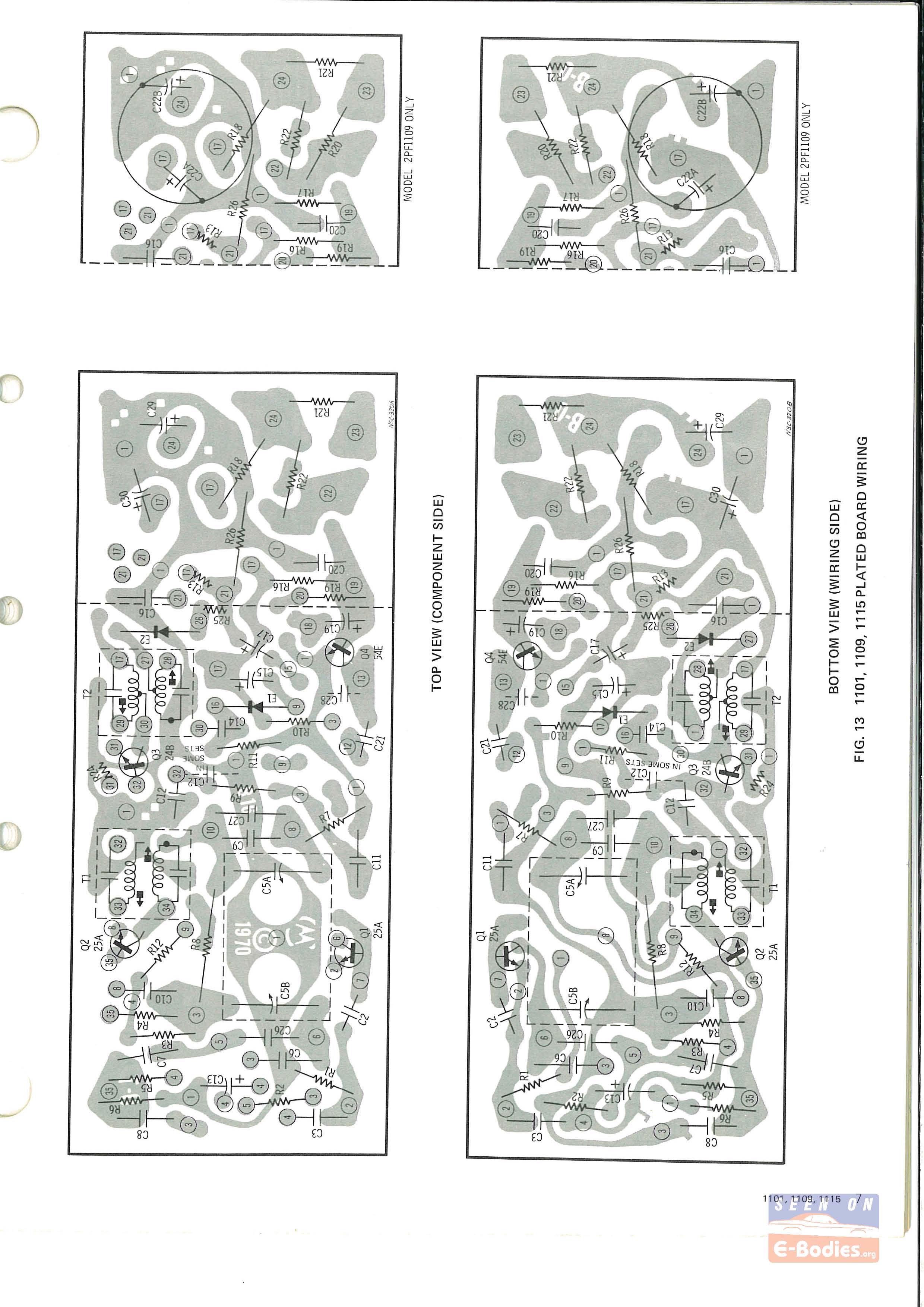

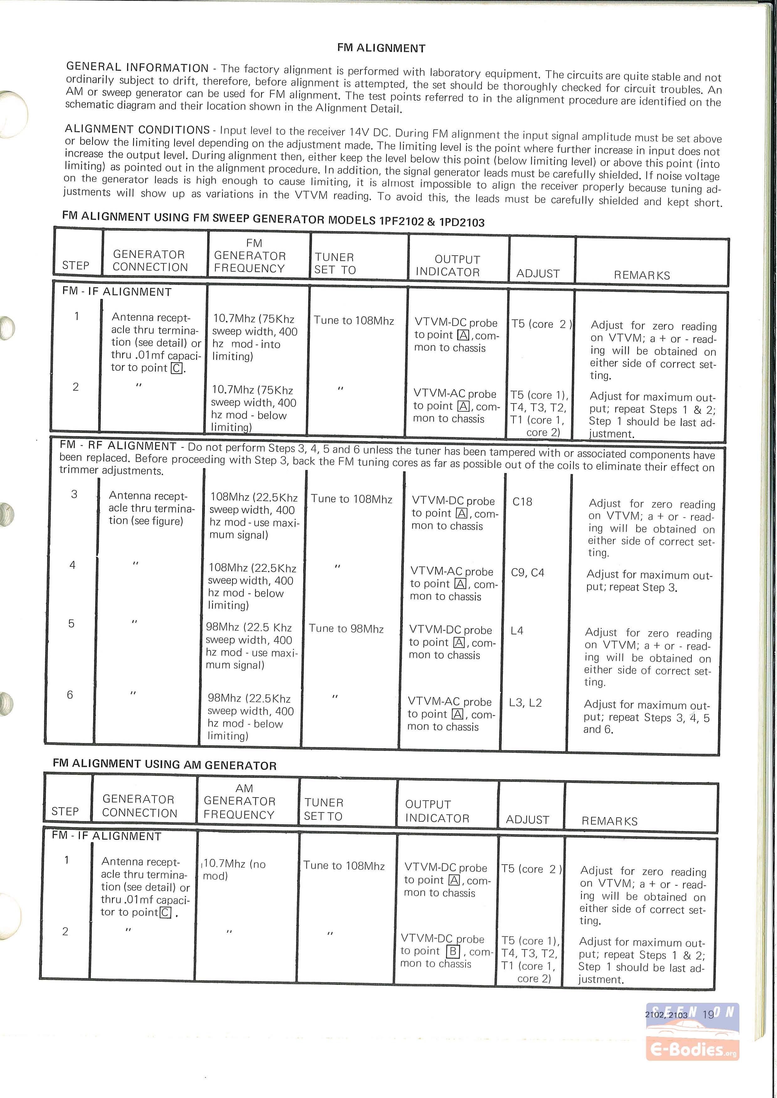

31 & 31 of 32 total pages.
I hope you have the Motorola and not the Philips since these are for Motorola only.
