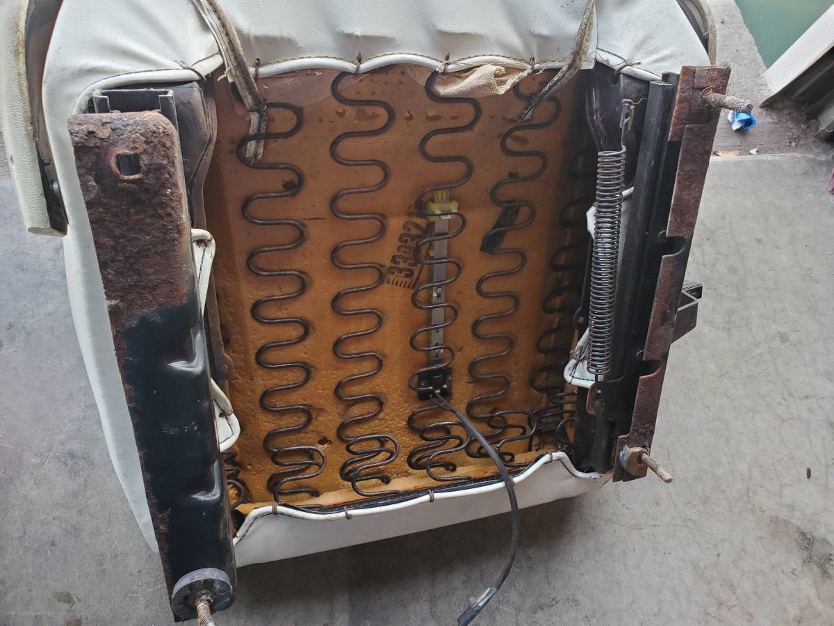

Seat belt warning light has a wire that follows the hump to underside of seat with a connector below the seat.
Used to have a photo of it - if I find it I will send.
Ralph
Mar 5, 2013
350
71
Sorry could not find it but this photo shows the connection to the seat !

I believe the seat switch is the same one that is used in 73 and 74 for the dash seat belt light.
