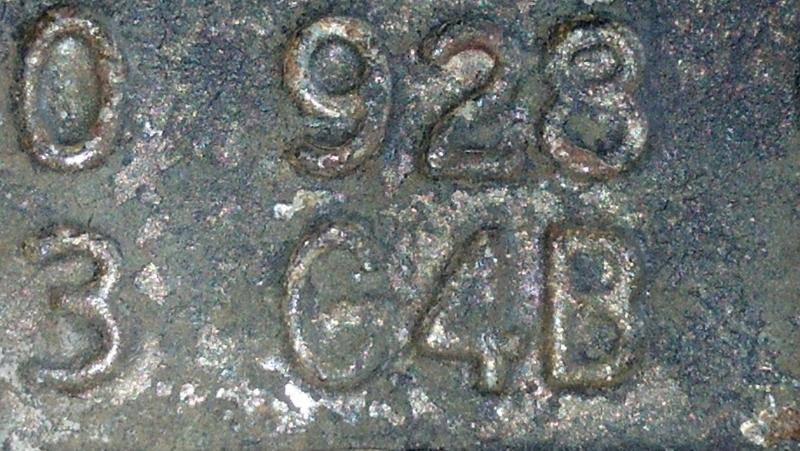

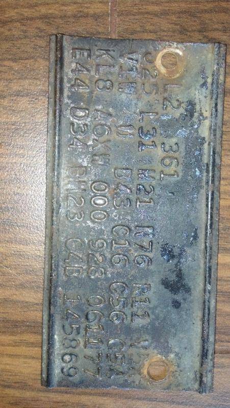

No, that's the amazing thing, the fender tag is in excellent shape. The numbers are clear and crisp. I'll post a pic of it. The car was titled as a 73, but it's definitely a 74.

I posted pics but they need to be moderator approved first. the tag is not rusty at all, very easy to read.

It was built in September of '73. They started production of the '74s in as early as August of '73. Now lets see the car!

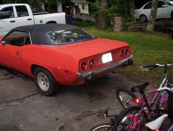

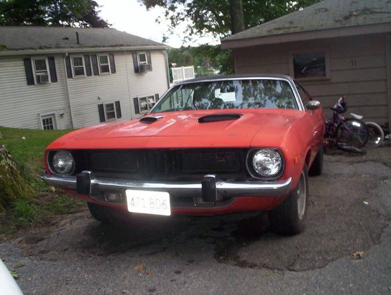

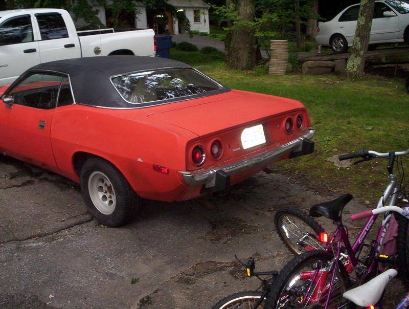

But then why does the production date on the fender tag decode to september 28 1974? I don't have any pictures of the car as it is now, which is 80% done, but here's one on the 100_6633.jpg100_6634.jpgday I drove it home four years ago.
It doesn't, it decodes as September 28 1973. They made '74s beguining in August of '73 and finished in July of '74.
panhead
Jul 10, 2014
8
Ahhhh, so the date on the fender tag is the model year, not the production date! I see. Had the mfgr. date been readable on the door sticker it would have said 9/73. I used the fender tag decoder at mymopar.com and it decoded it as a 9/74 build date, but the one above does it correctly as 9/73. Thanks you very much, because of this confusion I almost ordered the wrong engine harness again (the late 74 one instead of the one prior to 10/73).

The date on the fender tag is the scheduled production date of the car in the actual year the car was built. It is almost 100% sure the car was not built that day. There are different dates seen in different places, including the build sheet and the original window sticker. It is generally accepted that the actual build date is the one appearing on the original window sticker, since many cars have been found with conflicts between the sequence number in the VIN and scheduled build dates (cars supposedly built in May having higher sequence numbers than those with data tags showing a June build, etc.).
