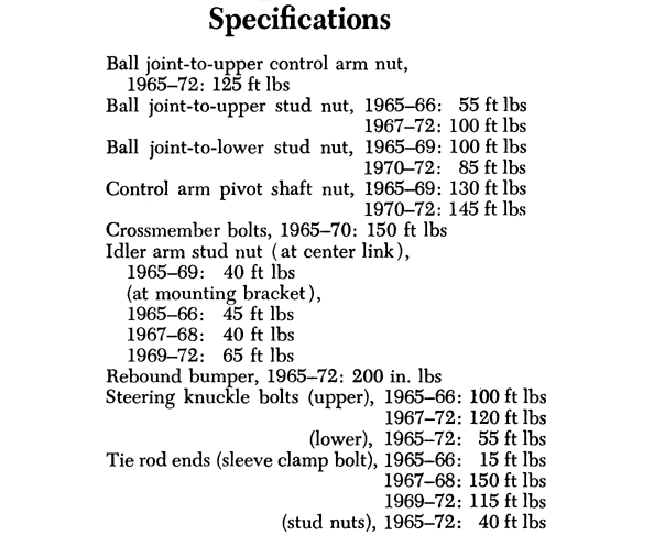

Just a few obvious tips from experience. Have a clean organised work area. Round up all of the tools that will be needed to do the job you are working on. Have a helper and a nearby cell phone..just in case of injury. Lay out your parts, if your FSM is a download, print the pages that apply to your job so they can be handy to refer to. Use common sense as you decide your sequence of reassembly. Bottom up in this case. Ball joints, center link, tie rods, sway bar. Pre assemble the center link, inner and outer tie rods/sleeves. Install as one assembly with you helper.There is more room work when installing each part in that order. If the tie rod assemblies are still put together use the old parts to measure how many turns you will need on each sleeve to get approximately the same spacing. This will get you toe setting close to the original settings. Make sure they are equally adjusted on both right and left tie rods.
