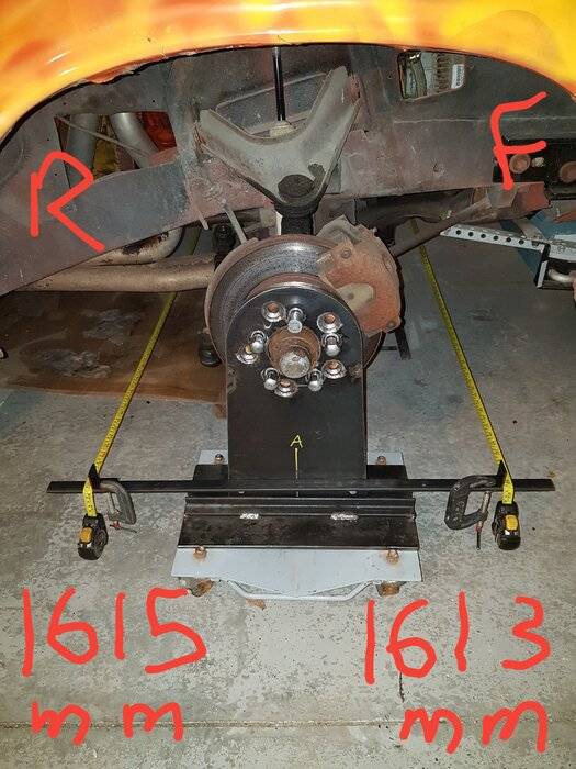

Yes to all All of the above. I took it one step farther and made hub stands, placed on car dollies. Lets me do the whole alignment without the tire in the way. (Ignore my notes in pic)

Hey Dodgeboy, this is the first time I see a setup like this. Looks impressive. Were you happy with the handling on the road afterward ?

It worked on the wifes 09 jeep and on my 07 Ram. Toe in/out just needed alittle tweaking after test drive. When I did it on the challenger I had a complete brain fart and didn't notice that the driverside had positive caster (bent strut bar) and the passenger side had negitive caster. (I was just trying to center my steering wheel). As we speak I am rebuilding my front end with new poly bushings, I've tightened up my LCA's and welded on stiffing plates. I have ordered new strut bars which should have been here on monday but haven't arrived yet. This car has always pulled to one side and after I set toe-in it I developed wicked stearing wheel play at highway (which to me meant my toe-in/out was good but I had other issues, my quick fix was to add 1 full turn on pass.side tie-rod sleeve, messing up my toe-in). This year we are gonna make it right.
Thanks
Finally drove the car yesturday, just around town and it handled ok. No real pulling to one side or wondering. I had to do the alignment twice since the passengerside suspension finally settled after i put the wheels back on. I have my ride height set fairly high so best I could do is 1° caster & 1° camber. This winter I will fix/replace my steering gearbox since i have a lot off steering wheel play and then everything should be good. Soon I'll take it on the highway and then i might need to tweek the toe in/out just a bit.
