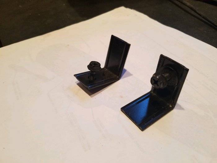

    Hello, I am finishing up the details of installing my shaker hood. I ordered new brackets to support the base plate. I have the two longer brackets that attach under the front of the base plate to the heads. However i got these two smaller L shaped brackets that I cannot figure where they go. Does anyone know if these are needed on a 340? If so, where do they attach? Thank you. shaket brackets.jpg

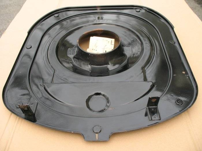

    340 base6.JPG Those are spot welded on the underside of the base plate up front. Assume you have a repro baseplate? Originals had two small dimples for locating.

    Perfect! Thank you. No, it is an original baseplate and there are mounts spot welded to the bottom of the baseplate like shown on the picture you attached. So I'm good to go! I thought they looked the same but I was confused as to why they were included with the longer mounts. Thanks again for clearing this up, I appreciate it.
