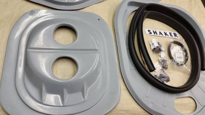

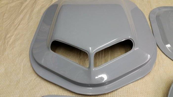

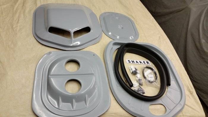

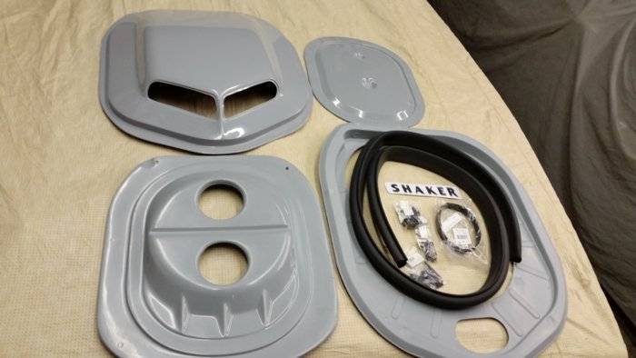

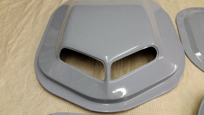

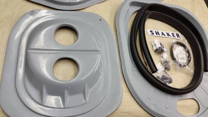

I received all of my parts. Let the cutting & hacking begin. Hood opening will be a couple of inches longer, base plate will be the same couple of inches longer & custom drop made to fit the dual dominator carbs, scoop will be longer as well as a few inches tall when it's all done. Essentially making it a "super shaker".

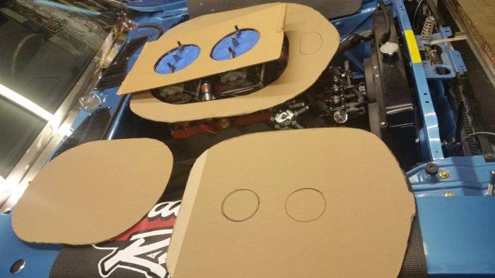

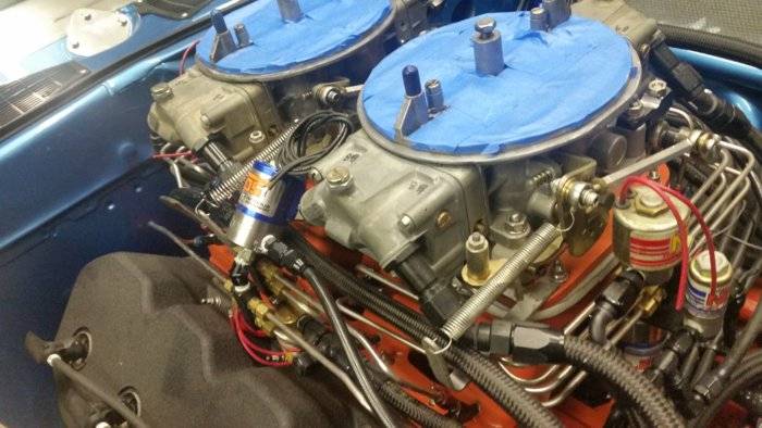

Per my other thread. Finally got out in the garage to work on the latest project a little. I had to reconfigure my outboard fogger around a little & lean the solenoids in a little to clear. I made all of my templates to start making my dualDominator tunnel ram shaker conversion Time to start hacking on the parts now.

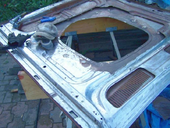

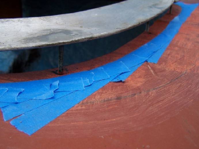

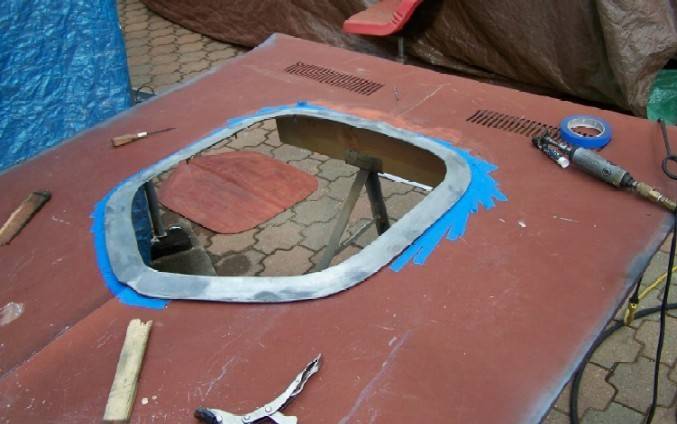

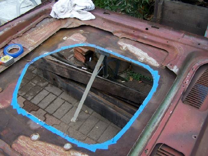

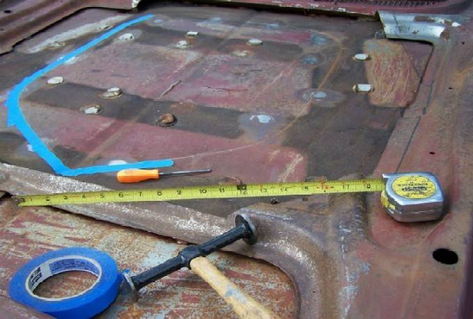

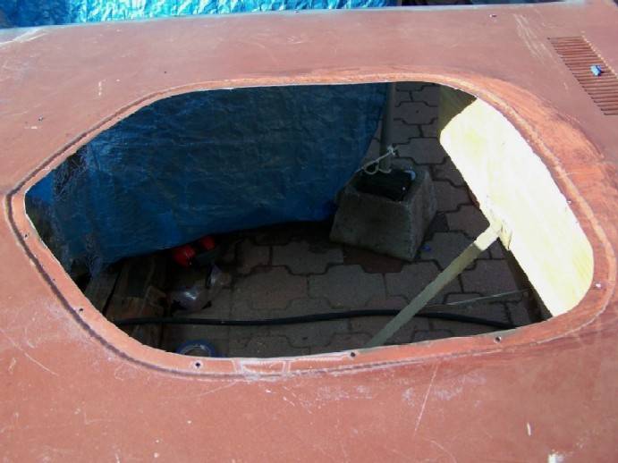

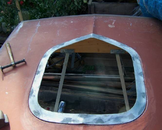

I know this is an old thread but can you detail how you determined the hole opening with regards to leaving the appropriate amount of material for the flange tool to work properly ?
