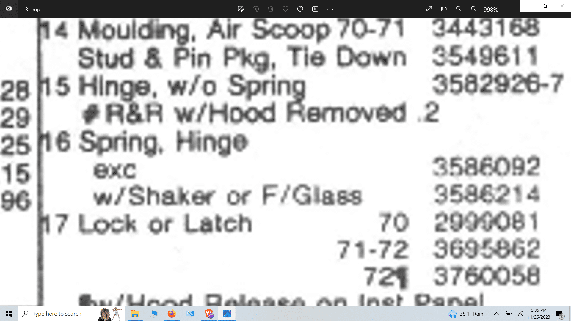

Do factory fitted Shaker hood cars have lighter hinge springs because of the large hole cut in the hood for the Shaker?
If so what are the differences.

I thought there were only two hood hinge springs, one light set of springs for T/A and AAR fiberglass hoods and another set of springs for everything else. But I willing to be educated as well.

Voilà!

Cool Challenger RTA! I didn't realize shaker hoods used the light fiberglass hood springs as well! Thanks for the education!

Thanks Challenger RTA for that information. Clearly they do use a different spring than all the other steel hoods and as we now know are the same as the fibreglass hood cars.

Start with this one.

I have two original shaker hood Challengers and a T/A with the original hood hinges and springs. The springs are NOT the same between shaker and T/A. I can’t imagine that the smaller diameter spring used for the fiberglass hood would work for any type of steel hood.

I just ordered a set of springs for the Shaker hood. The original springs make you use a lot of force to close the hood. With the metal removed for the Shaker hood tends to flex and could cause bending at the hinge point. The parts catalogue I have doesn't list it as Shaker hood springs, it says fiberglass or with fresh air hood.
So calling it a fresh air hood instead of a Shaker caused the confusion on my part.

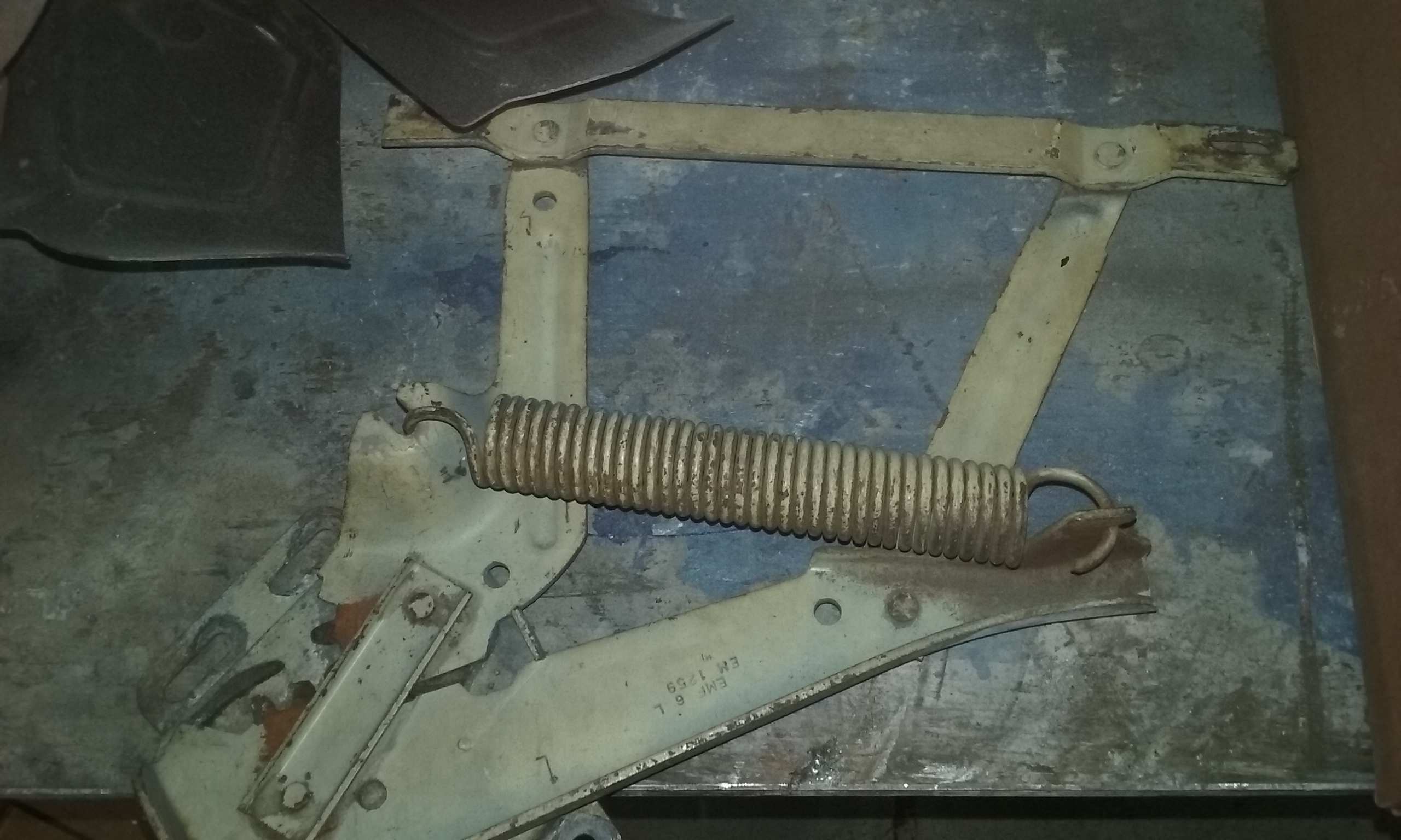

T/A hood hinge with spring. From flipping a T/A and a R/T hood around by myself. I would guess the T/A hood weighs 75lbs or less, R/T about 150lbs. I think a shaker hood might only about 25lbs less. The shaker might be compromised because of the cut out. Also there for less weight beyond the tipping point of the hinge. Just my 2¢.

Can anyone show what the difference is in the two types of spring?
Do they measure or look different?
How do you tell which type you have.
My hood is fairly easy to close I might already have the correct springs on the hinges.
