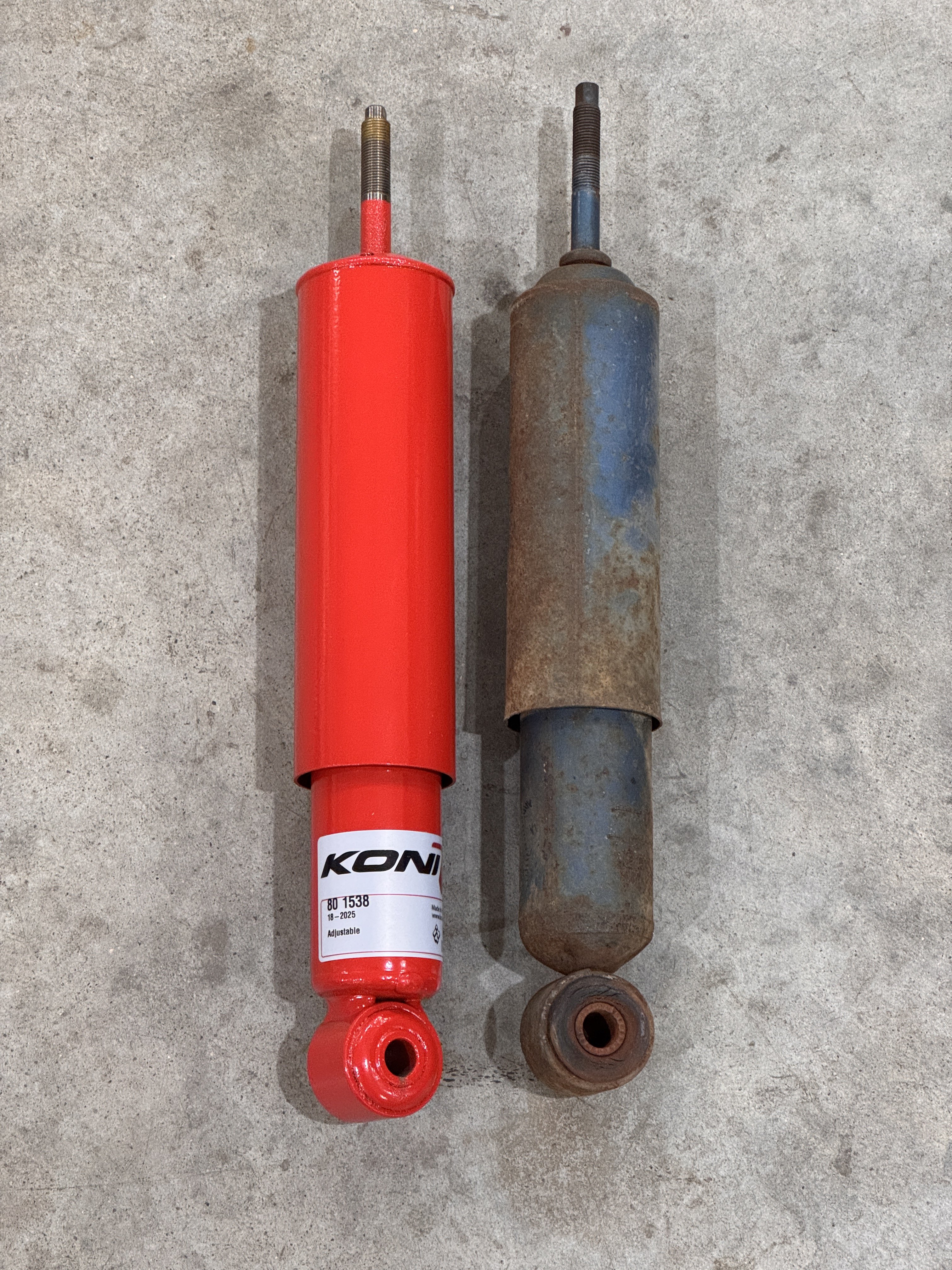

Went with the Koni's also. They are adjustable but not with a valve on the side so they appear more stock. Will have to repaint mine from red to black when the time comes.

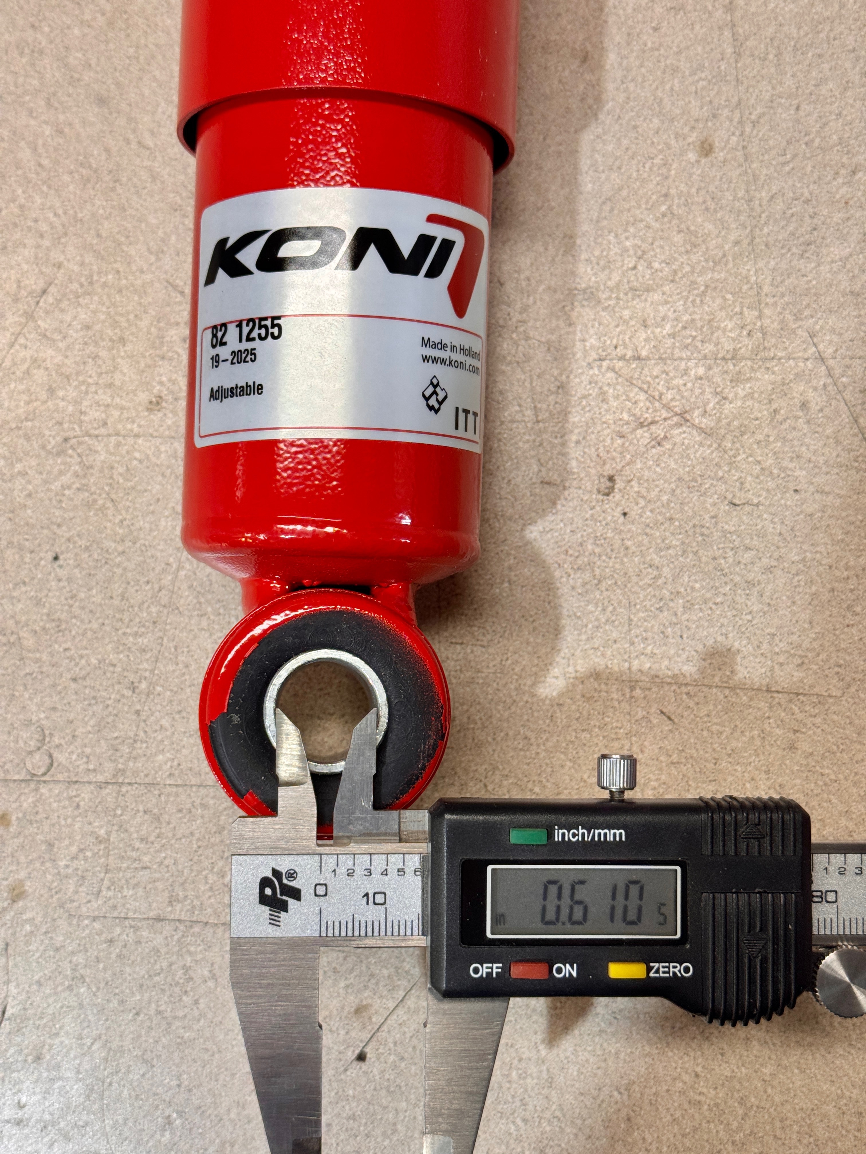

Koni 82 1255 Shock Absorber Rear For 1970-1974 Dodge Challenger ?

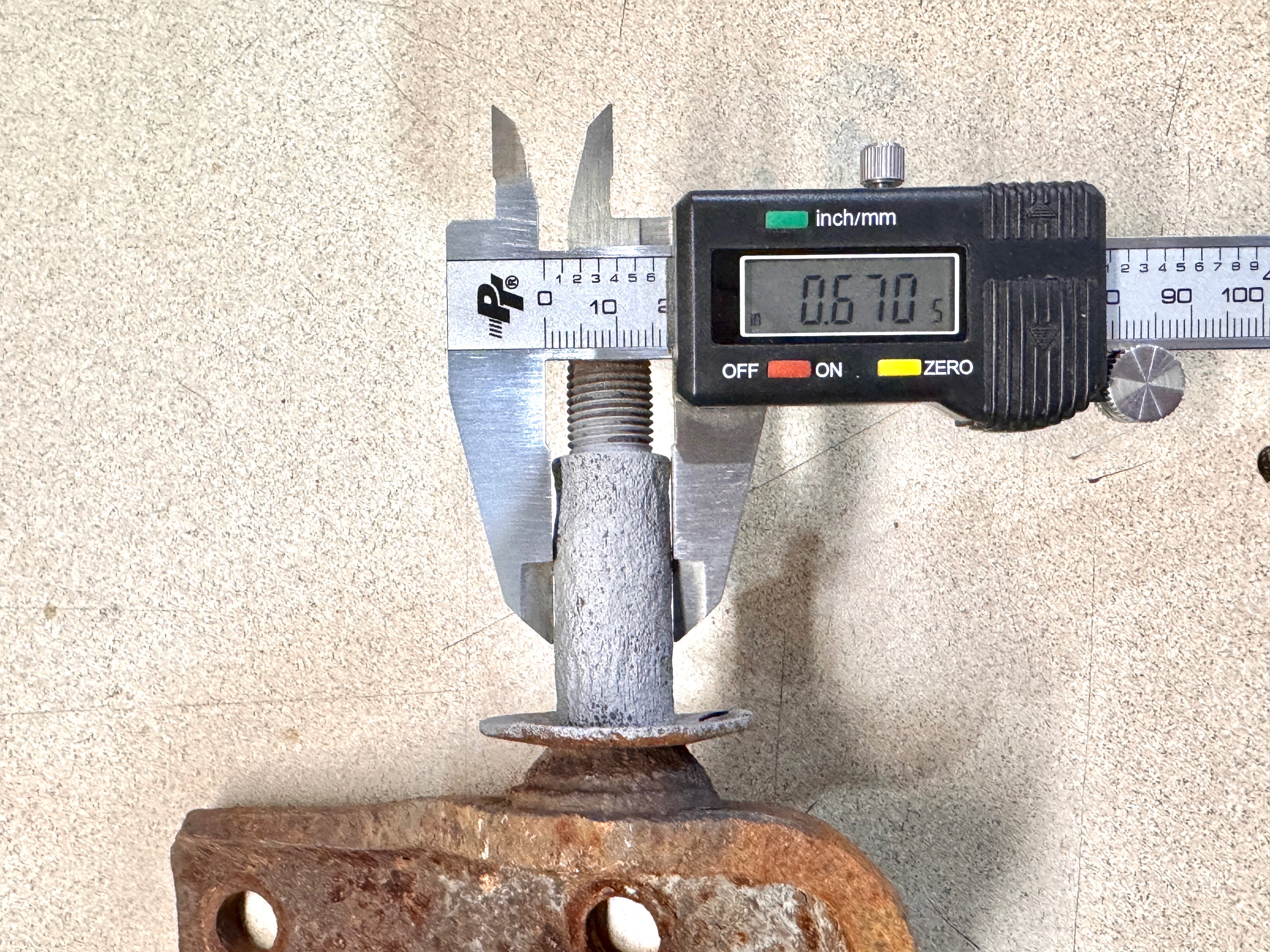

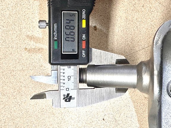

How did you get the rear Koni shocks to fit the stud on the rear shock plates? The stock stud is too big to fit the rear Koni shocks.
That’s concerning, my plates are off having new studs put on, don’t have them in hand.
Assume there is a metal sleeve in the bushing? (Don’t have my shocks available)
