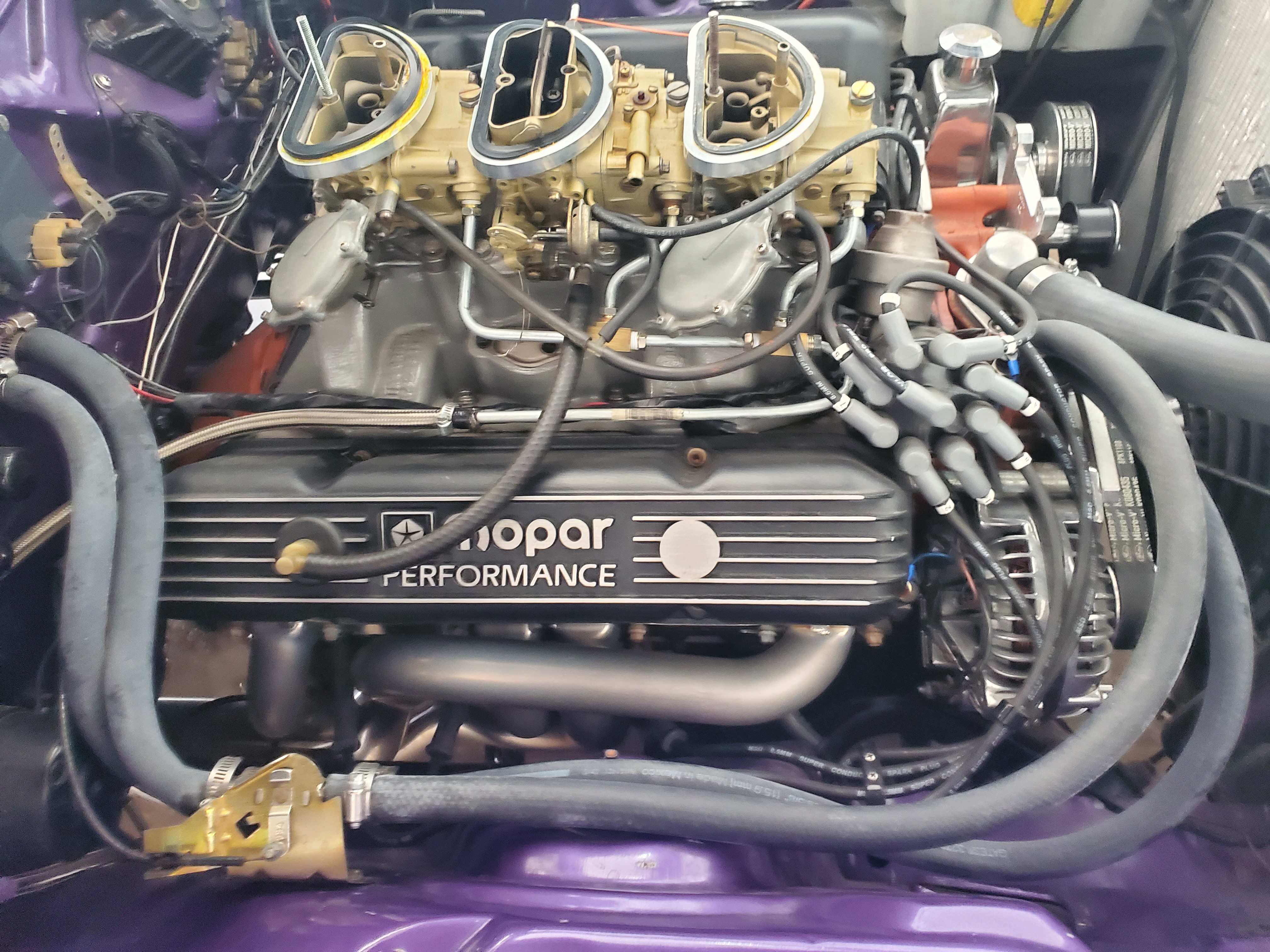

Recently bought a 71 Challenger 4 speed with a six pack. A couple times a drive I will accelerate and the RPMs will rise and then get stuck almost like on cruise control. The car does not have cruise control and if I put it in neutral and rev it then RPMs still won't drop below the sticking point. The only way I can get is to drops is re-engage the clutch and it will drop.

Currently using a divorced choke. The six pack was added to a date correct 383. I am not sure where the six pack was sourced from. The engine has a mild cam and aluminum Ebelbrock performer heads. I have the divorced choke dialed to help compensate for the lower intake Temps.

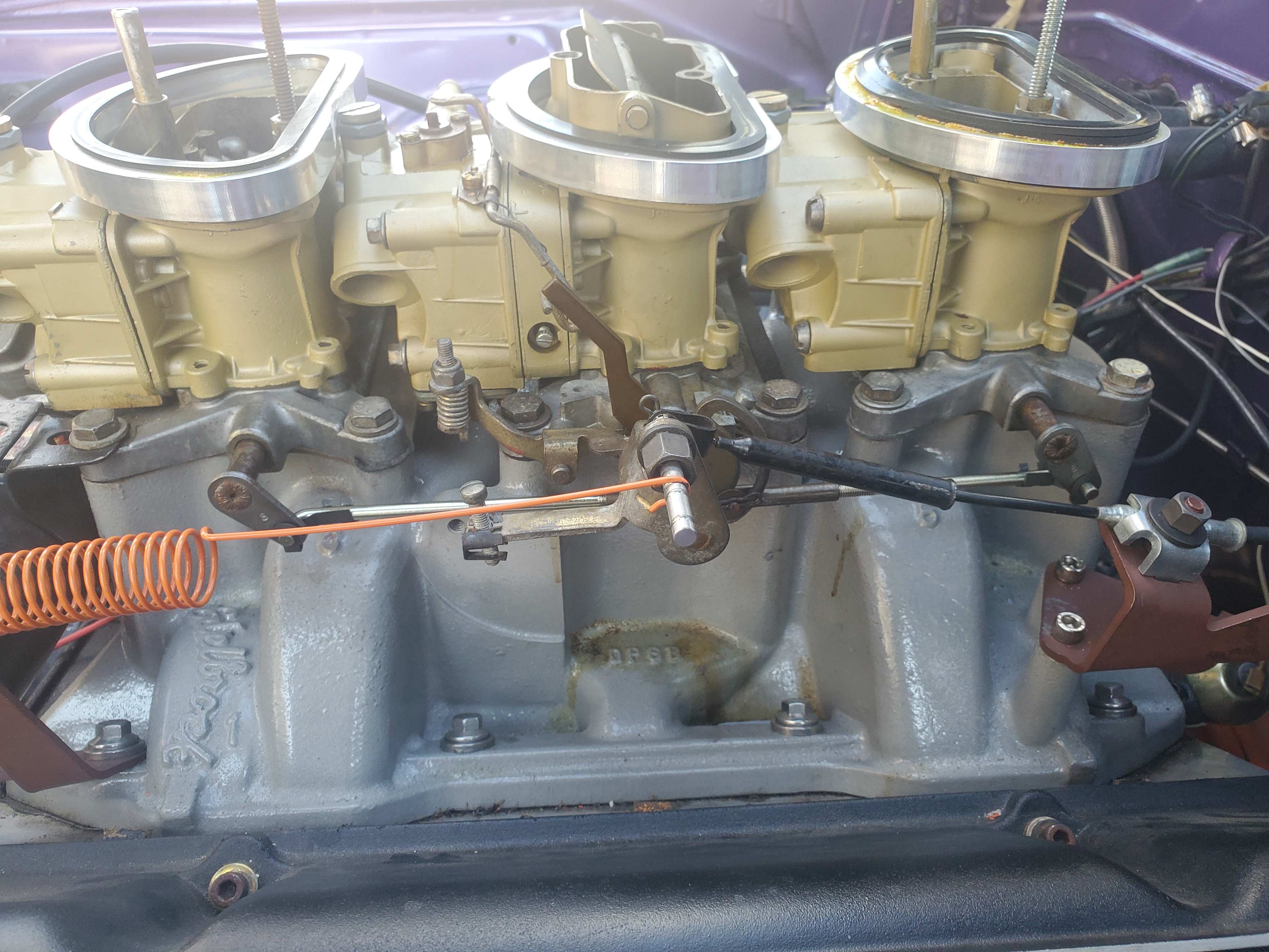

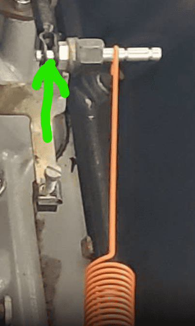

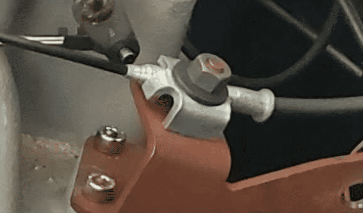

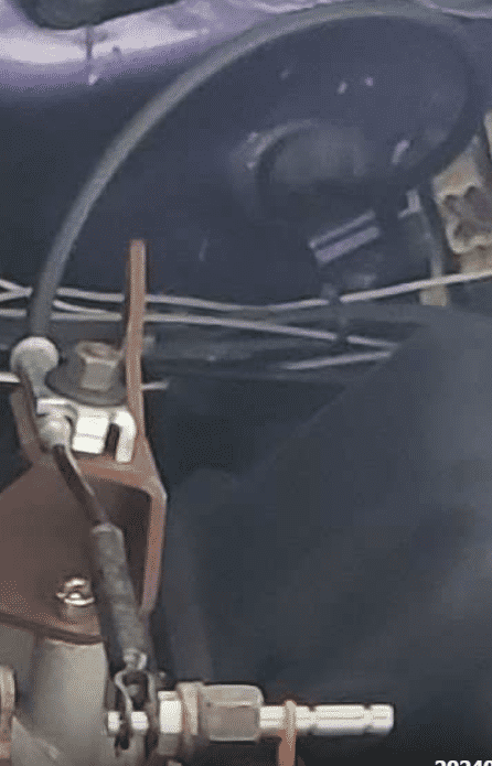

Think I'd start by making sure the cable itself does not bind at any point in its full travel.
Then I'd verify the bowl vent linkage isn't hanging on my air cleaner base causing interference..........
Next the throttle linkage return spring. I'd move the spring into the space between the cable end to keep it pulling in a straight line rather than an angle............

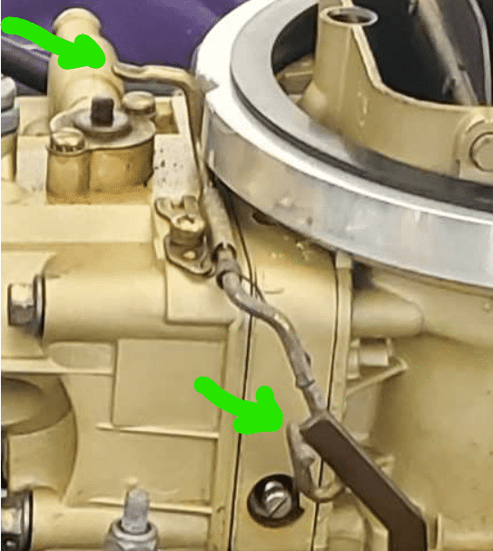

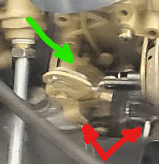

When adjusting the throttle cable, I loosen the cable retention nut and hold the throttle all the way forward making sure it's off the choke steps (green arrow bottom picture) and seated on the idle stop screw. Then I move the cable forward slightly to provide just bit of slack in the cable before securing the retention nut.......
Why is the choke rod not attached (red arrows, bottom picture)??

Wow, thanks Daves69, I will start checking these recommendations out. These are photos from when I bought the car, the previous owner have the choke wired open. I hooked up the choke rod since then. But the rest of your points still have not been addressed.

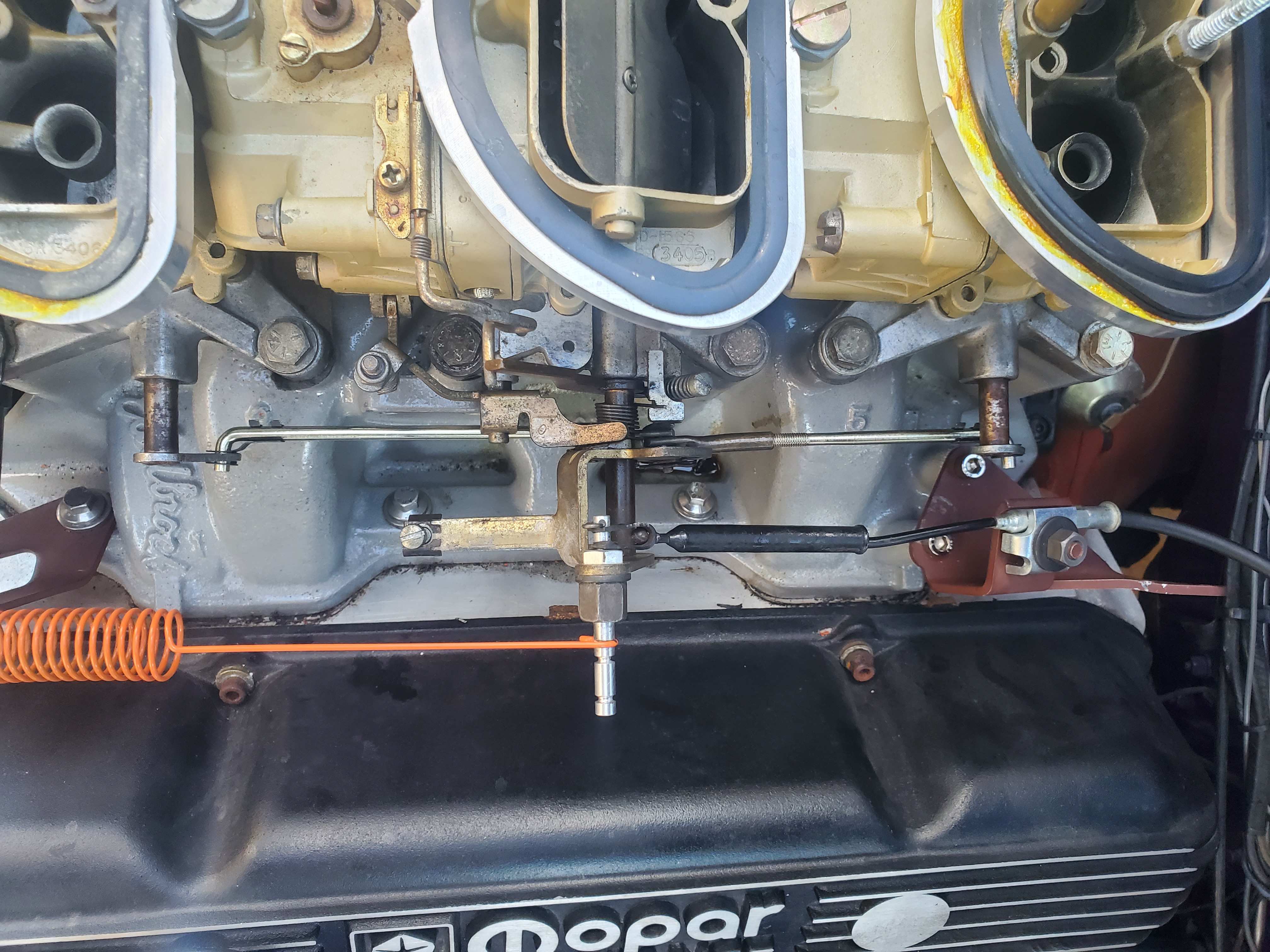

In addition to Dave's recommendations; I would unhook the throttle cable and manually rotate the carb throttle shafts to see if there is any binding. The shafts should operate smoothly both opening and closing. The outboard carbs use a vacuum diaphragm under spring pressure which helps to close those carbs when air through those carbs stops flowing. There may be some resistance with those but the throttle shaft movement should still be smooth and they should close completely on their own due to that diaphragm spring.

So the issue is definitely the secondary not closing. The way the are set up now if I apply the slightest pressure one the linkage between the front the rear secondaries the RPMs increase about 300 rpm as stay stuck there until I apply pressure in the opposite direction to close them. When I apply the pressure I don't notice the front or rear butterflies exposing a gap but the RPMs do increase and stick.
