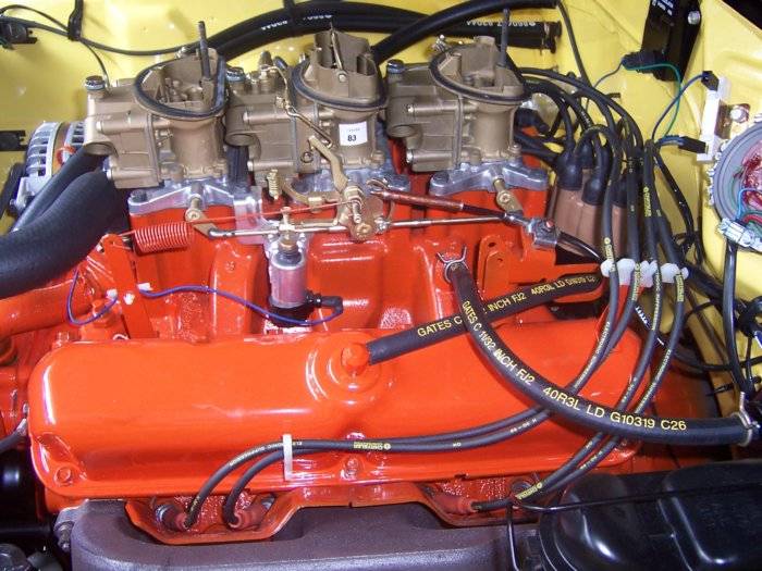

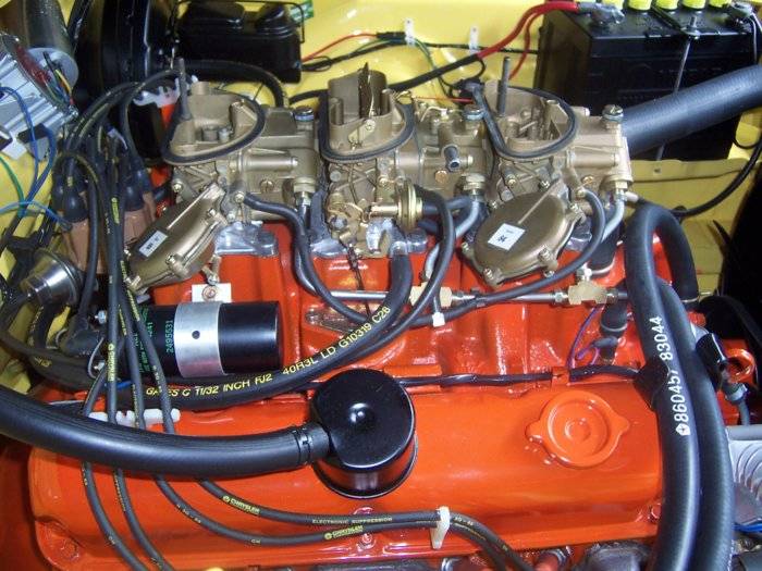

    hello I am working on some final touches. I was not able to find a 340 six pack base plate so I went with the 440 one. Looks like the breather line comes out of the passenger side and goes to passenger breather on valve cover. This leaves the pvc valve on the driver side cover. From what I gathered the pvc hooks up to the pass side of the main carb. How does it route all the way over to the driver side cover? Back side has the dist and wires also shifter linkage
    Any help would be great thank you

    Both auto and 4 speed hoses are routed the same on a six pack
