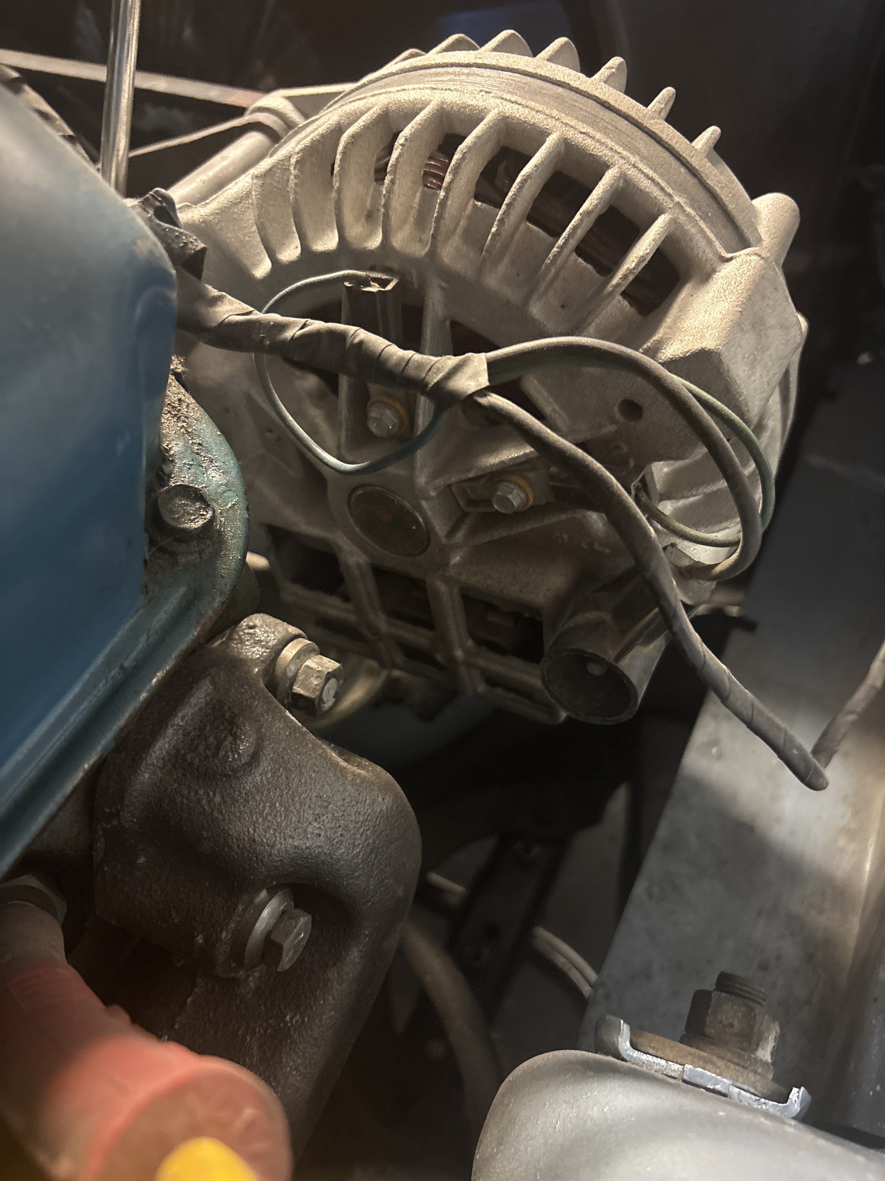

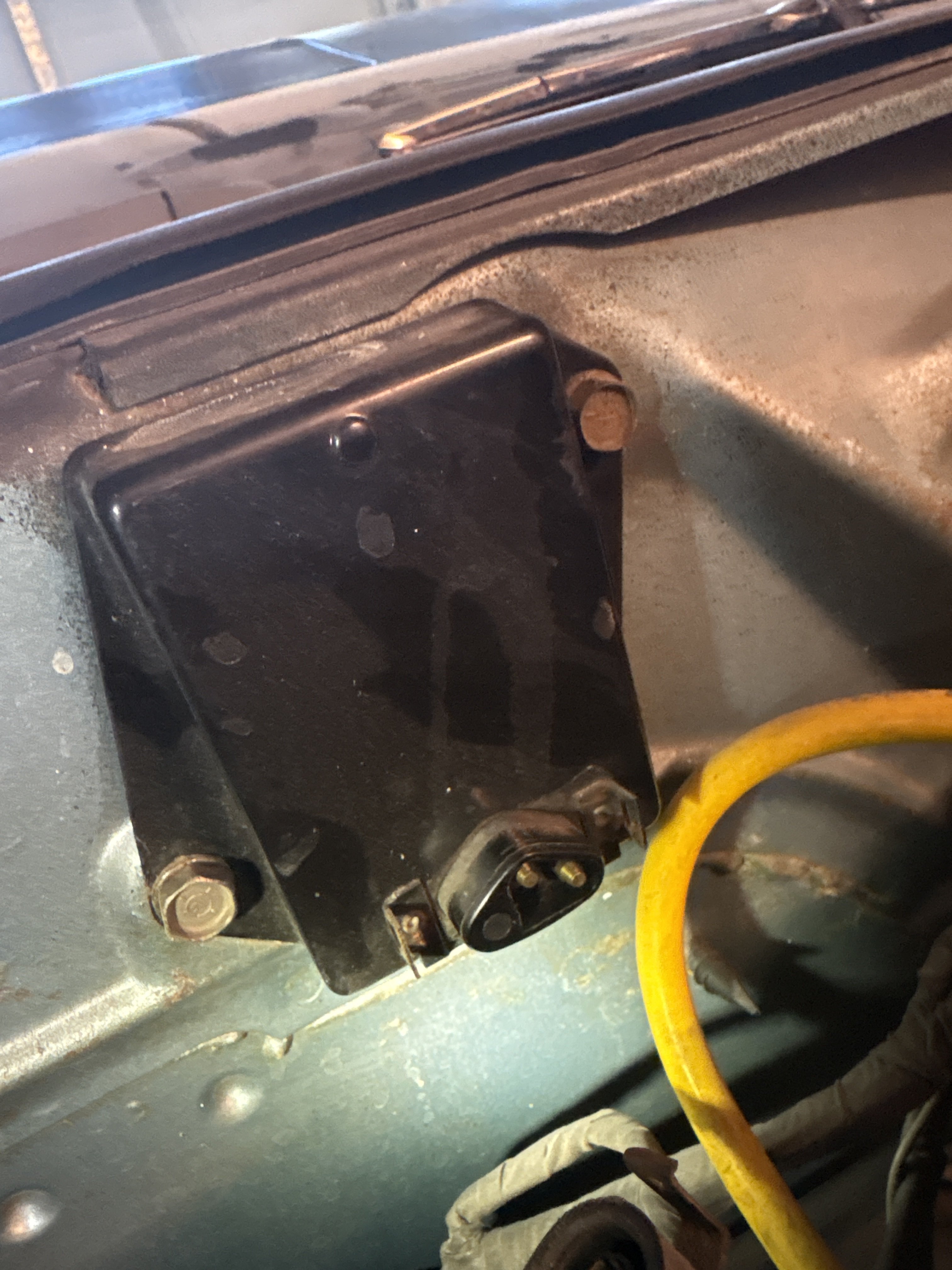

After pulling the VR wires, I see that it is a 2 Wire connection rather than 3. I have attached a photo of my VR and one of my Alternator. I know Photos always help. 🌴

The 1970 Barracuda was originally equipped with a two terminal electronic, or solid state, voltage regulator. The pictured regulator is an aftermarket electronic, or solid state, voltage regulator.

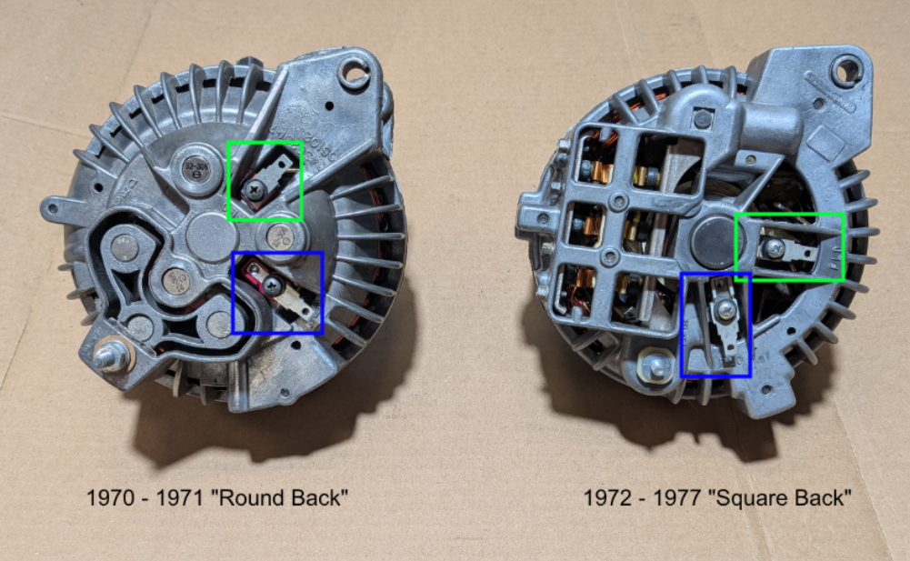

The pictured alternator is a 1972 - 1977 "Square Back", isolated field alternator. The 1970 Barracuda was originally equipped with a "Round Back" isolated field alternator. The two alternator versions have two field connection terminals and are used with the 1970 and later electronic voltage regulator. The two versions are interchangeable. The following image shows the two versions:

Yes, it is already a solid state voltage regulator.
