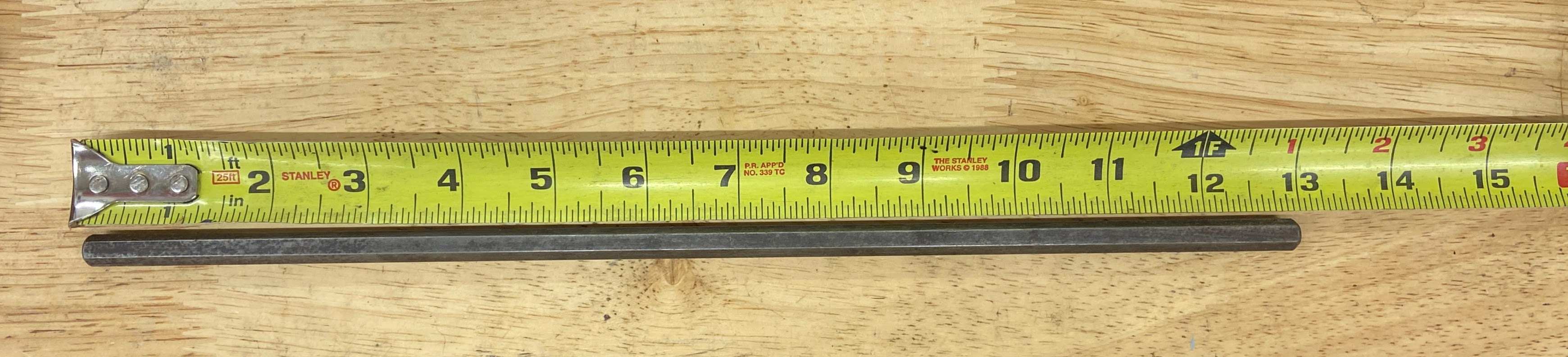

Hard to really hear exactly where the sound is coming from in the video, better being there. But. I would remove the valve covers and check to see if there is any oil up there. Oil should travel up and into the rocker shafts then leak out of them into the rockers to keep it all oiled up there. I would make sure that the holes in the shafts are aligned properly with mounts with the oil holes and that the rockers are aligned with the pushrods. Maybe the rockers are swapped and or that the pushrods are loose? There should be holes in the rocker shafts that align with the shaft mounts. Pull the valve covers off and the distributor. Prime the engine using a 5/16" Allen and corded electric drill. That way you can see the oil come into the heads. You may have blocked oil passages, worst care scenario. The photo is what I used to prime my engine. It came out of a mid 90's ford taurus auto transmission, its a 5/16" x 13" Allen.

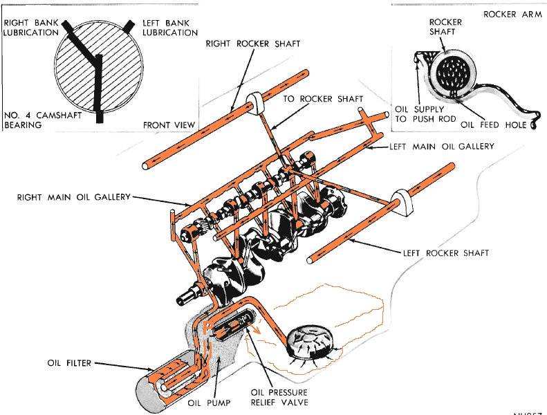

The oil gallery diagram Challenger RTA posted above shows how the oil flows. Can you see any oil on the rockers when looking through the breather hole?
You bought this vehicle and it was kinda piece milled from a former owner, correct? That's why I'm guessing there's an issue with #4 camshaft bearing. With 70 psi oil pressure (a little high at idle -even at 2500 rpm), it seems like oil is not getting up to the rockers and pushrods.
