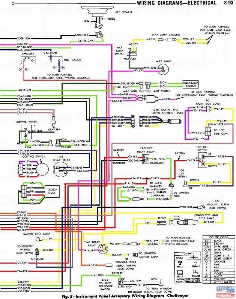

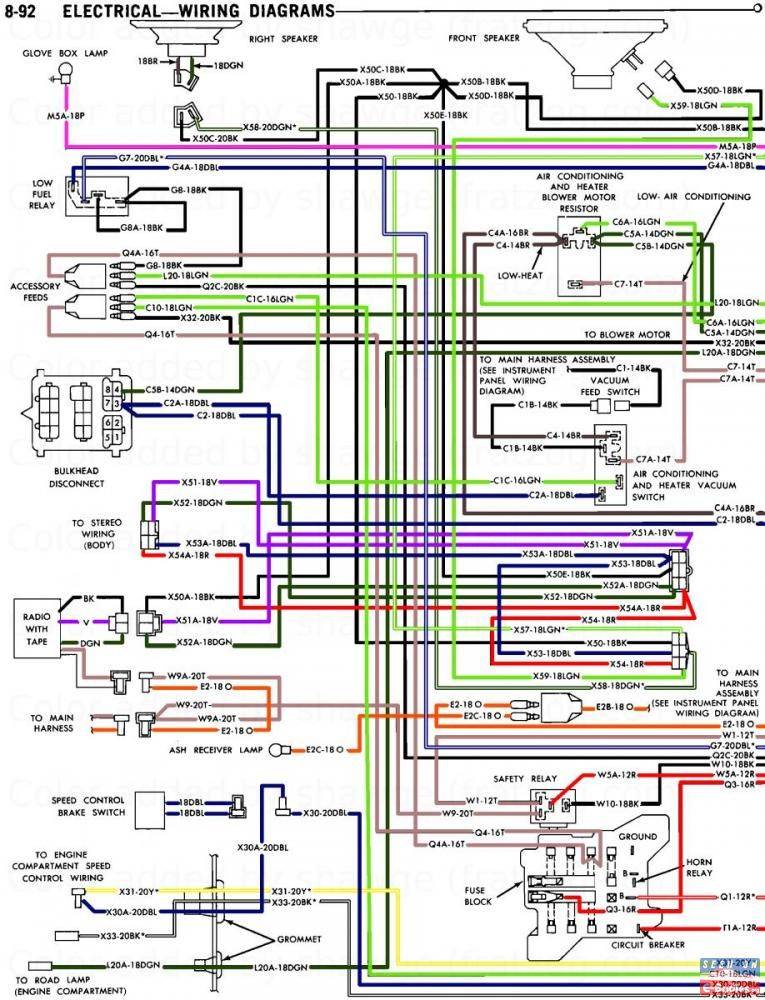

Thank you for the diagrams, but I wanted the internal diagram of the crossover. It seems that mine eats up the signal, if I bypass it and just use 2 speakers, the volume is better.

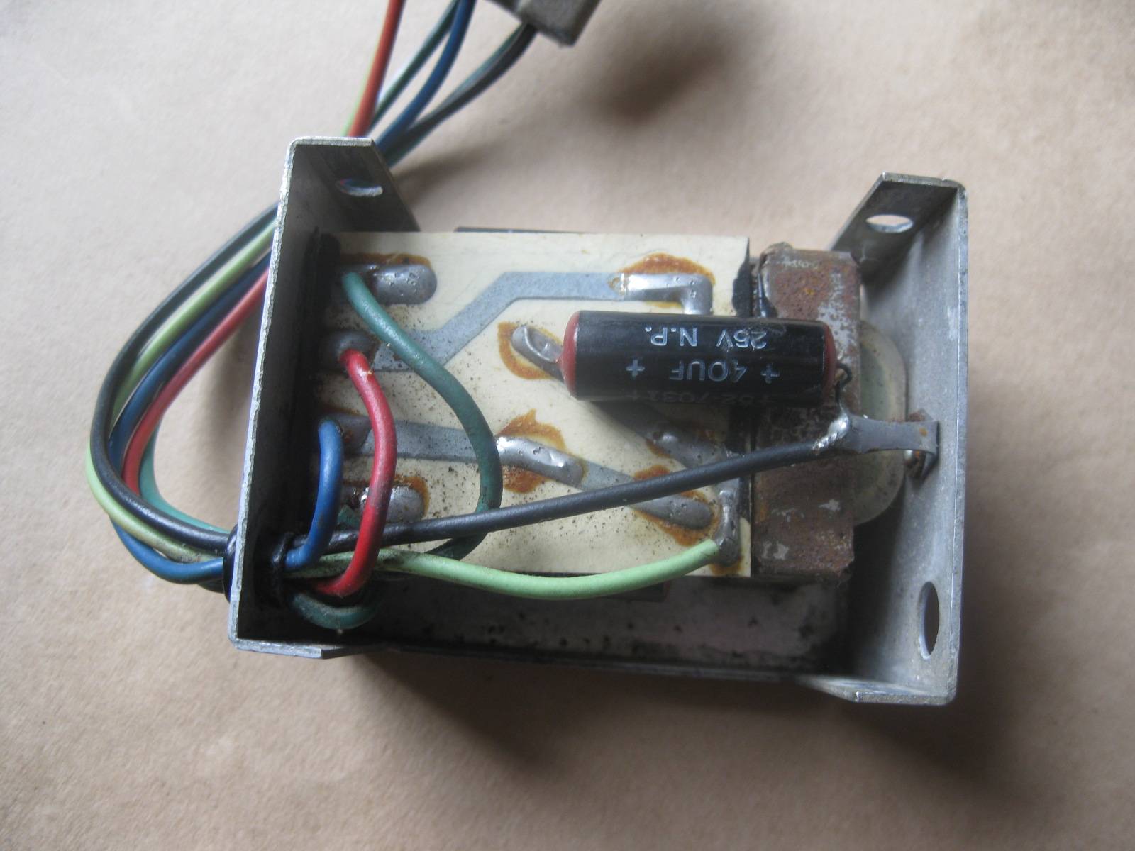

I got ambitious and took my spare apart. First I scribbled out the circuit board then made the schematic. It's obvious that the light green is for the center speaker and black is ground but I don't want to guess which is input & output for left/right from the remaining 4.
PS(edit): My DVM zeroed out at .6 ohms. when I measured across the coils, while still in the circuit, I got 1.2 ohms. That's why I'm saying they're approximately .6 ohms each.

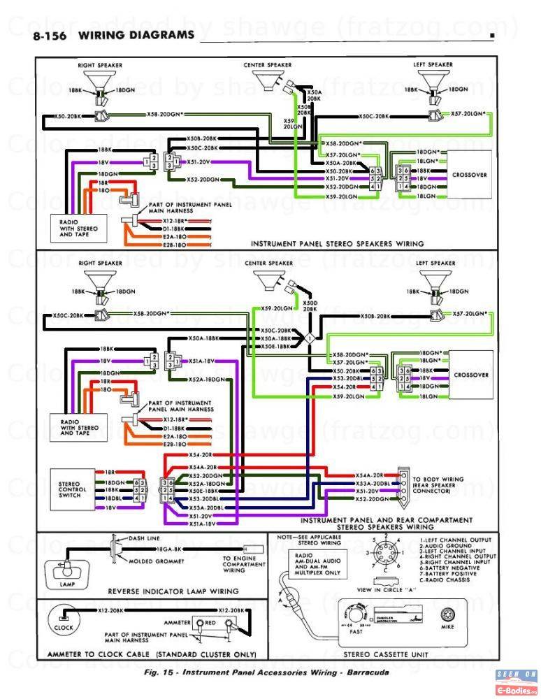

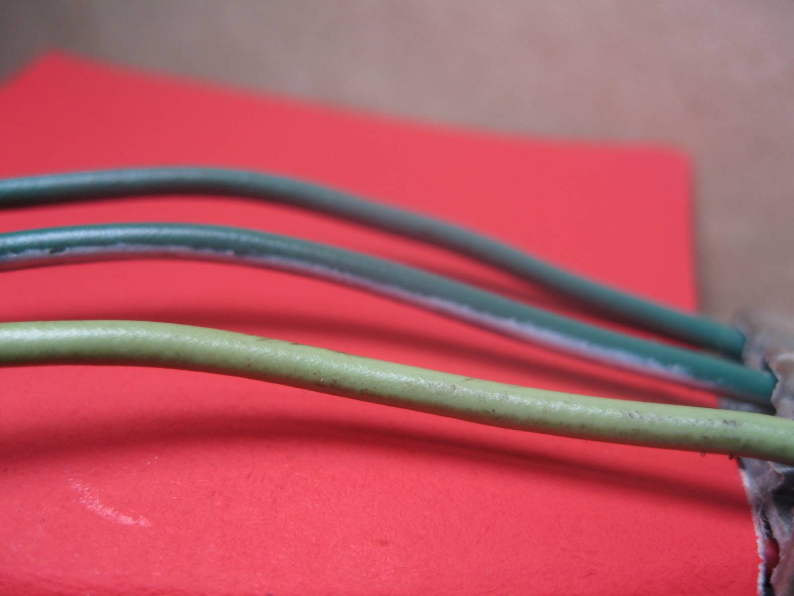

Just noticed a wire color discrepancy with the manual's wiring diagrams. My crossover box has one light green wire and two dark green wires with one of them having a white tracer. Also mine has no violet wire. So could something have been wiped off or discolored on mine or could there be errors on the ones in the manual??? Also, I put a label on my spare crossover box which reads: "TESTED JUN 02/17 A.O.K.

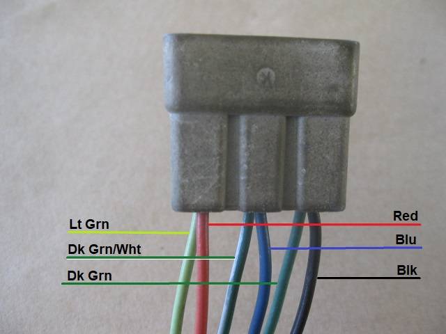

I looked at more pictures of crossover boxes and can say with absolute certainty that the FSM color coding is wrong, especially Fig 15 page 8-156. The correct wire colors and locations are in this picture. I haven't dug into the harness yet, that's for another day.
