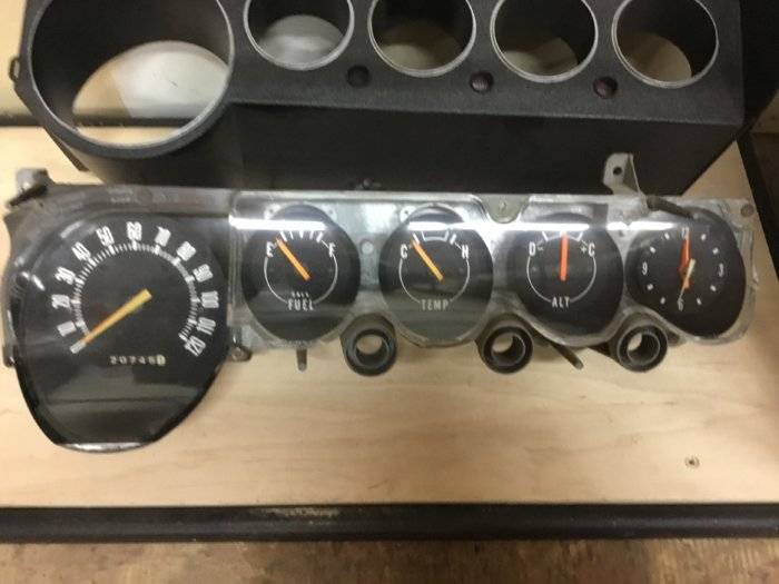

I've got the standard cluster but with the clock on the RH side. The clock doesn't function correctly, the hour and minute hands never move but the second hand seems to be in a different position, so it must be moving very slowly. It is also missing the stem to set the time. I can't find any information on that part.
Does the stem stay mounted to the clock or is it removable?
Where can I get a stem?
Any suggestion for who to rebuild it if I can't figure it out?

I’ve never seen a clock in a non rally dash. Must be pretty rare. Got a picture of it ?
That looks nice. How do you set the clock? I don’t see anything going through the lens like on a rally dash’s
I've had a couple of these in non-rally dash e-bodies. The reset is much larger then the rally dash and feeds in through the bottom of the clock, through the dash bezel. I also need one and was not aware they were being reproduced. Thx
Here is a photo of the clock knob on a 1970 standard dash. (Sorry for the odd angle.) Clock - Electric was option J21 for $16.50.
I can honestly say I never saw one of those on a standard cluster. Very nice.
