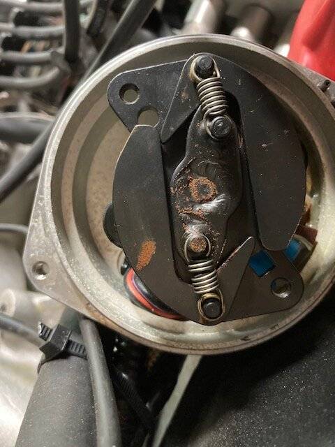

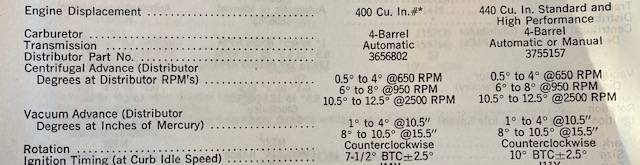

I replaced my electric temp gauge with a mechanical gauge and it seems to be sitting at 180 were its supposed to be. I spent 2 days burping the system to make sure I didn't make and simple mistakes this time. I haven't driven it yet because I want to make sure I get it right first. I did find a stretched advance spring inside the distributor so I went and bought an MSD spring kit to replace that. I'm going to go try to time it again. I'm running the light advance springs that were on it since I don't know how to figure out what kind of mechanical advance curve is perfect and it seemed to like them. I tried to look in my Chilton's manual for timing specs but they're super low, like under centrifugal advance which i believe is mechanical advance it says .5 to 4 degrees initial and 10.5-12.5 degrees final? I know my engines not stock but 36 degrees final compared to 12.5 degrees final is an enormous jump. So you think running 36 degrees total and 10 degrees initial is a good start, and use the spring and stop bushing kit to achieve that amount of curve?

The blue advance bushing should give you 21° total so if you start at 10°,you'll get 31° total. Which i would think is not enough but if the overheating is still there (not effected by the base timing) then you could adjust for 15° inital (36° total) without having to change the advance bushing. The 2 light silver springs will bring it all in by 1800-2000rpms. I don't think i'd want anymore then 36° with boost, but I am curiuos where you end up. Even the factory settings with 23° total (mech + vac) sounds low, but 8°-10° idle sounds normal for stock
