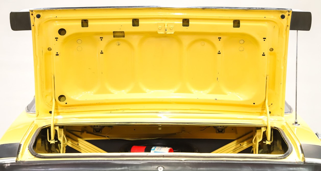

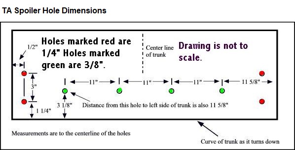

I have not seen a T/A spoiler engineering diagram but the below may help.

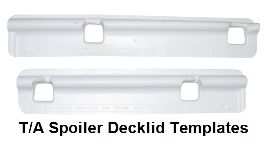

The templates to cutout the underside of the decklid (square holes) can be purchased from AMD.

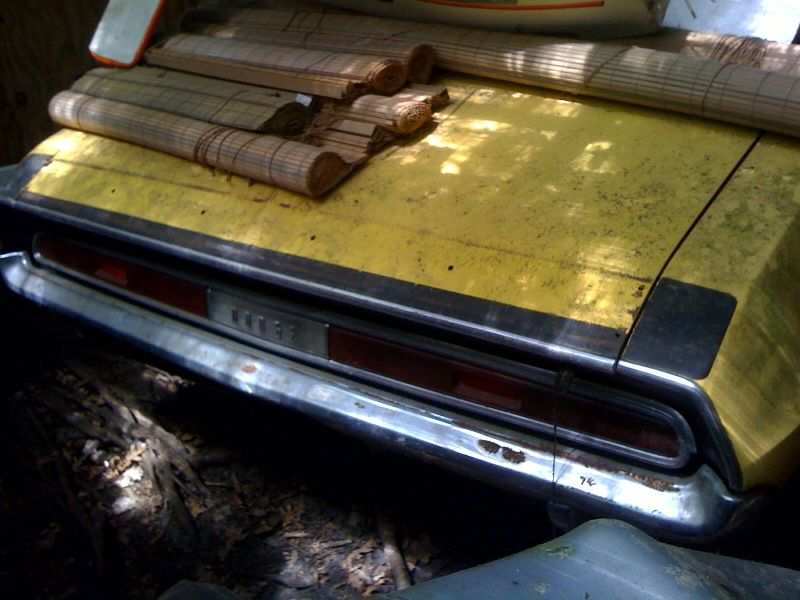

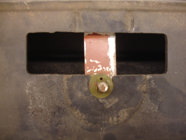

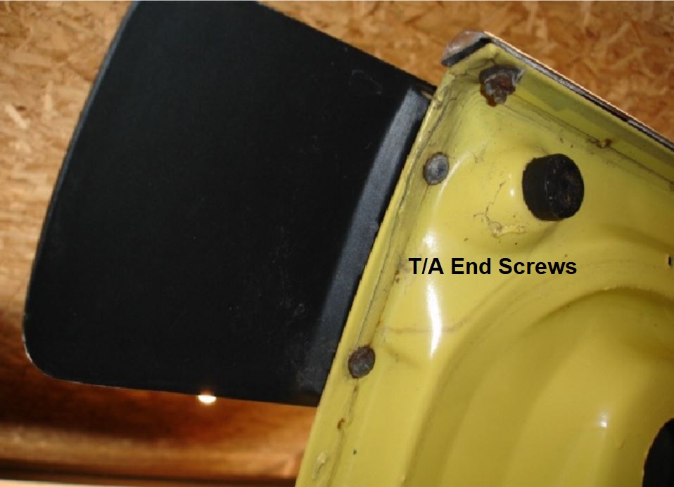

Be sure and paint the blackout on the decklid (1-1/4" wide) and purchase the quarter panel top decals.
