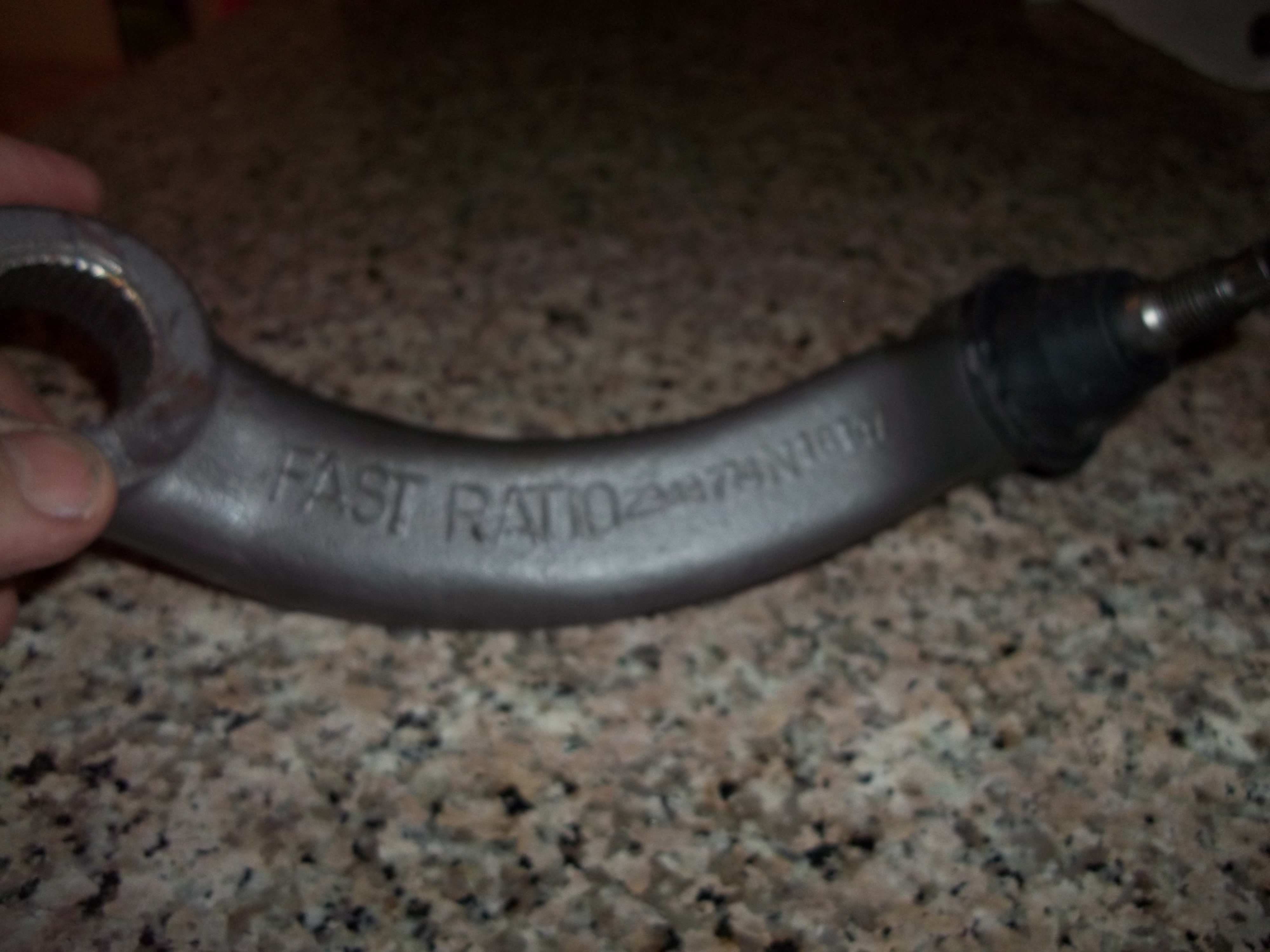

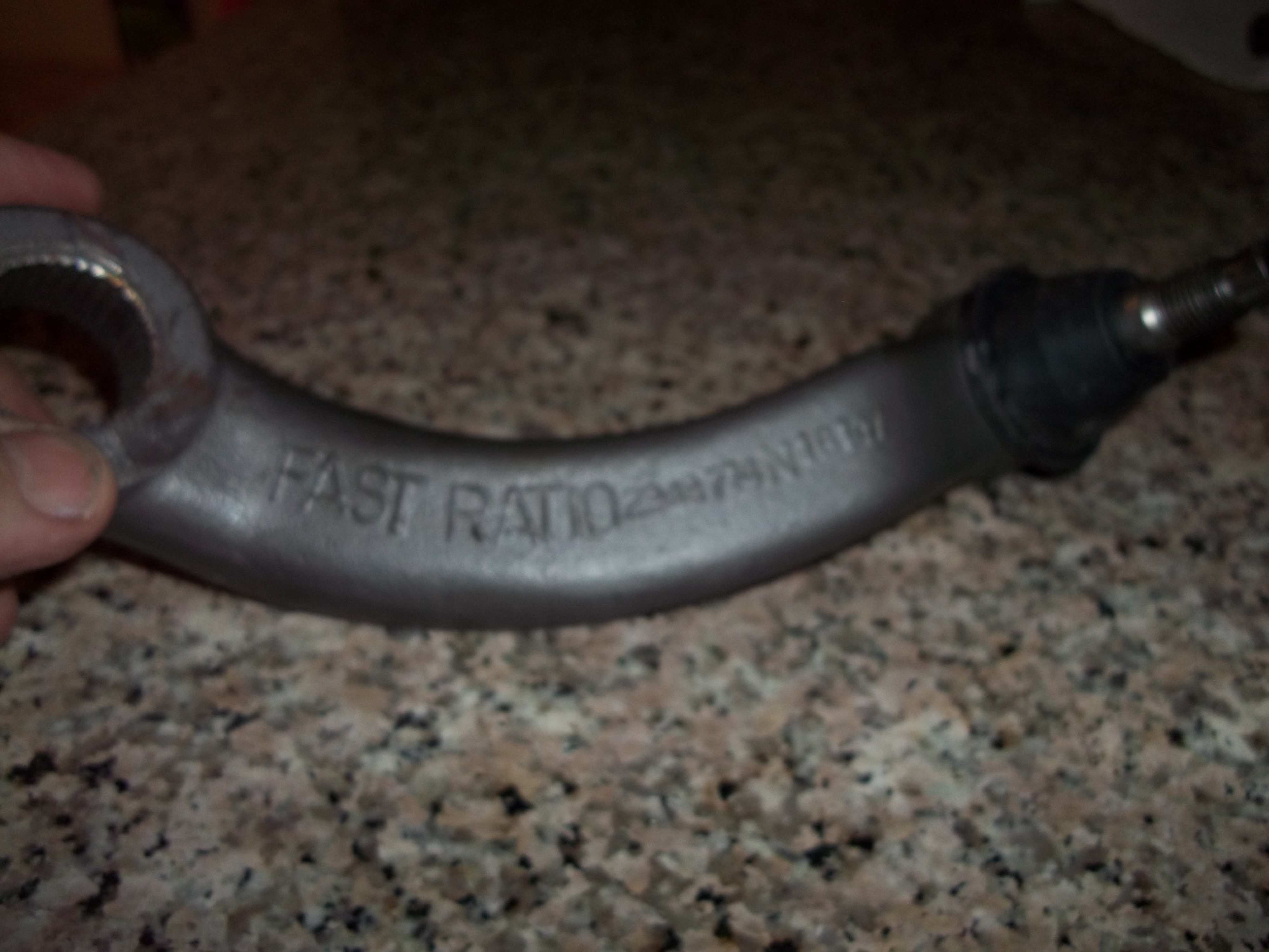

The pitman arm you have on does it have fast ratio on it?

A little more info that might be of help.
