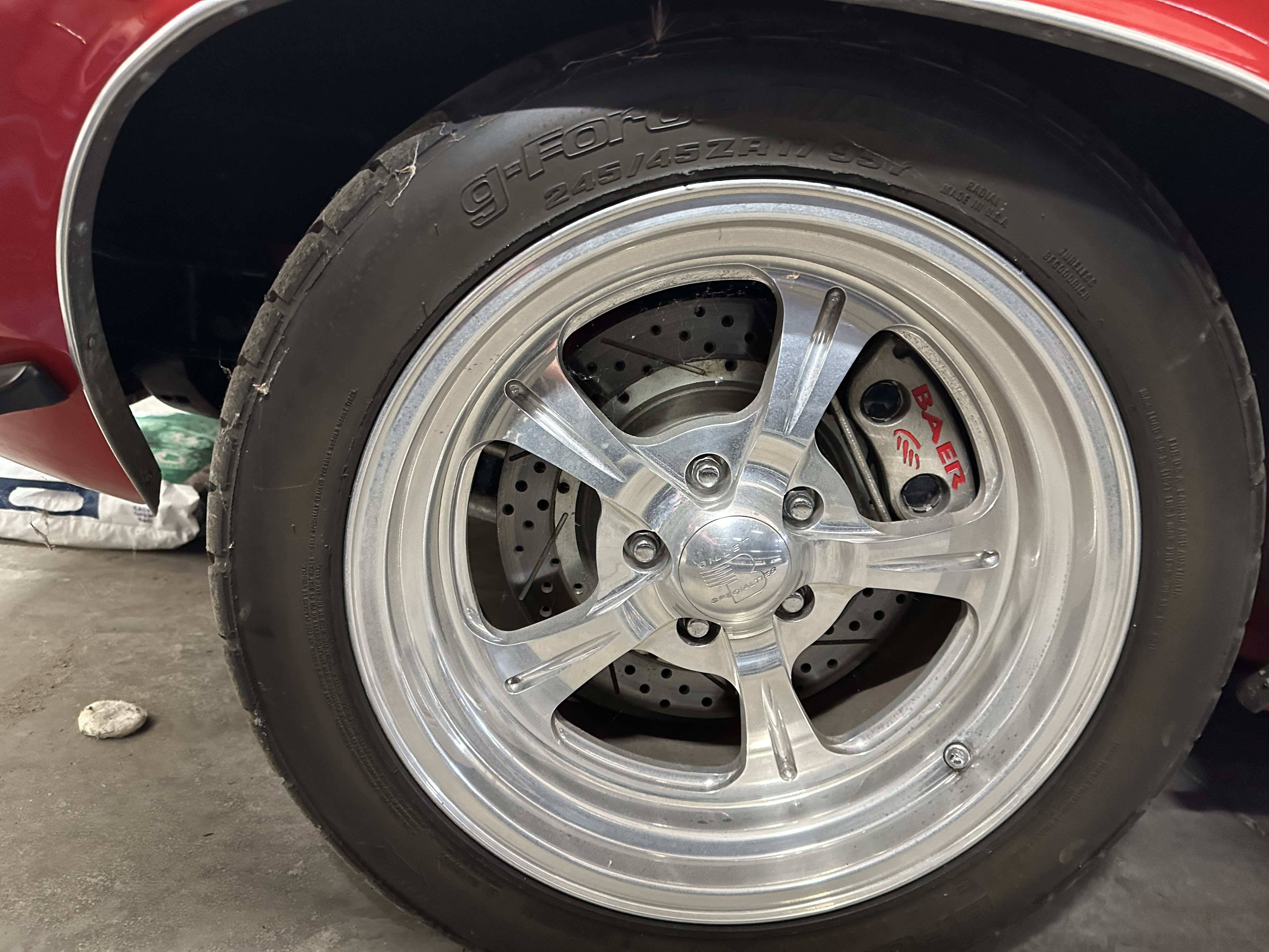

At first thought I would say you have too much tire, but I checked my 72 Barracuda and it has 245/45ZR17's and they don't rub.
It's possible the fast ratio pitman arm is your issue - I believe the fast ratio pitman arm is longer than stock so the same steering wheel movement will move the steering geometry further for the same amount of input - which will then move the tire further, which might be enough to make contact when using your slightly taller tire...
FYI- I have found tires sizes to be slightly different from one manufacturer to another, which may add to your rubbing issue.
My 17" rims are custom offset to try to maximize the tire size for that rim while also fitting around the brakes and in the fender wheel opening - If I remember right they are 17 x 9 with 1 in negative offset. (Neg offset pushes the rim and tire outboard)
You might try a 1/2 -3/4 wheel spacer to see if that solves the rubbing issue. Not saying to keep it, but it would tell you if a different offset (different wheel) would fit and not rub. I am pretty sure the 1/2 to 3/4 in change wouldnt rub on the fender, but you should verify that if you give that a try... wheel spacers are fairly inexpensive. Also Keep in mind wheel lug thread engagement if you try a spacer.
I would have to say someone did there homework before they put that wheel and tire combination on. I bet you don't do any spirited driving, It probably handle like it's on rails. I always thought that was the ideal wheel and tire driving combo. But that's just me.

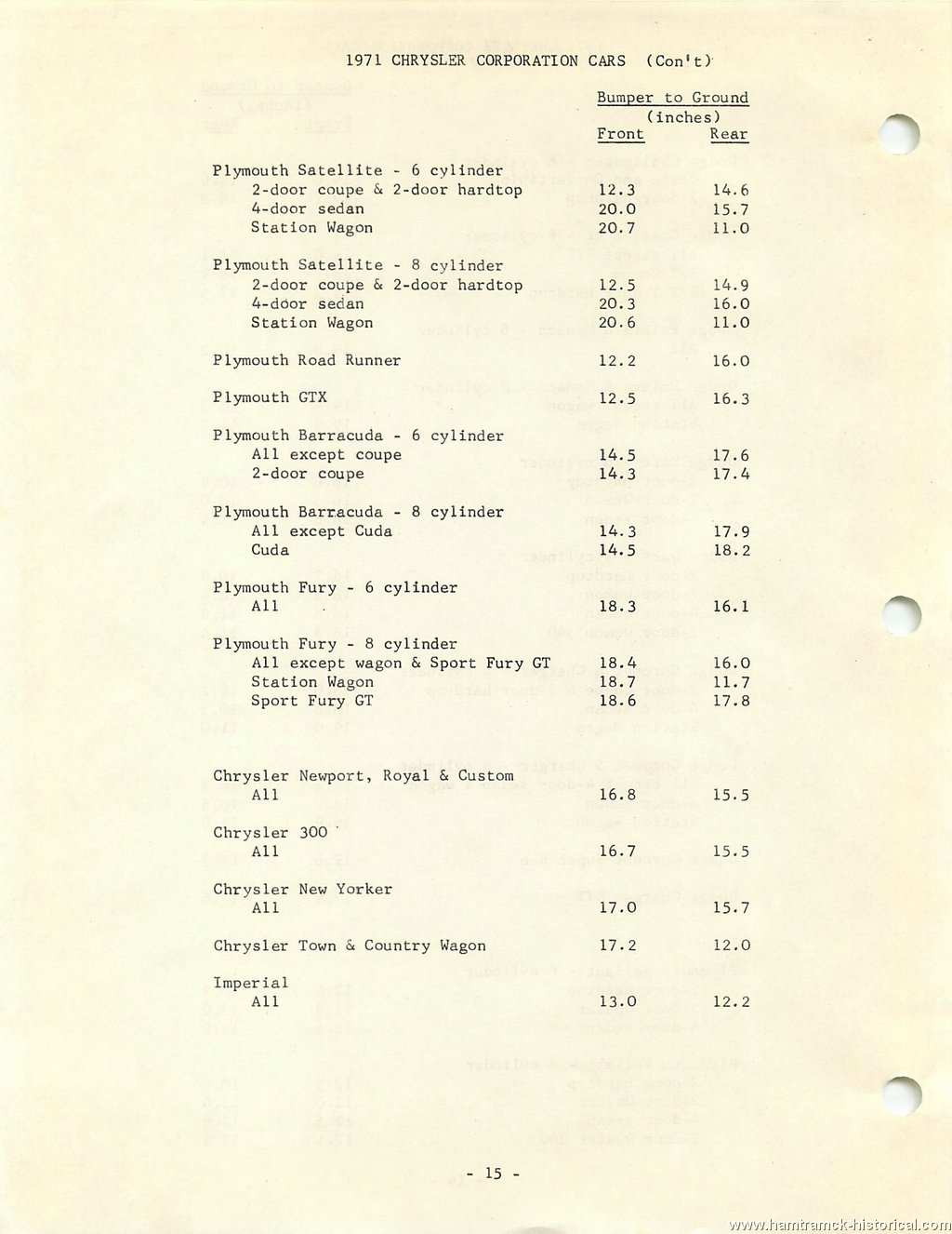

Does the car sit level?

I am trying to get in contact with Firm Feel to ask the question of whether or not their box has internal stops.....or whether or not the fast ratio arm has anything to do with the rubbing. Also--are those measurements to the bumper from the bottom of the bumper, center, etc?? I would say it sits level, but I will measure it. Also--it rubs on both sides.
