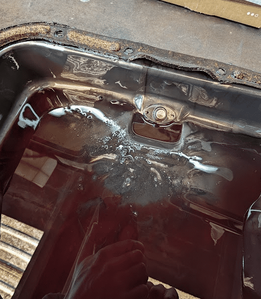

So next thing, I pulled the pan, and discovered my foward clutch laying in it.
It is all clear now !
At first I was a little bummed.... Now it's been an hour, brain has accepted and ... I'm actually excited to rebuild a 727 !

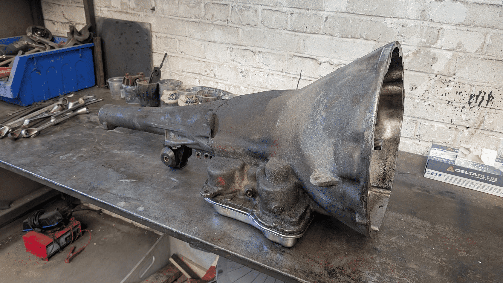

Pulled the trans off of the car. Easier than expected actually.
I'll be rebuilding it, ordered the Tom Hand's book.
Found great YT video's as well.
Now I'd like to understand why the clutch burned.
  • Could it be because my oil level was a little high ?
  • The oil cooling circuit looks like a rat nest. It goes from the trans to the main rad, then get's to another aftermarket dedicated rad, then comes back to the trans. i'm sure the oil is quite cool .... I'm also sure it affects the pressure. Could this be a cause too ?
  • Maybe the clutch adujestment in the drum itself ? Too loose or too tight ?
  • Another "usual thing" ?
From my understanding, this car hasn't really been driven for about 16 years, so maybe the clutch has also gone bad over the years...

Good for you for pulling the trans and preparing for a teardown! Tom's book will be a big help. Sounds like the transmission cooler setup is fine. Running a secondary cooler after the radiator is quite common, and will help the transmission stay cool. This is especially important if using a higher stall converter. Transmissions that have sat for a long time can certainly have problems with the seals getting hard and the clutches disintegrating. Not unusual. Our cars are made to be driven and they don't like sitting for long periods. You will find it quite simple to rebuild your transmission with basic tools. My first 727 rebuild was when I was in the military stationed in the Philippines. There was a typhoon coming and I had some time so pulled it apart and rebuilt it on a dining room table! My wife was very understanding, which was very much appreciated! The only thing I could not do was to replace the bushings but I did all the seals, thrust washers, and of course the clutches & bands.
