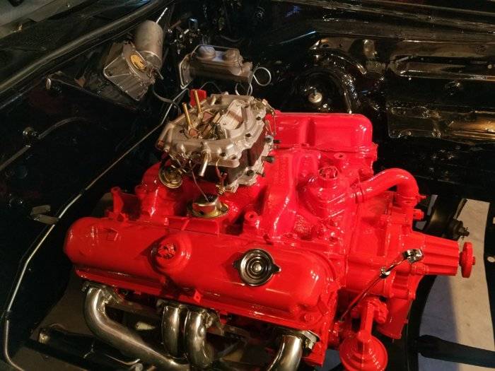

I had mine rebuilt by Scott Smith (WWW.HARMSAUTO.COM) in Spokane Valley WA. Looks like new and ran excellent while breaking in my engine. I have not driven it yet but it ran good during the fire up.
