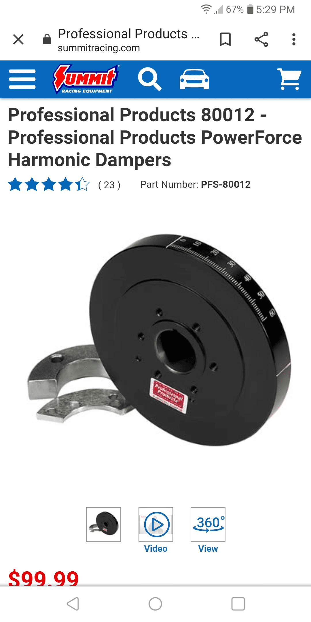

Summit has one for both internal and external balance. Think its called professional products. Looks like an internal balance one but weights bolt in behind it.
Not sure about installing it with cast crank as I would think they are balanced as an assembly. I would re use the old one if its usable.
Like 90$.
Like 90$.
