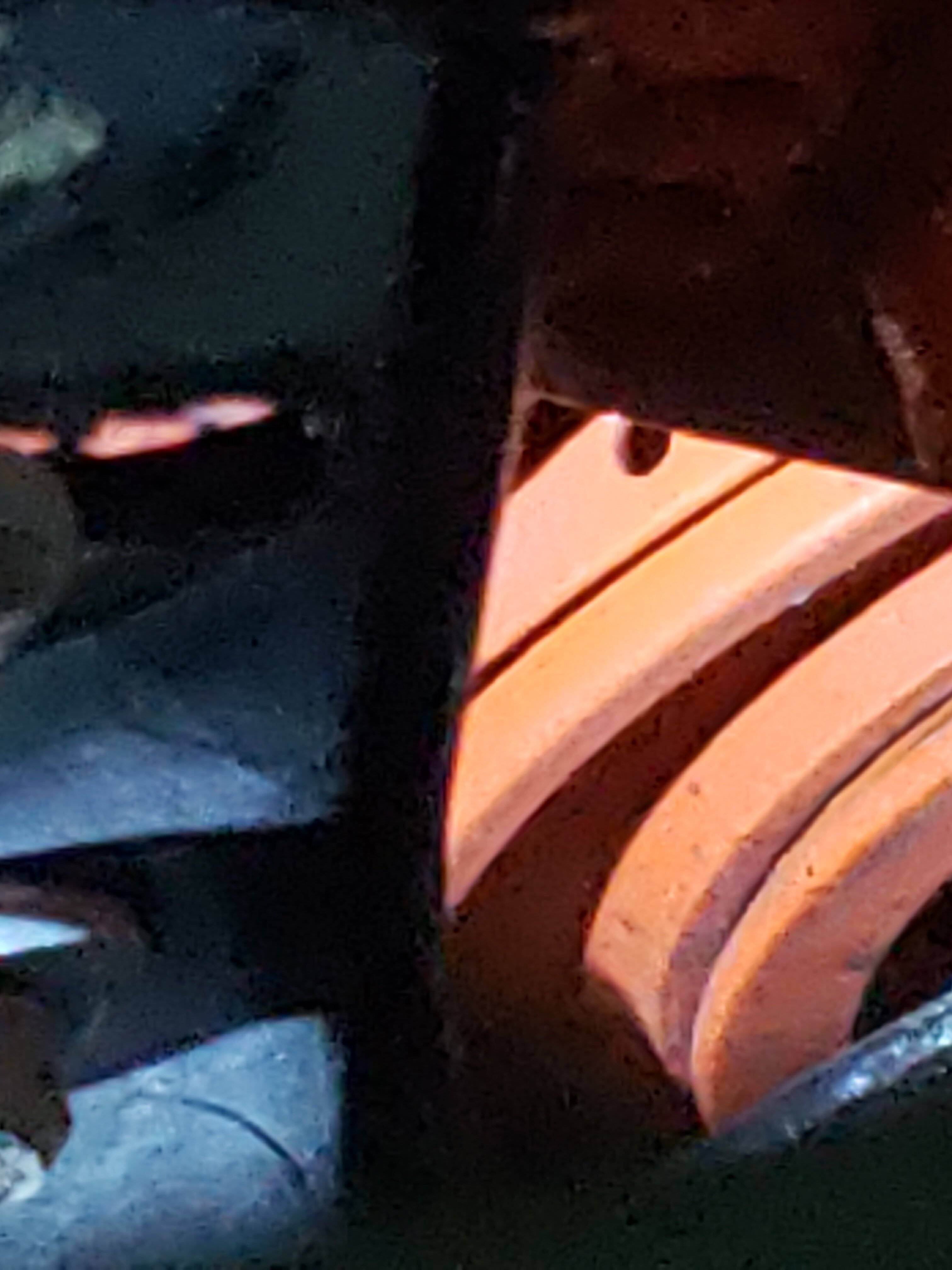

OK So I broke down and bought a timing light. It slightly after TDC. It's now about and I mean about 10* before TDC. Got some degree tape on the way. When you rev it up it sure seems to have a lot of total advance. Here's what I'm working with. Still runs on, maybe a little worse.

You could try 5 more degrees. Is the car running hot? Also, check a few plugs again. Double check idle mixture, and hopefully you don't have some ridiculous setting on the idle speed screw. If you can't get it to behave you may want to bring it to the TDC mark on the dampner and pull the cap off the distributor and verify that the rotor is pointing right at one and not way off, but not yet. If the timing is getting you nowhere, the carb or crap fuel could start to look suspect. Has it always done this? I would look at the timing a while longer, advance it a bit more. Long shot, but it the compression is really high, it could need higher octane. I have a couple cars that would definitely diesel if I tried to put pump gas into them. My boat would for sure. That's a long shot though.
To summarize: This is USUALLY timing. It CAN be carburetor issues and fuel quality/octane. Heavy carbon deposits with glowing red hotspots will cause dieseling. Probably in about this order of probability in your case. If it ran super rich for a long time, the carbon build ups may factor in. You could do the old dribble the water down the carb while you rev it trick if you have any concerns
