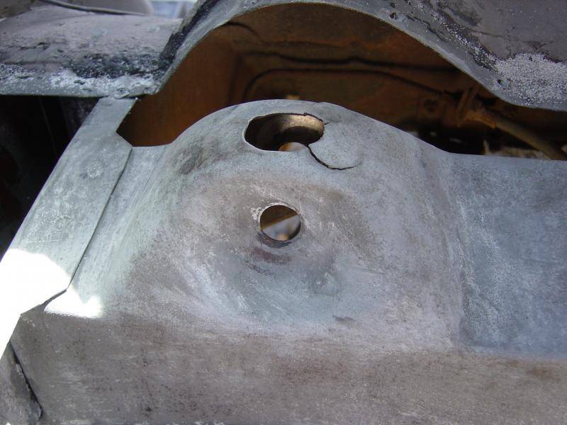

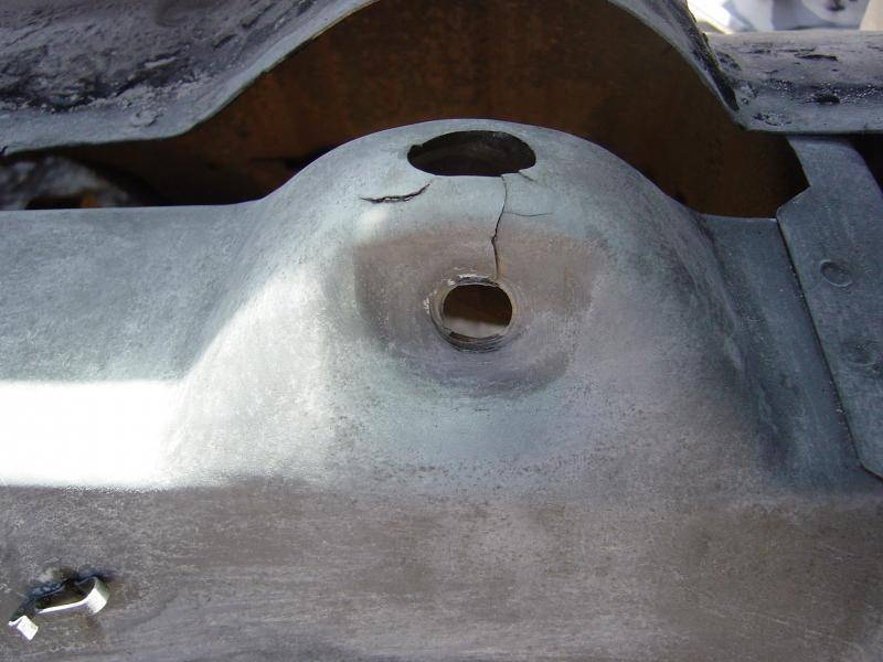

Do not use air shocks; you run the risk of cracking the upper shock mounts. They are pretty thin in these cars, as you can see. These pictures are of my 92,000 original mile 71 Challenger with the trunk pan removed. L shock mount.jpgR shock mount.jpg
