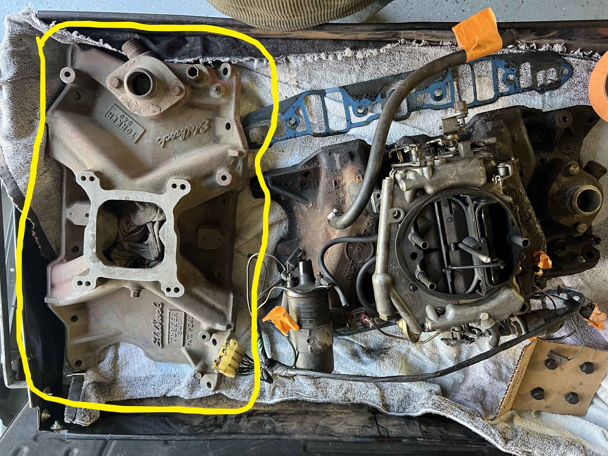

Since I am pulling the engine because of a blown head gasket (I hope from over heating ) I am thinking of replacing the intake manifold on my 1973 Cuda 340
4 speed with a Torker 340. Anyone here installed one? what did you think of it. thanks.

The stock intakes are one of the best other then the weight , if you can find an LD340 grab it !
The Torker is kind of the opposite with the larger plenum & single plane design it is better for higher RPM use .
