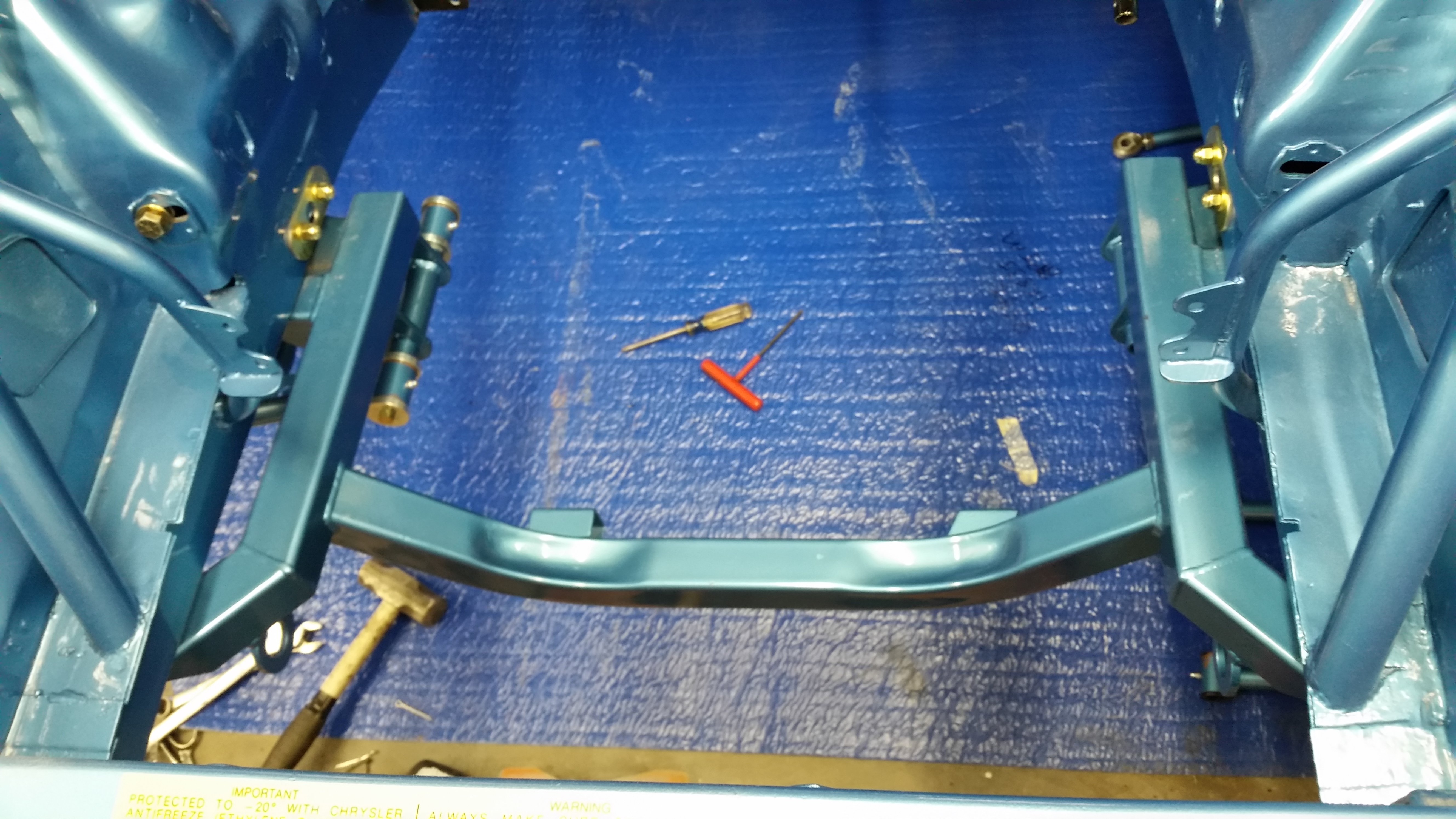

I only installed an AlterKation set up under my blue Challenger because it was basically free to me. Being my car is a street/strip car. It does have many advantages. I can run a larger capacity flat bottom top fuel/funny car type oil pan for ground clearance. More suspension travel. Shaved 125 lbs+ off the front. I was able to weld up my 3 piece Hemi headers as both 1 piece headers with the rack and pinion and I can install them from underneath with the engine installed in less than 10 mins. I can install and remove the engine by myself in about an half hour.
