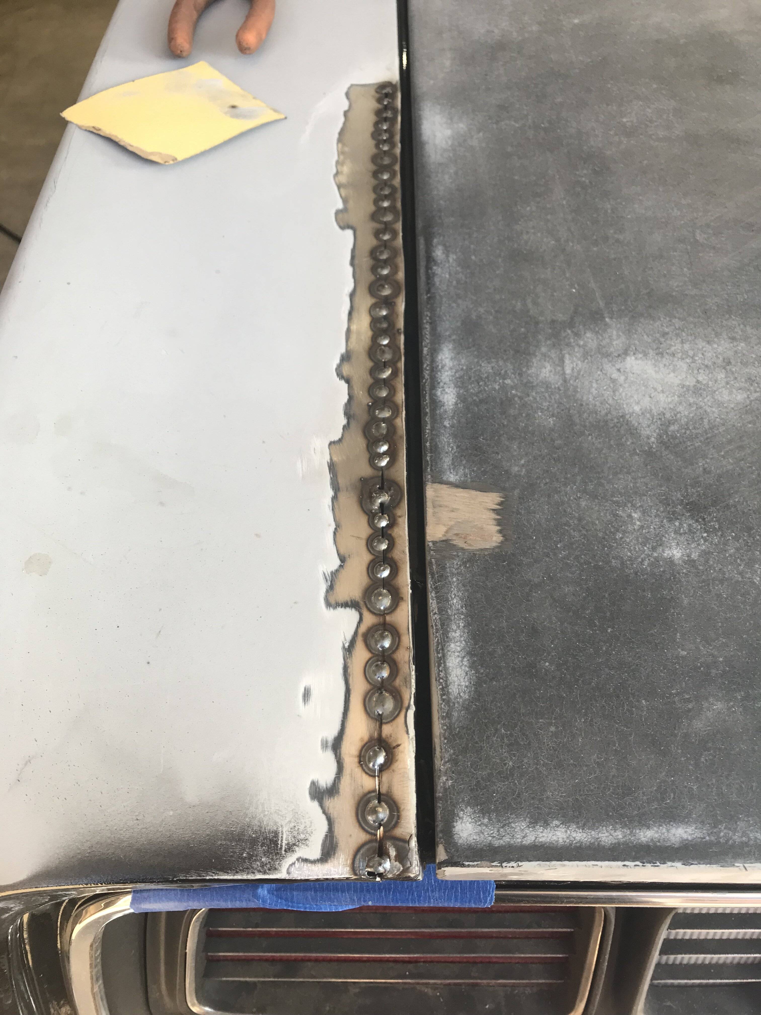

Last fix on my gaps on my 71 BHG. For some reason the AMD driver quarter seemed to not run straight back and I tried to force it out but it just wasn’t budging. Quick pie slice and a little welding seems to be doing the trick. Needed about 1/8 inch at the edge.
