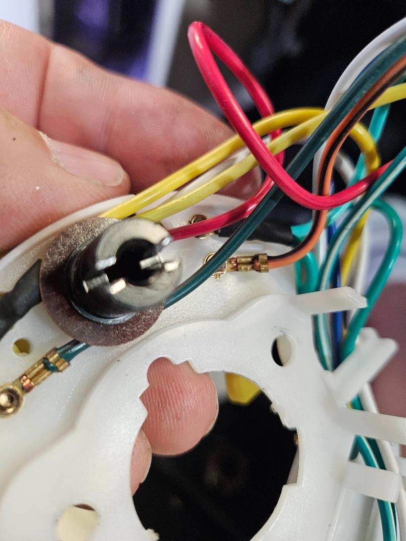

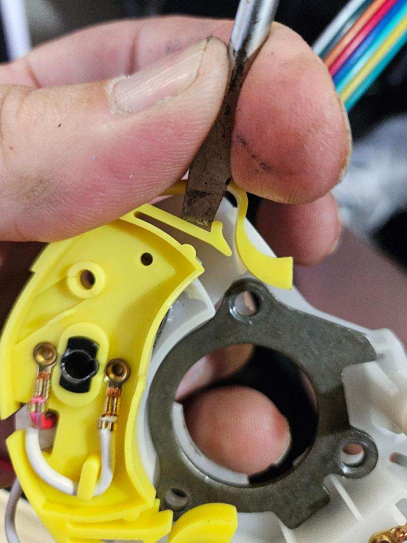

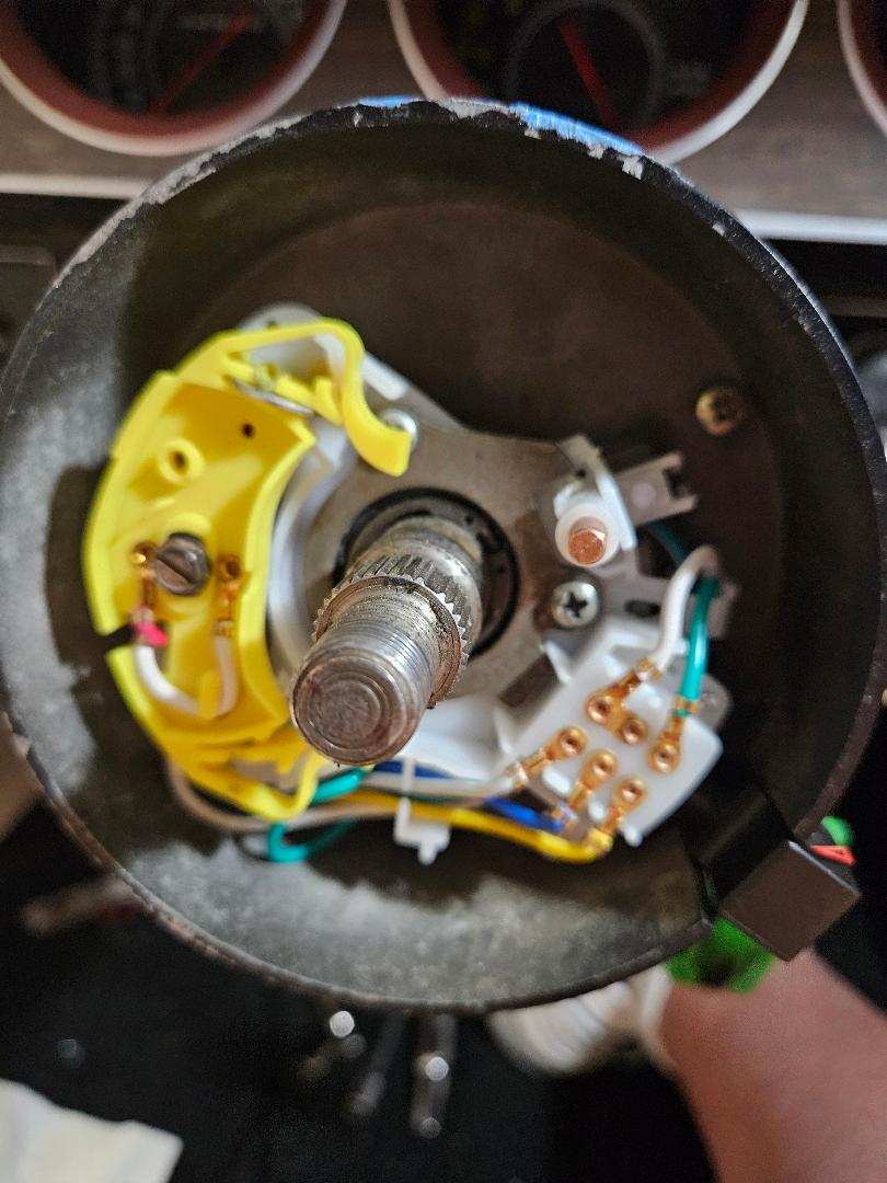

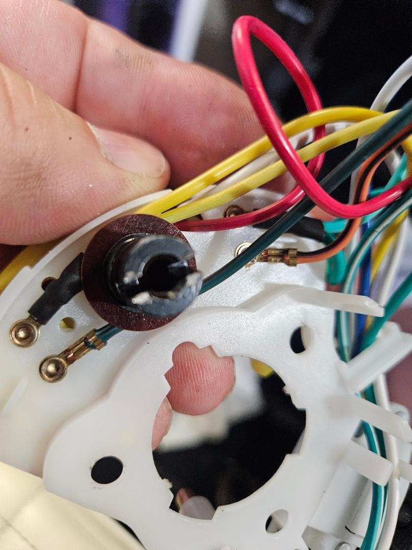

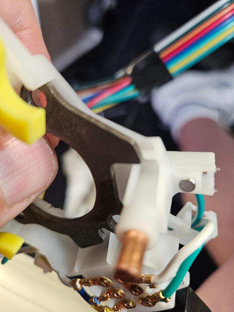

Hey guys.. so just today, I ended up trying to replace my switch in the column. I had bought one from RockAuto (I was ordering other stuff) and what came was a defective switch. The manufacturer is Standard Auto Products and the switch itself looked OK, but it had a significant defect. It was nearly impossible to move the cam (yellow plastic piece) left and right, which engages each turn signal switch. I could hardly move it with my hands until I manually released the little tang (screwdriver touching it in the picture). Once I attached the lever to it, there was NO WAY the lever was going to move it any better than my own fingers doing it. I noticed that each time I moved the cam left and right, the mounting screw would loosen a little bit, which made it impossible to trust it not coming loose in the column. So, I modified the little tangs to take some pressure/tension off the things and it worked for a while, but after about 10 times back and forth, one of the tangs ended up breaking off and I was back to square one. The metal washer/retaining ring also didn't fit properly, so I ended up having to shave some of the white frame to get it to fit also (see pics). So, now I'm looking at different manufacturers. But it seems like ALL of them come with a yellow cam now, so they might all be the same. Beware of trying to use this item, because it will end up damaging/wearing down your turn signal lever if left unchecked. Hope this helps someone!
I thought about trying to do that, but in order to pry the cam off the old one and put it on the new one I think I'd do more damage to the plastic than it would help.. Plus you've got to transfer the wiring over as well of that cam.
CORRECTION: Not Standard Auto, but Skyward Auto Products.. see picture.

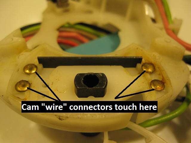

I have a 54/55 year old 1970 switch that I wanted to keep because the flasher button uniqueness and still works great. It was taken apart and thoroughly cleaned, burnished the brass contact rivets, slightly bent the cam's "wire" connections so they'd make good contact, shrink wrapped a couple frayed wires and greased moving parts.

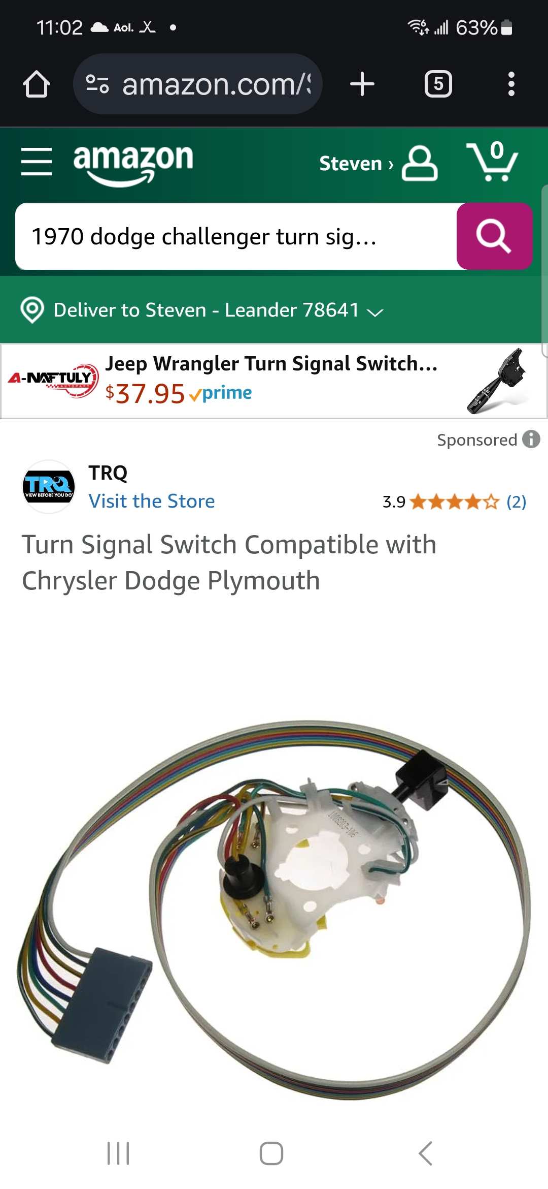

Reporting back.. the last one I ordered was from a seller called AM Auto parts on amazon. I'm pleased to say, the cam moved without too much effort. But I also chose to file out the bottom of the cam, so that the turn signal lever fit more snugly when the screw was tightened, and that seemed to help quite a bit.
Oystercopy, I tried to find the turn signal switch on Amazon sold by AM Auto parts, but failed to find it. I was hoping to post a link for others who might need one. Could you post a link? Thank! And glad you found something that works!

For some reason, amazon wouldn't let me copy the link to the actual webpage. But this is the same part made by the same manufacturer
The Manufacturer was TRQ
Hopefully this link works?
