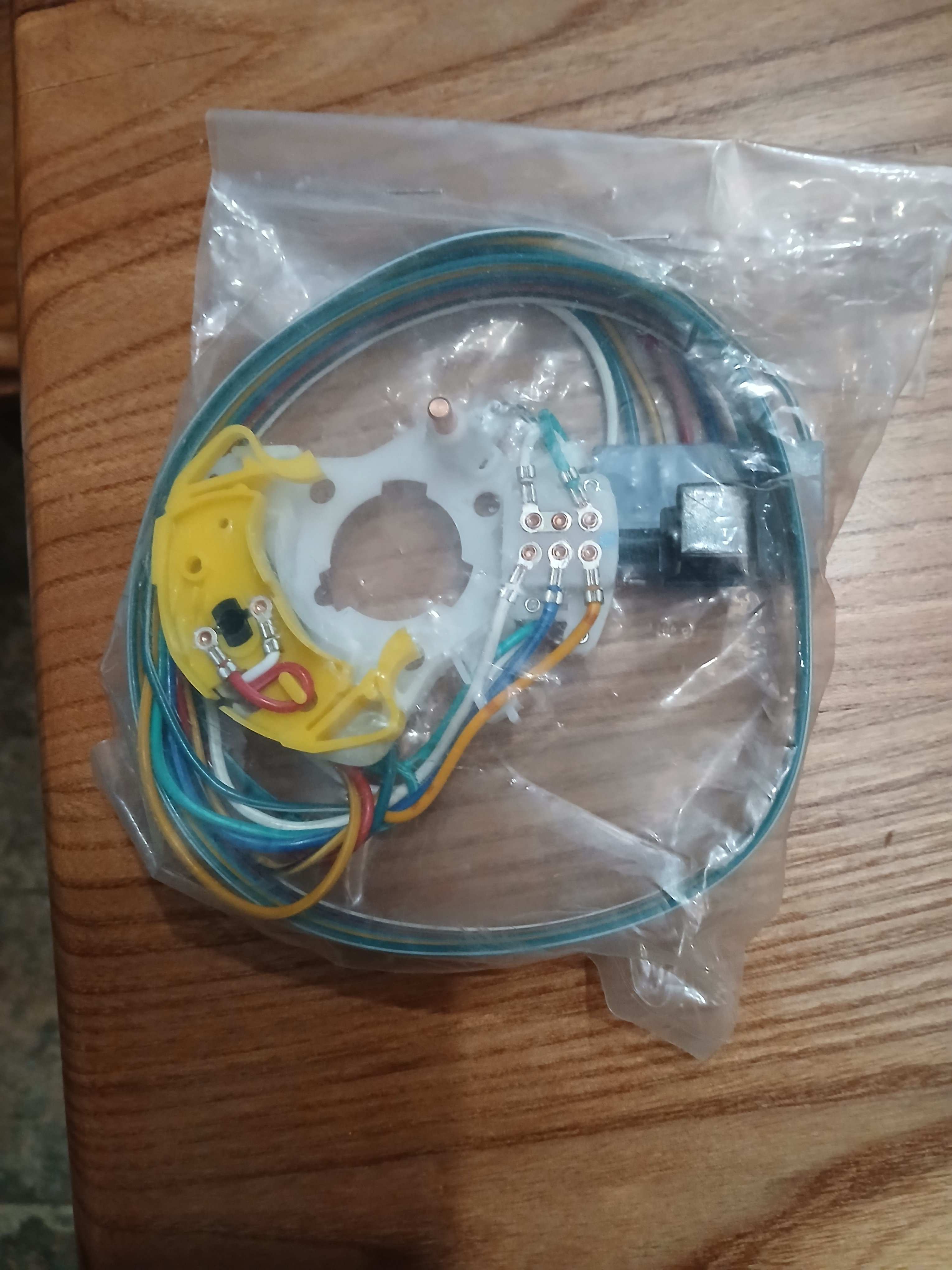

Jan 31, 2025 #1 K KennyCuda Well-Known Member Joined Aug 3, 2020 Messages 404 Reaction score 54 Does anyone make a turn signal switch for a 1970 Cuda that doesnt have to be modified to fit, all the ones I see the flasher knob is to large
Jan 31, 2025 #3 K KennyCuda Well-Known Member Joined Aug 3, 2020 Messages 404 Reaction score 54 so do you cut the knob to fit or take the old knob and put it on the new part

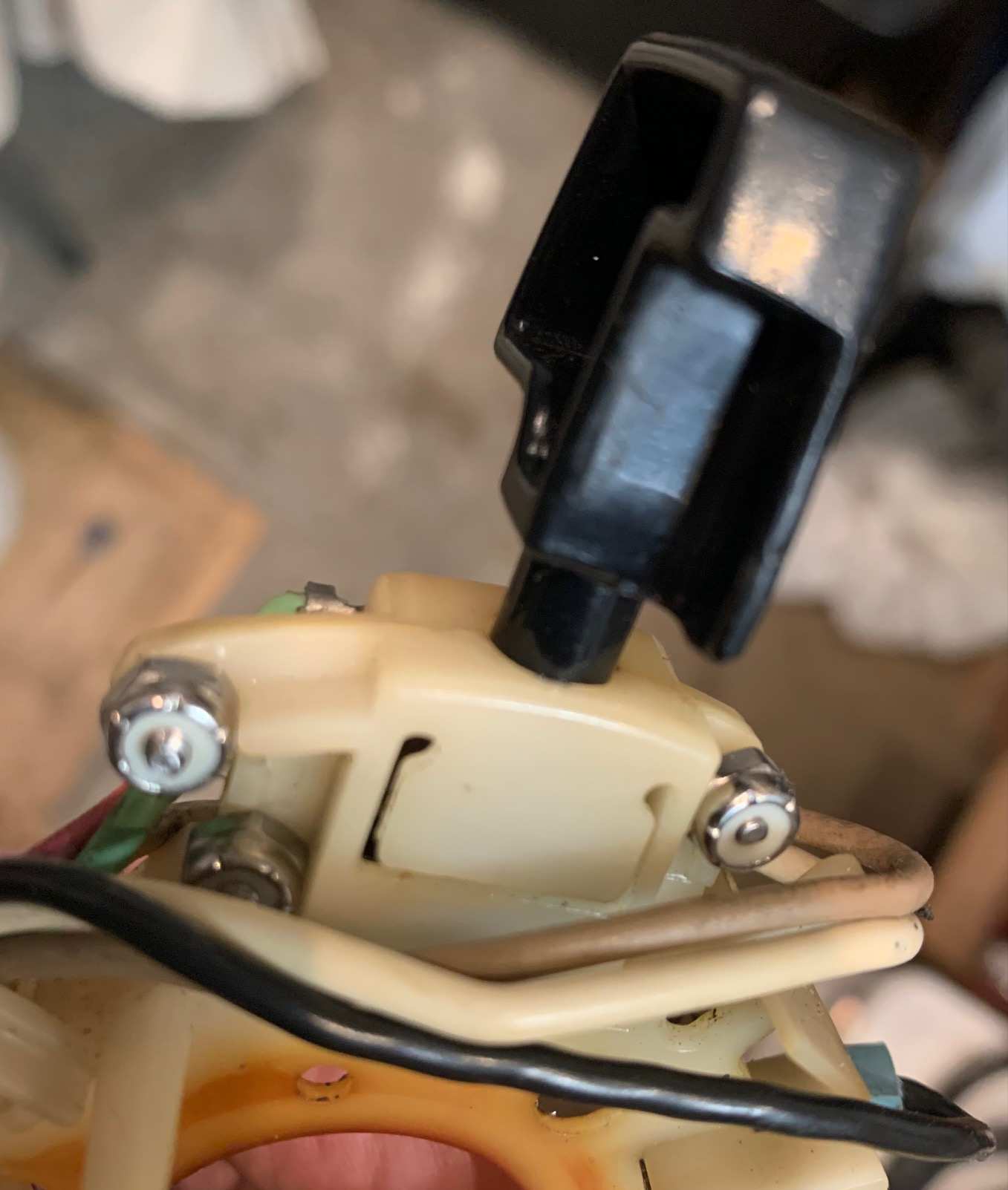

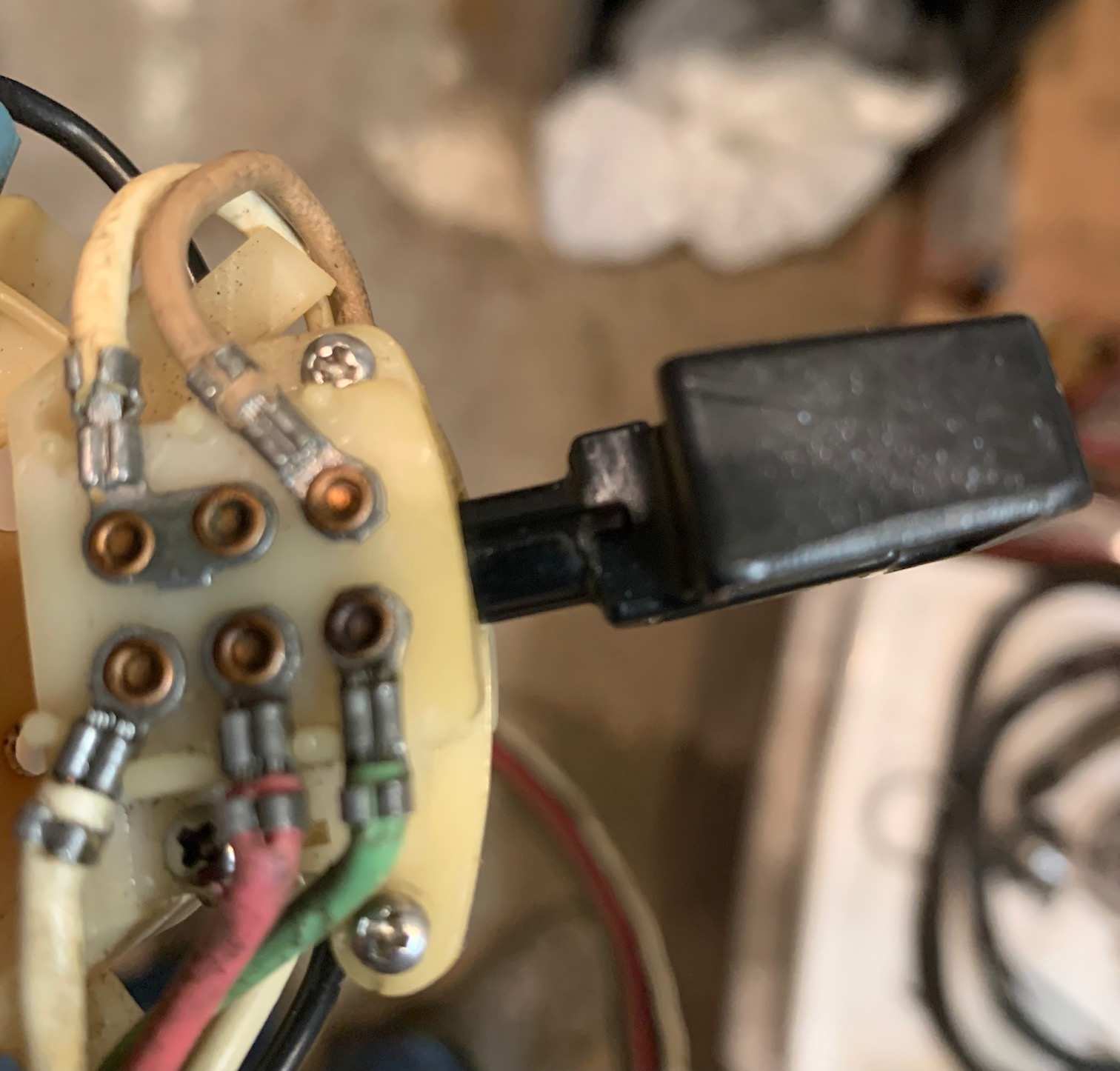

Jan 31, 2025 #4 EV2RTSE Well-Known Member Joined Dec 13, 2013 Messages 410 Reaction score 264 You can do either, I prefer to take the old knob out and swap it to the new switch. It's not too bad to do. Drill out the 3 little rivets holding it together, and put it back together with tiny screws and nylon lock nuts.
Jan 31, 2025 #5 EV2RTSE Well-Known Member Joined Dec 13, 2013 Messages 410 Reaction score 264 Here's a few pics.
Jan 31, 2025 #6 K KennyCuda Well-Known Member Joined Aug 3, 2020 Messages 404 Reaction score 54 thanks so much --you really helped me out Last edited: Jan 31, 2025
