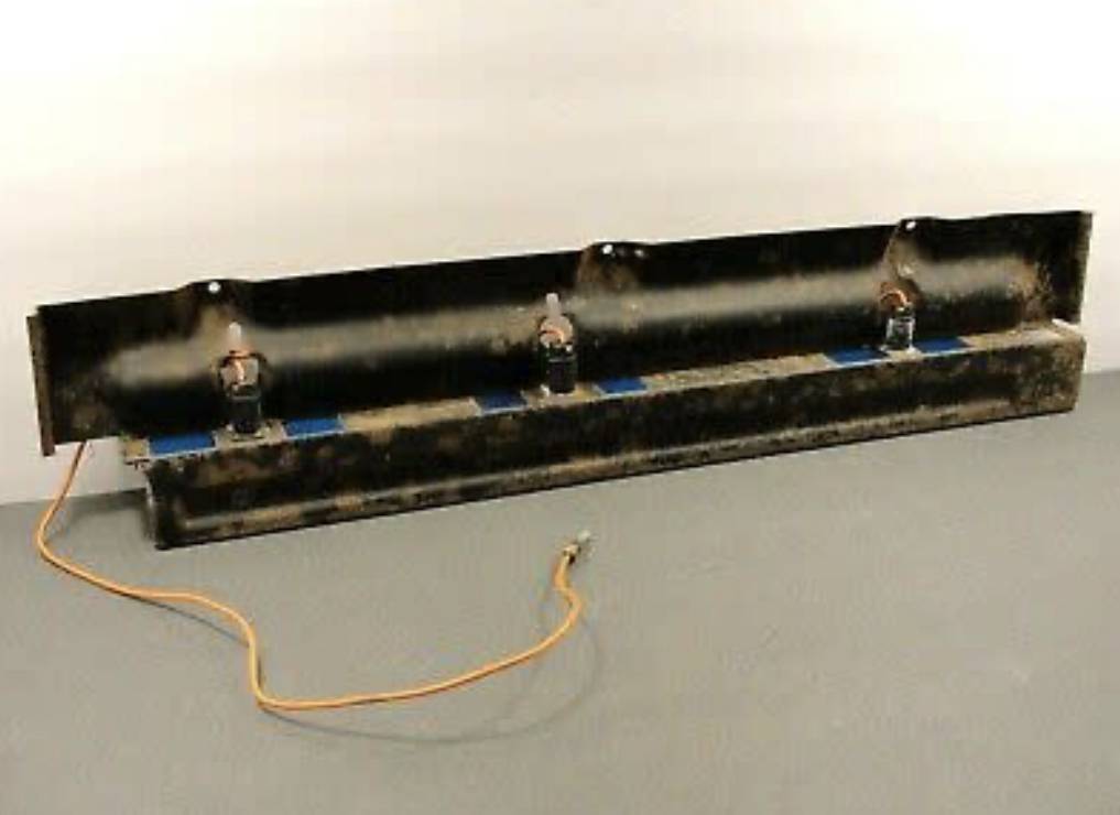

What are these three holes for? This is for a 73 Chally.

Down lights for illuminating the dash.
You have a 3-light bar yet a rallye dash uses a 4-light bar.

It is a Rallye dash and car. Mine has three lights behind the blue plexiglass plates and one at the end that has a blue bulb enclosure. I guess the plate is always the same, just used differently depending on which dash?

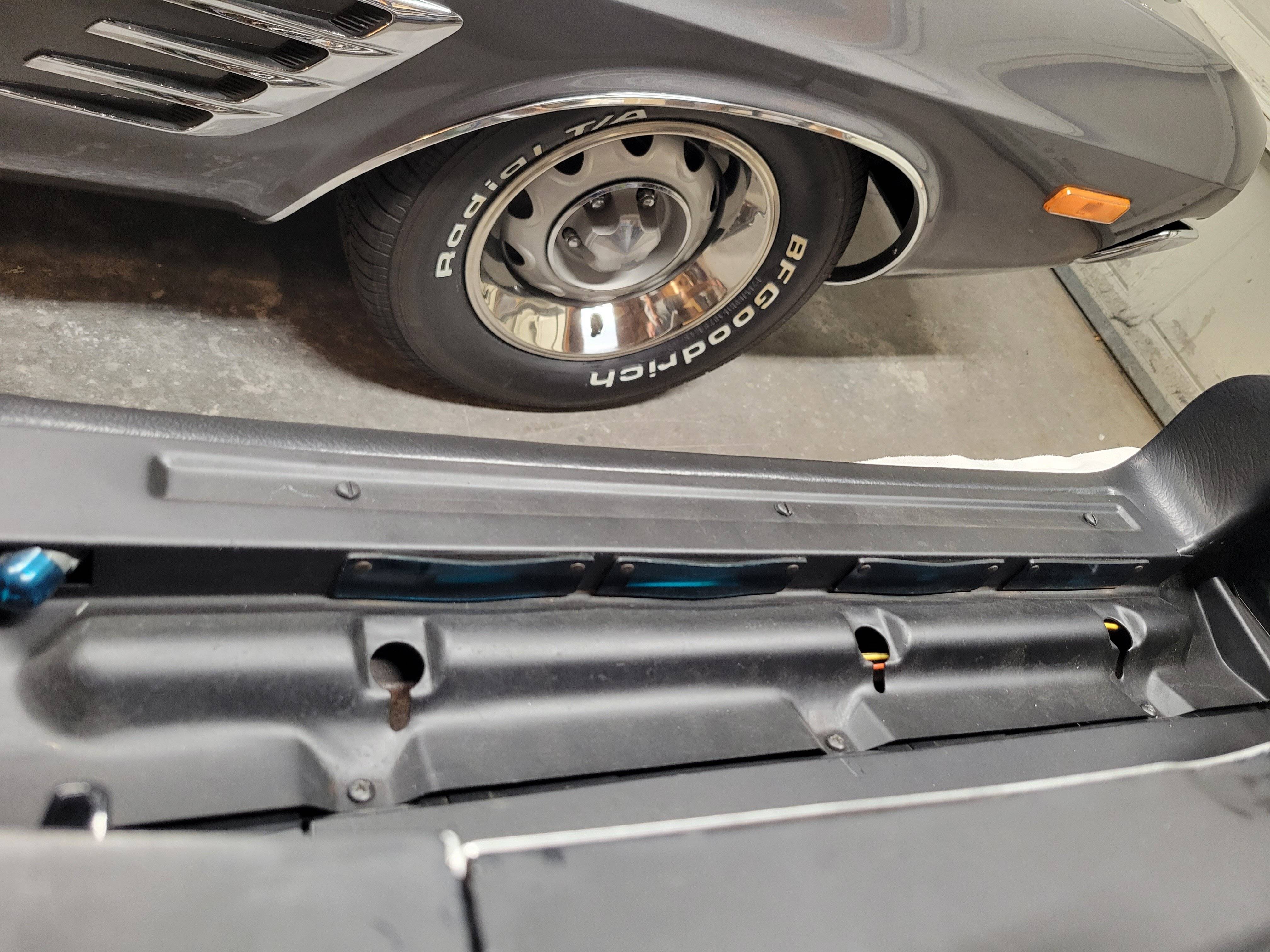

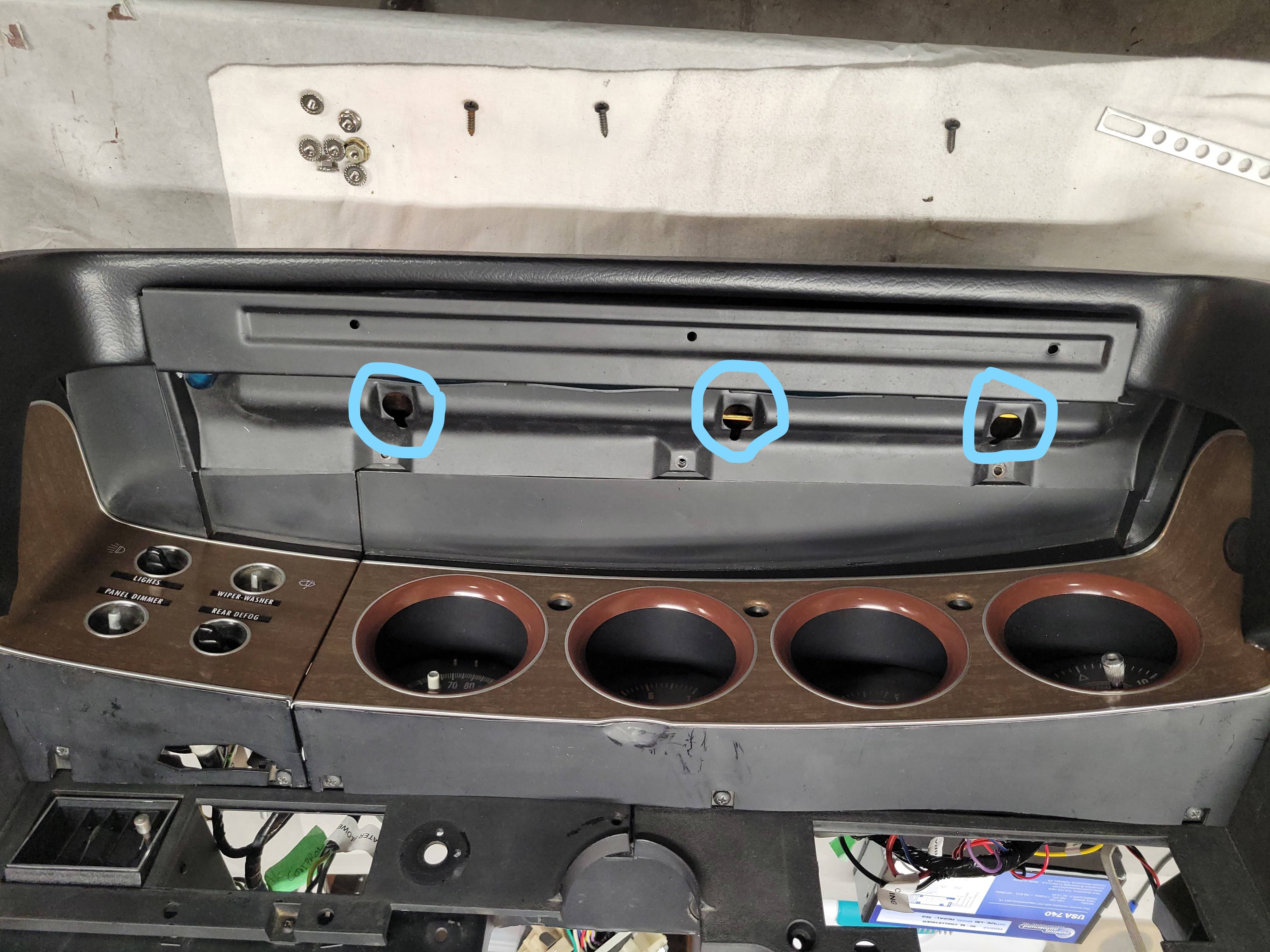

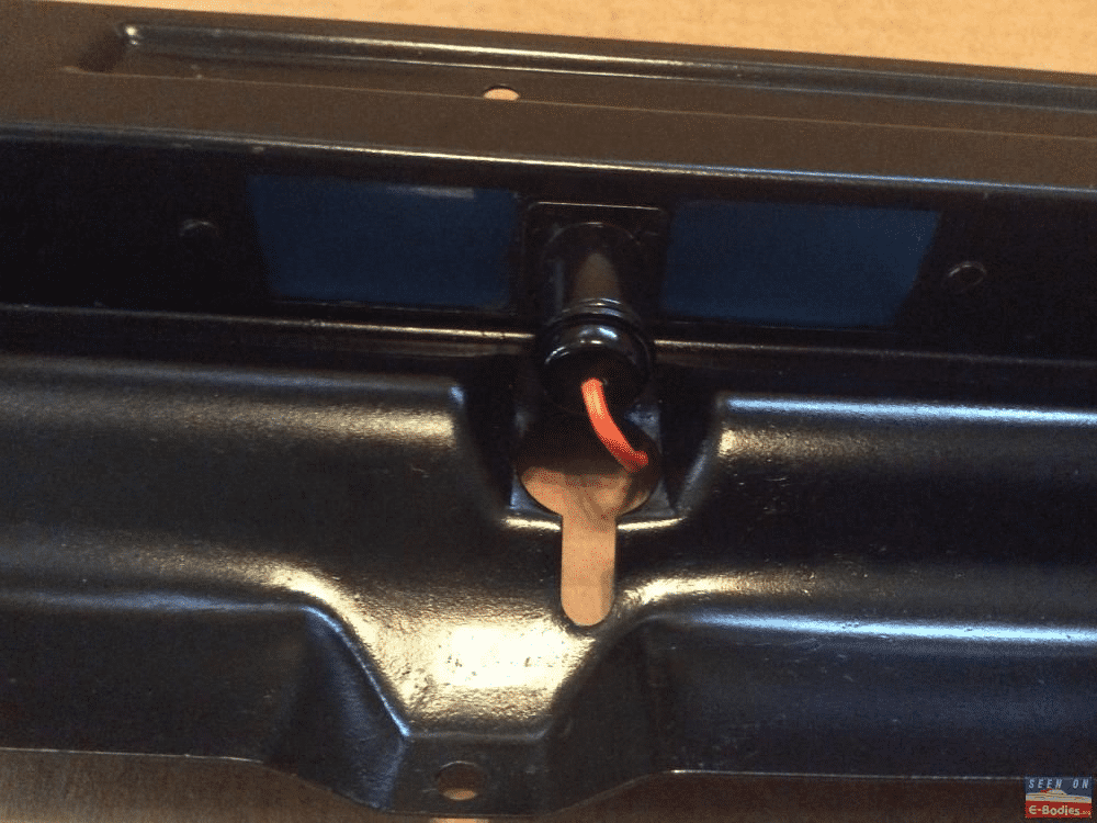

There’s a few wrong answers here. Those holes are for the standard non rally cluster. The rally cluster has the lights hidden behind that cover, if it were a standard non rally cluster the light sockets would be accessible through those three holes. First picture rally dash, second picture non rally.

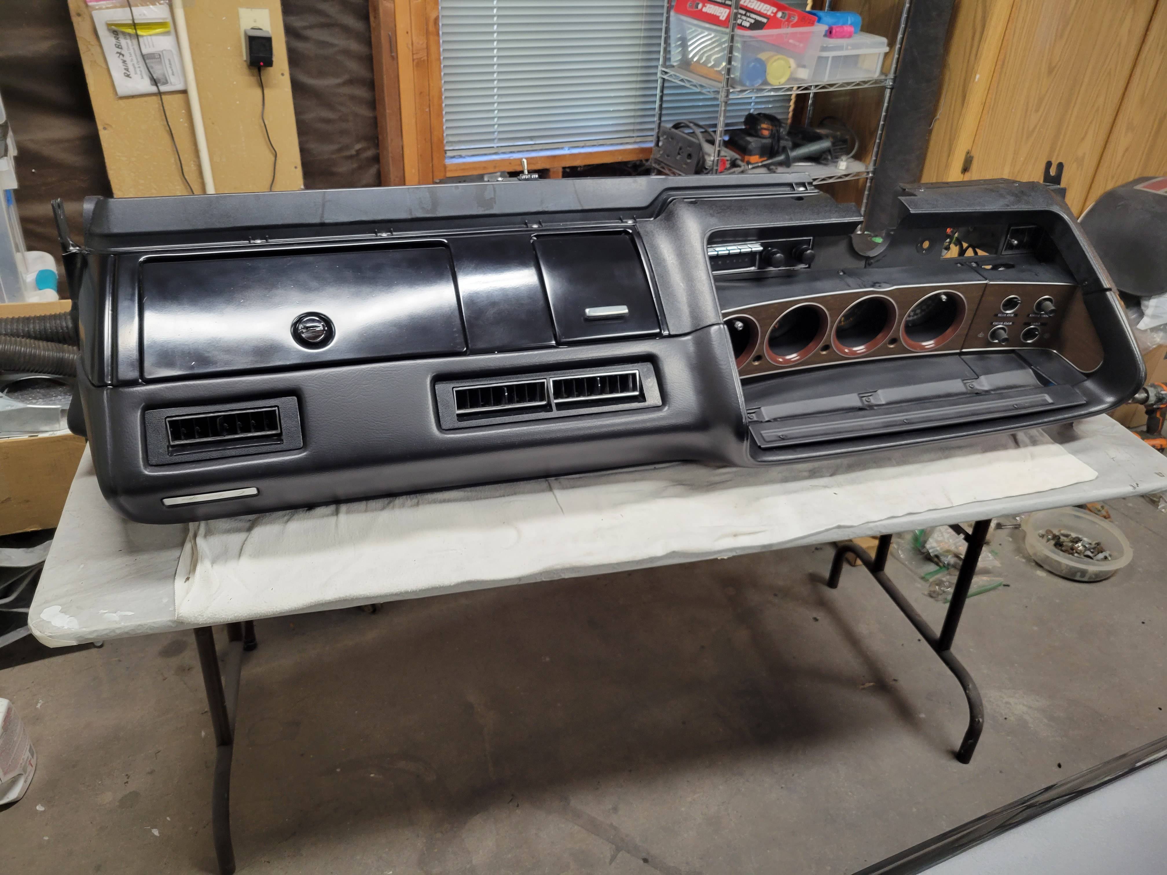

What are the wrong answers in the thread?
OP was told he had the wrong light bar for a rallye dash application and the holes in the wrong light bar (which he asked about) allows the lights to pass thru.

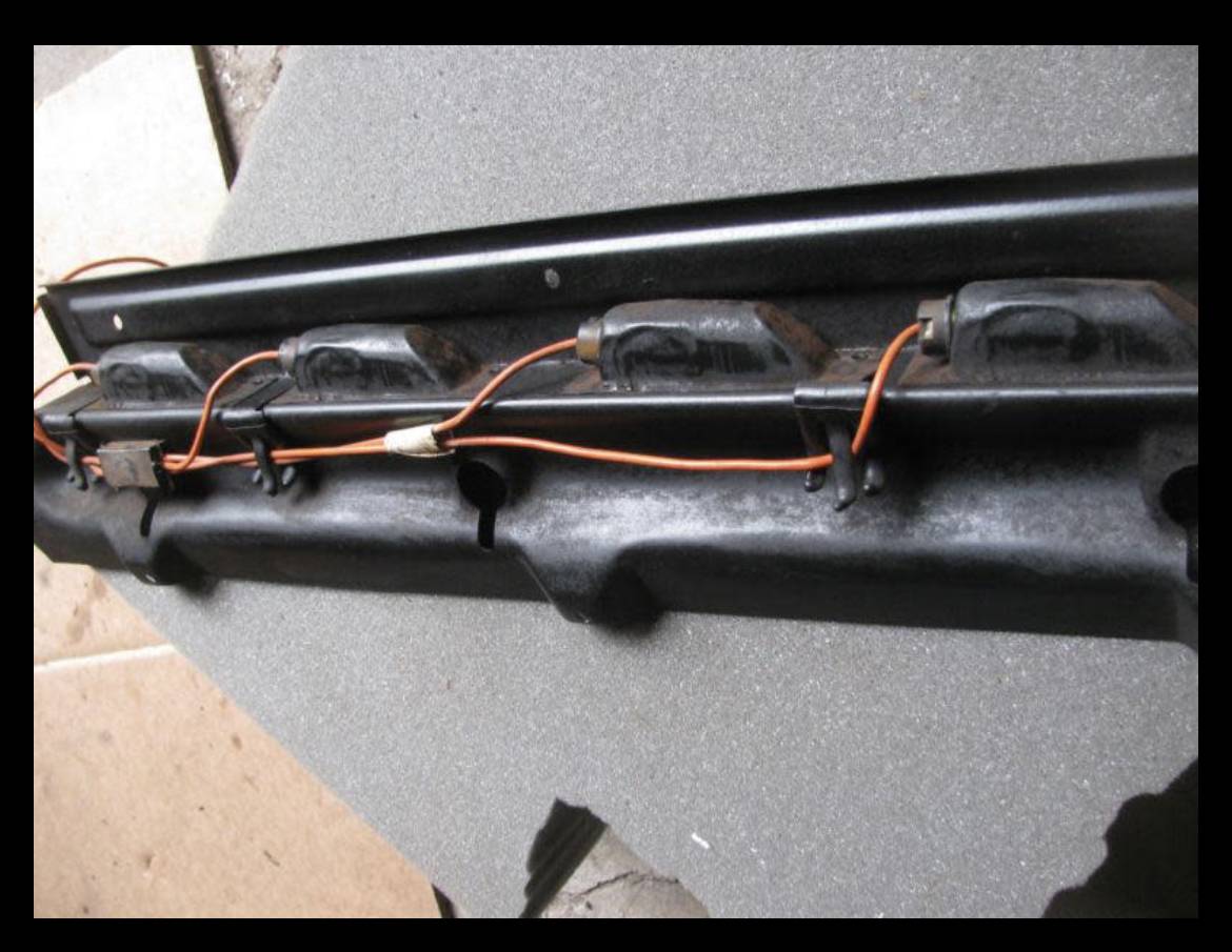

Here is a better photo of the panel. I have the four blue plastic lenses with a bulb behind each one, not going though three lenses. This is a Rallye car and what seems to be a Rallye dash, including this light bar. Correct or incorrect?
