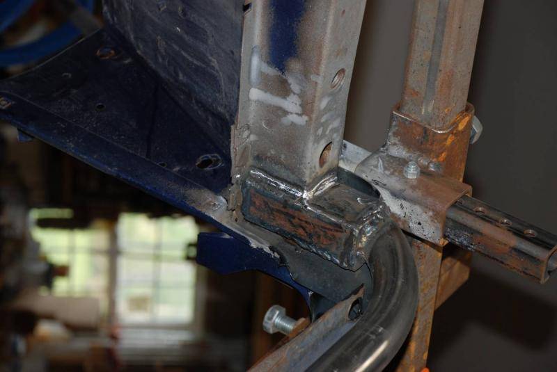

Core Support 50% Reduction.jpgI have one of the older ones. They shipped mine without the 2" extension blocks. I called them up and they said they would ship them and they never did. I welded my own in and cutout where they pass through the old support.
