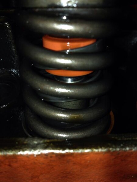

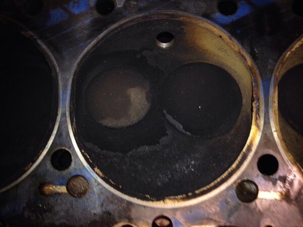

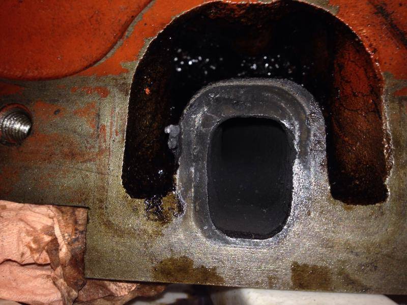

image.jpgimage.jpgimage.jpgThx! :) The reason I did the test is that I have problem with oil on my sparks plugs! I just take off the cylinder heads! And I find that the intake manifold didn't have any gaskets and the bolts we're lose... And the heads have a hole/cavity in the center that's connects with the intake! And in the hole it's was a lot of oil? And the valve seals seems just sitting on the top ov the valve? Wouldn't they be fixed... Any ideas where the oil comes from? I hope you understand my writing... My English isn't so good!

Looks like a lot of carbon on the valves. Oil gets splashed on the back of the intake when the motor is running. Without a gasket, oil may have been sucked up into the ports by the intake valves. The valve seals may be bad also. Are the valves seals hard or soft?

Thanks again! It seems like that was what happened! I can't see any other explanation! And I notis that the cylinder heads is milled! I guess that the angel were to join the intake with the heads do not match or align!

You know, it does help to tell us what you are really looking for than to say you are checking one thing but you are really looking for the answer to something else. It can save time on both sides. The hole in the center of the heads is for heat crossover to warm the fuel in the manifold when cold for better cold weather performance. Does nothing for you after the engine warms up. Intake gaskets are made with and without the port opening. Unless the car is used in cold weather a lot it is best to use the gasket that blocks the port. The compression test will not show the problems that you have, so was a waste of time. Since you did find that things on this engine were not done correctly, it would be safe to assume there are more problems waiting for you. Tear it down or cross your fingers.,

Ok really. Does oil on the spark plugs and compression test sound the same in any language ? Anyway, Some common tips. Photograph every thing before disassembly and during. Bag up and label all parts as they are removed. Try to stay on one problem at a time. A common mistake is to get too excited and take everything apart and now just have a pile of parts. Focus. Sounds like the previous owner probably had another intake manifold on the engine and put the old one back in a hurry. Missing gaskets and loose bolt are a clue. He might have hurried other work too, so it is good to recheck everything.
