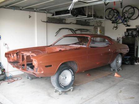

PICS
Finally figured out how to resize.
In the process of cleaning the undercarriage and rear suspension.No rust,a little dirt,not much undercoating.Lots of work though.Scraping and sanding by hand.I live in a home owners assoc so have to keep the noise down.It is Ok ,I will no every square inch of the car when done.

Oh Man does that look great! What is the build date on that car? Can't remember from the original thread if that was said. If it's early, I may have something you'd be interested in.
Just went back to my resto thread where we figured out your car was #s matching and I think your car is early judging by the casting date on the engine. Check your fender tag for the build date and post it up.
Again the paint looks great, let's see some close ups.
