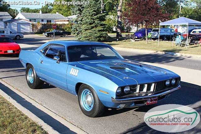

Agreed, get rid of the air shocks. New rear springs will help with the stance. A place like ESPO sells springs with overarches for a little more forward rake. My springs are 1" over. Adjust the T bars for front height. 15" wheels will give you the classic look.
