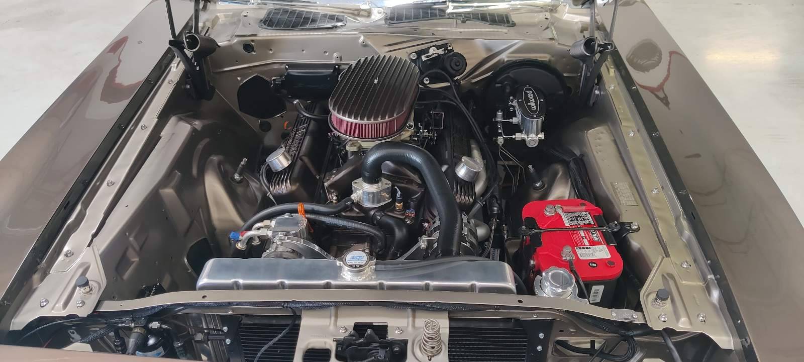

I recently purchased a 1972 Plymouth Cuda that has been restored. The car is numbers matching and has the original 340 ci engine. There is a Holley Sniper fuel injection on the engine. The a new Holley vented gas tank was installed and the Holley w/ internal fuel pump has return line from the Sniper to the tank. Recently, after driving the car in hot weather I heard a high pitch sound coming from the gas cap and when opened there was a lot of pressure. Once relieved I put the cap back on and I could hear a trickling noise in the tank. Open the cap it stops, put it back on and it continues for several minutes. My cap has pressure or vacuum on the inside. I ordered a replacement but it hasn’t come yet.
Any help will be appreciated.
