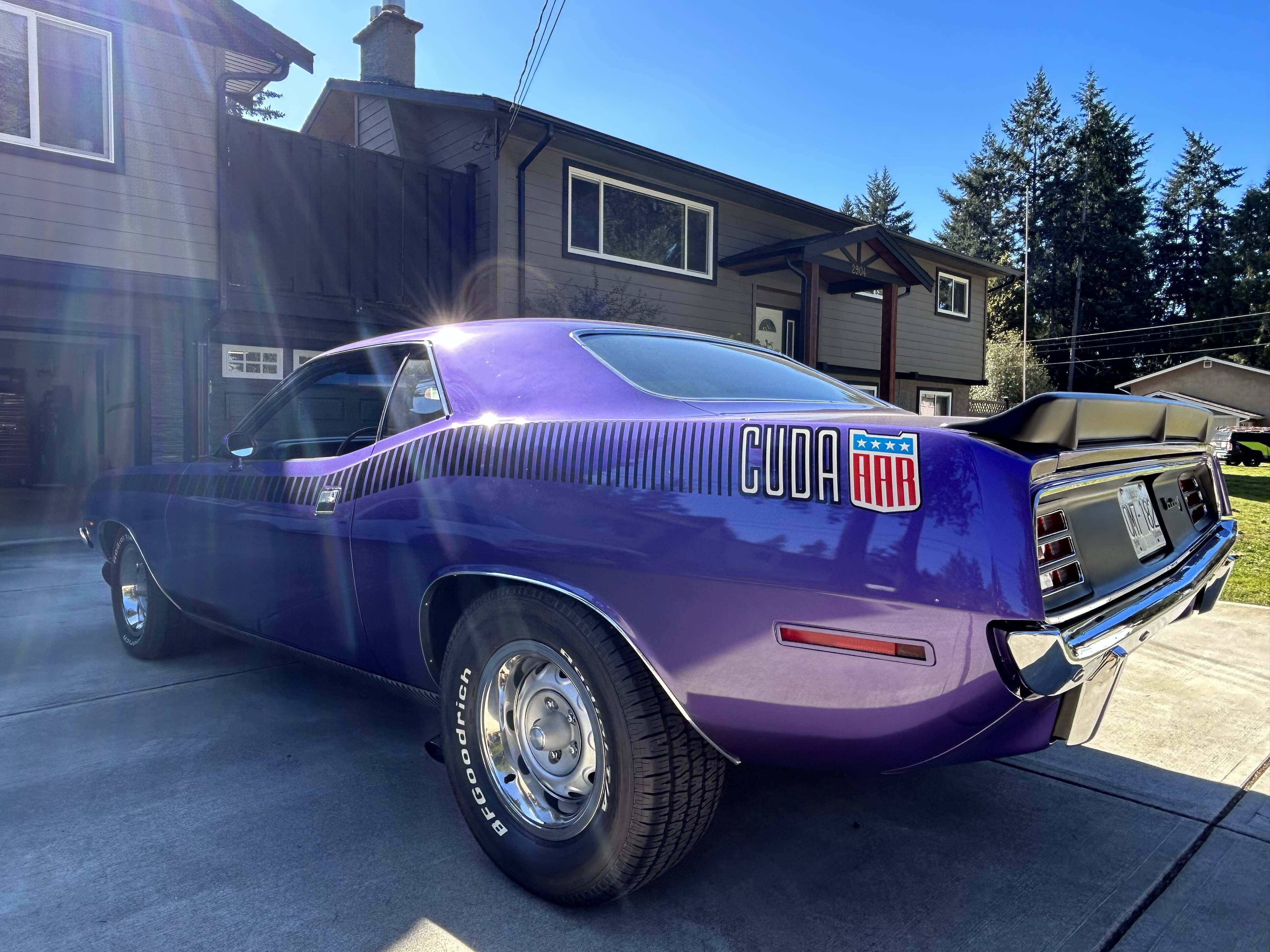

Hi im new to this group I own a fc7 AAR 4 speed , I saw a previous post on vented gas caps , my car needs cranking after sitting awhile don’t believe it has the correct gas cap, this is the same issue as the other members post but it didn’t have his results after putting on the correct vented cap, any ideas ?

Welcome to FEBO from the desert!! Very nice looking AAR Cuda! And a great color too!
It should crank over and fire up with the correct gas cap no problem.
