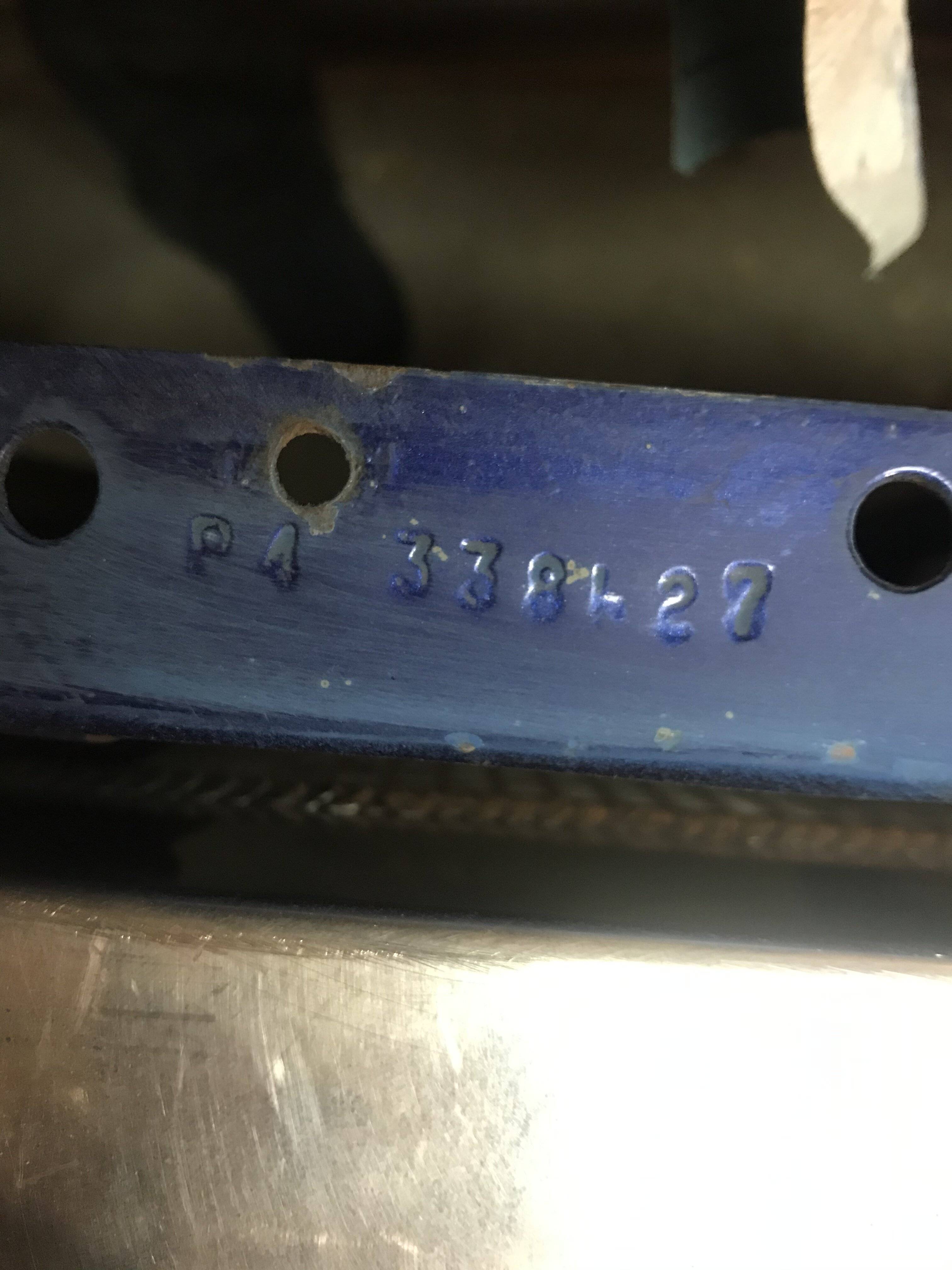

Hey everybody. Was trying to decide the vin on my challenger today. I can’t find the 13 digit number anywhere but there is an 8 digit one stamped on the cowl and radiator support. It reads p4338127. Not sure exactly what everything means maybe one of you guys could help me out? The p might be an r which means it has a hemi (yeah!!) but that didn’t exist in 74. I was told the car was a 72 when I bought it. Any help is appreciated.
thanks

well, that stamp is indeed your vin number. Looks like it's a 74 due to the 4 stamp. I'm unfamiliar with the P though.
That vin stamp will only be on the radiator shroud and the cowl. If you have the original motor and trans you will probably find the vin tamp on them Other than that, door tag, fender tag, vin tag build sheet or window sticker.
Does the car retain any of these?

Nope it has nothing else than what I posted there. The dash isn’t factory, no build sheet or paperwork or anything. The p is weird I couldn’t figure it out either

Your "P" is a mis-stamped B, indicating a Hamtramck build.
B = Hamtramck
4 = 1974
338_27 = Sequence number
The engine code doesn't appear in the cowl/core support stampings. Assembly plant, year, and sequence number were all the law needed to determine if a car was stolen or fraudulent. In 1974, a P engine code indicated a high-performance 400, also known as "Engine Not Appearing in E-bodies". The 318 and 360 were the only engine choices in 1973-'74.

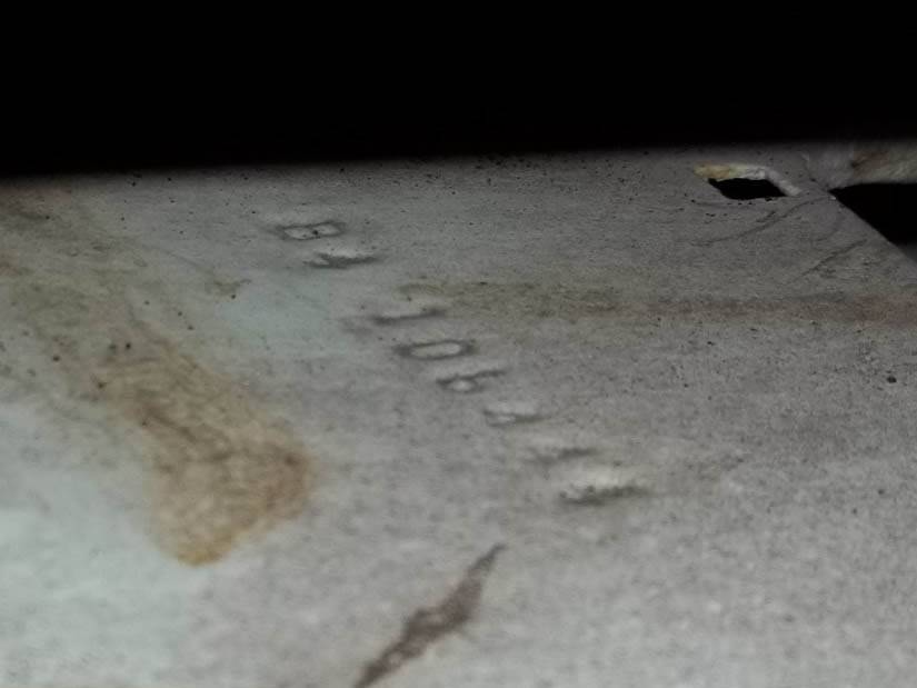

Here's the cowl stamping from my '74 318 (VIN G) car:

Regarding what the original 13-digit VIN is, there are only two possibilities:
JH23G4B338627
JH23L4B338627
They were all JH23s, they were all 4Bs. You have the sequence number, so the only digit open to queston is the engine code. A 318 car has a G in position 5, while the high-perf 360 would have an L.
I'm assuming that mis-stamped digit in the sequence number is a 6, based on what that numeral looks like in my own cowl. You could do a title search in your state, or some other state in which you think the car may have spent some time. If you come up with hits on one of those VINs--both can't exist--you've found your car. Depending on your location, a title could be nearly impossible... or it could be fairly painless. My car came from a "no title" state (Alabama). Getting a title in my name was a freakin' cake walk, since the car was not stolen. They never even wanted to look at it.
