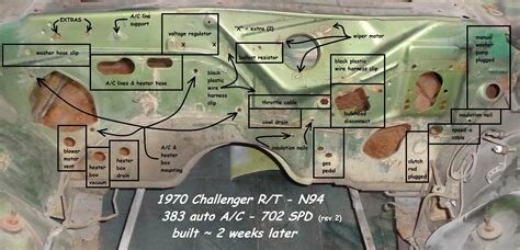

If you have an A/C car use it. use the A/C components inside or find them.I think it would make sence and cost effective. The componants under the hood are the one that wear.buy new. I have seen under hood component kits. If need be a good A/C shop can make up lines to a desired length and get the components you need. The only thing might be finiding the A/C bracket pulleys you need. the others advice I would say is good. An A/c firewall should look similar to this one.

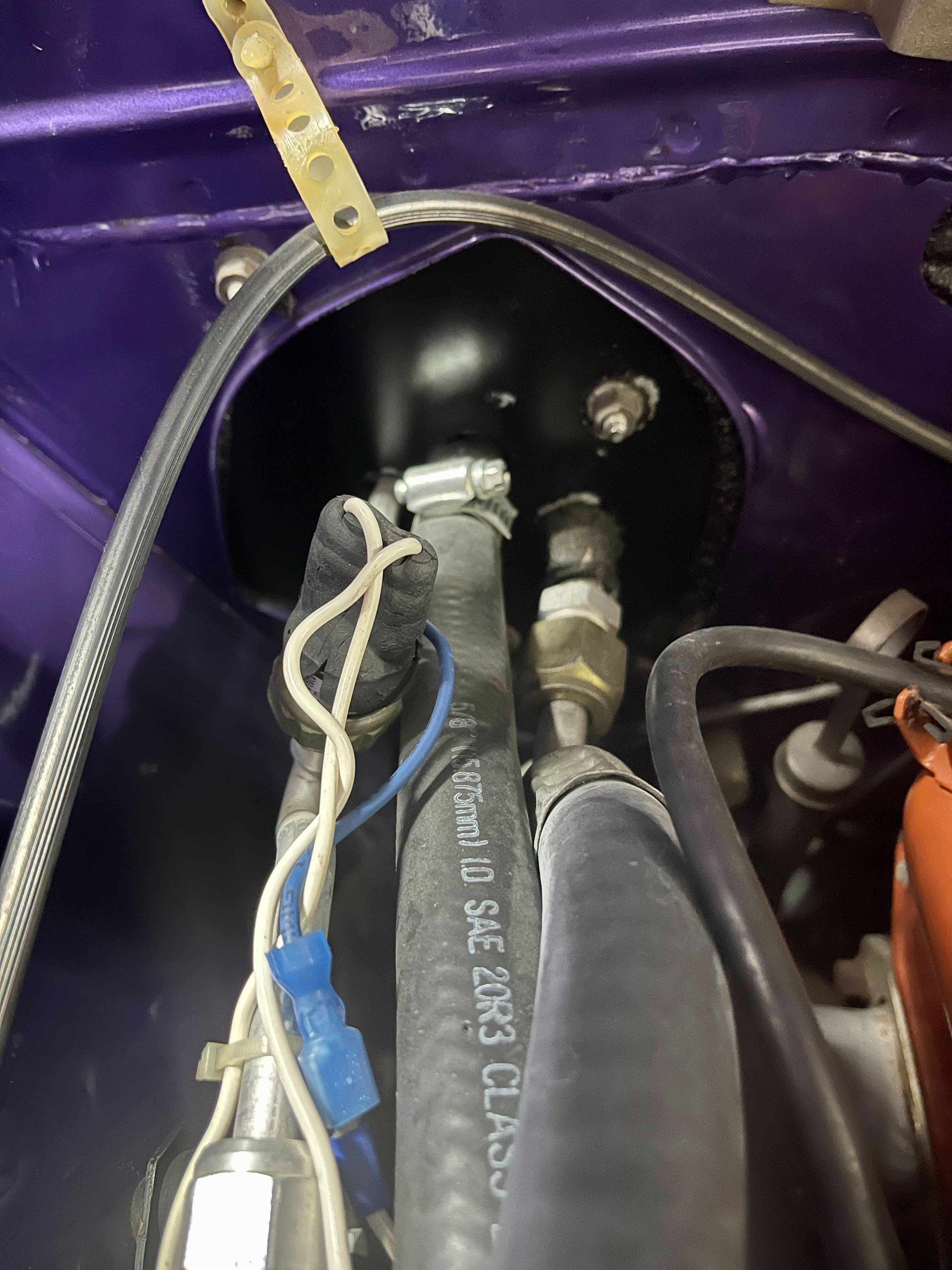

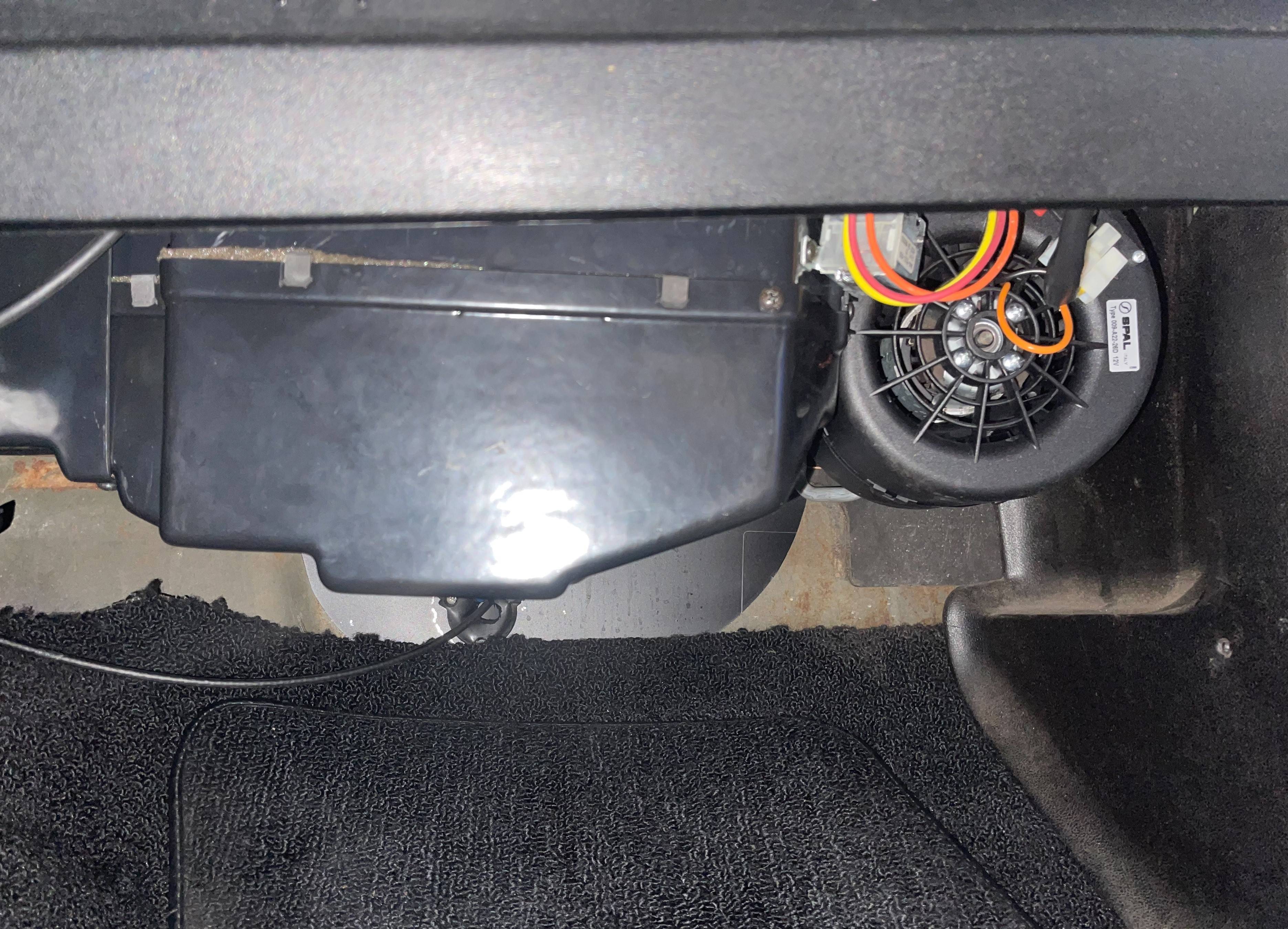

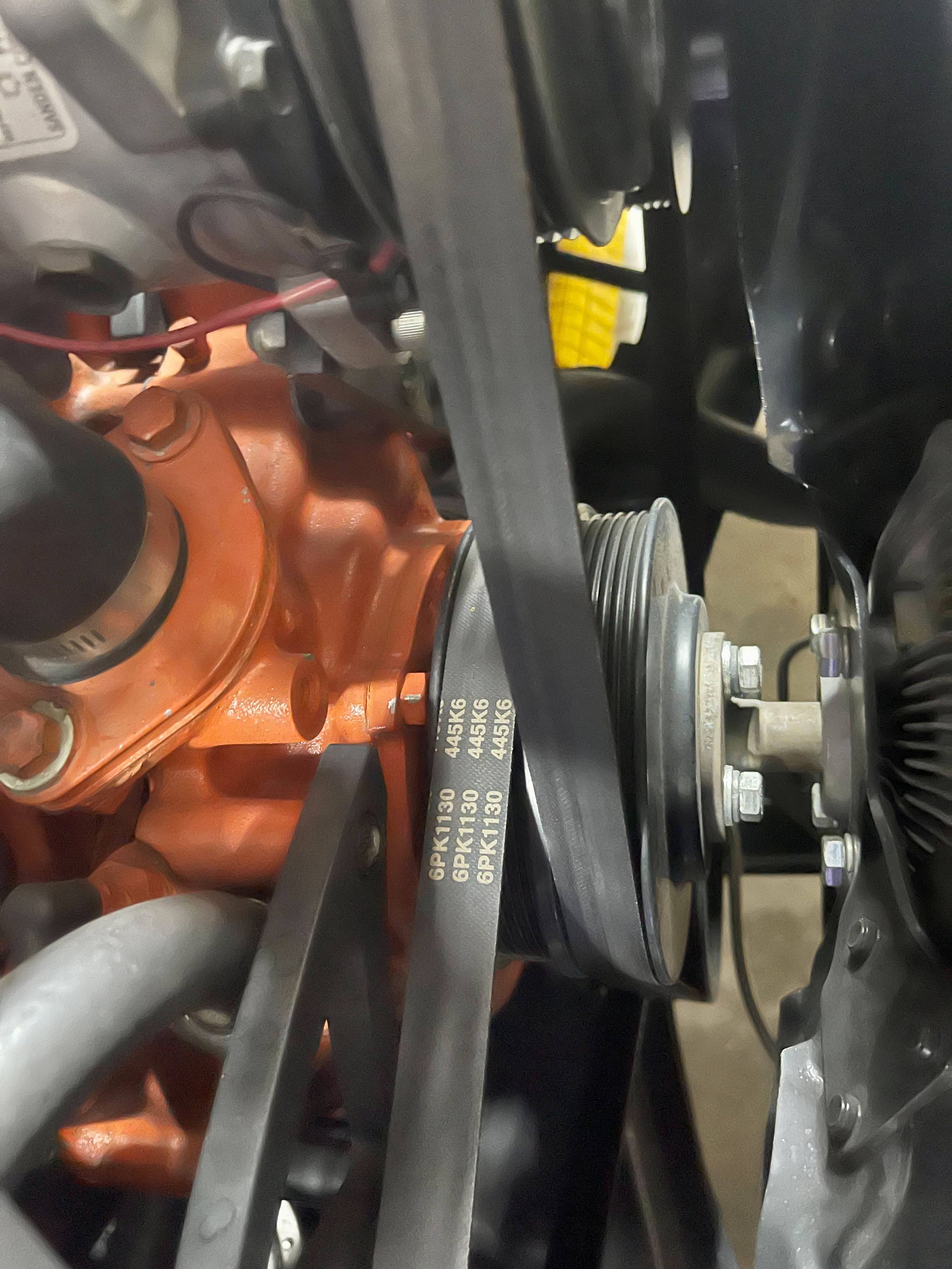

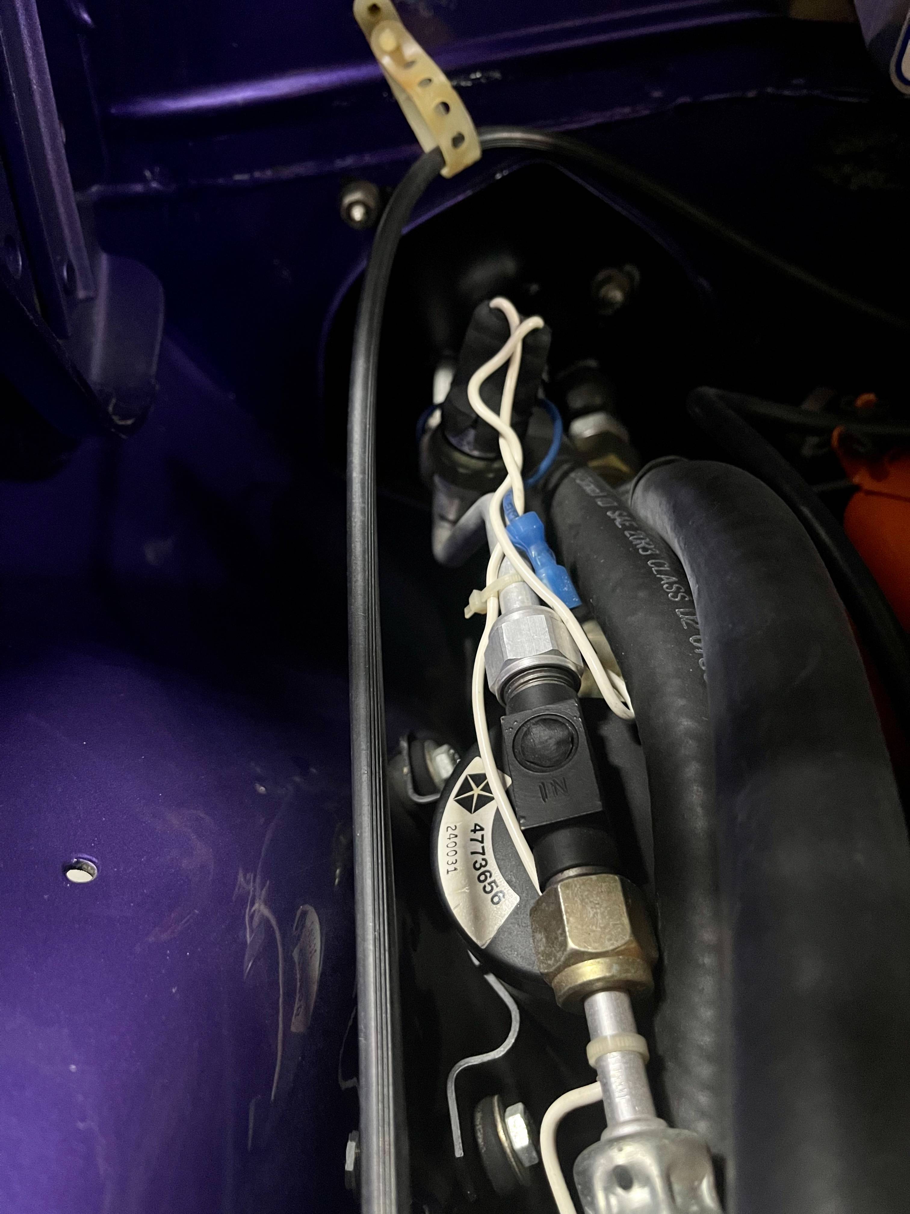

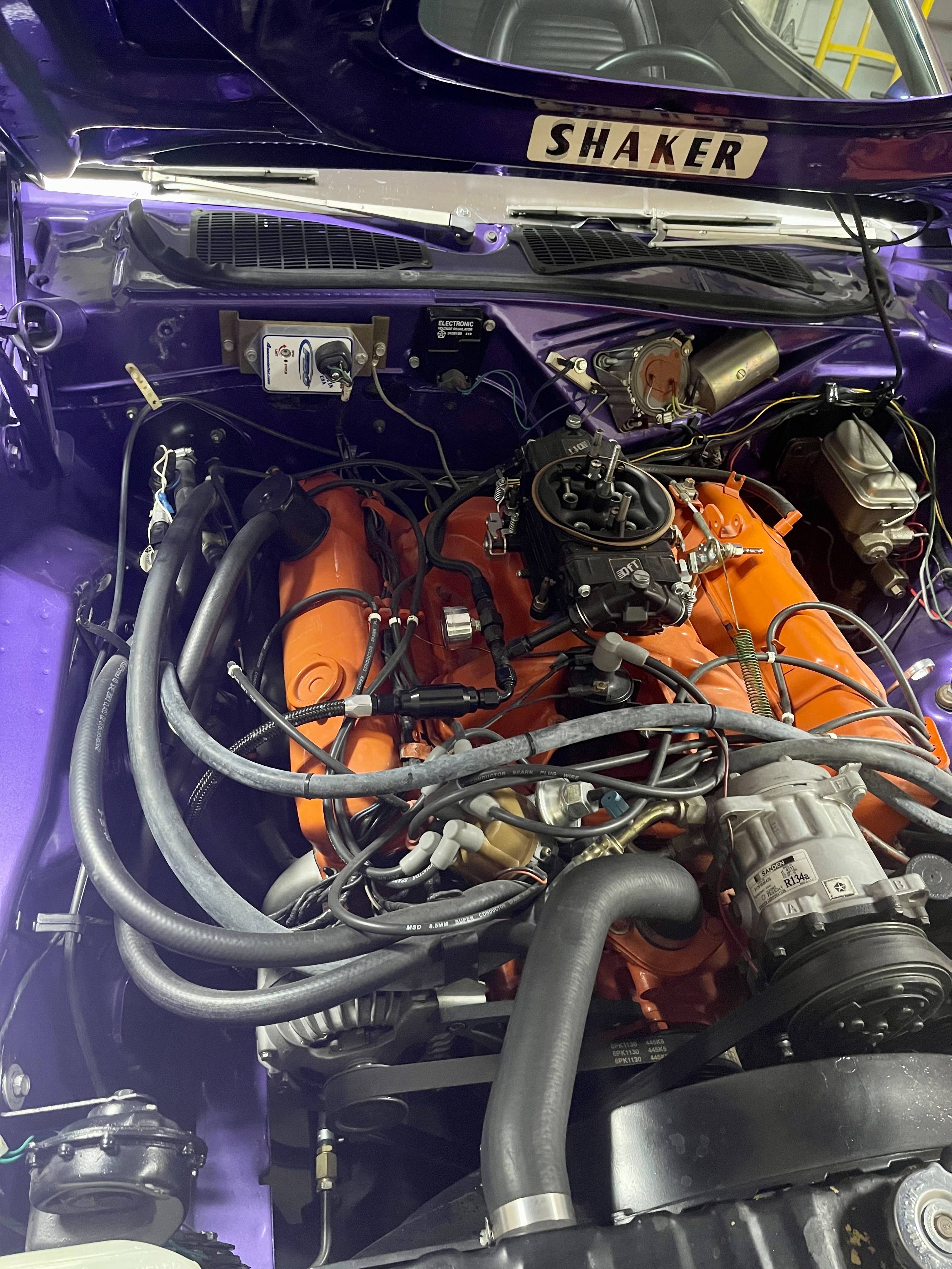

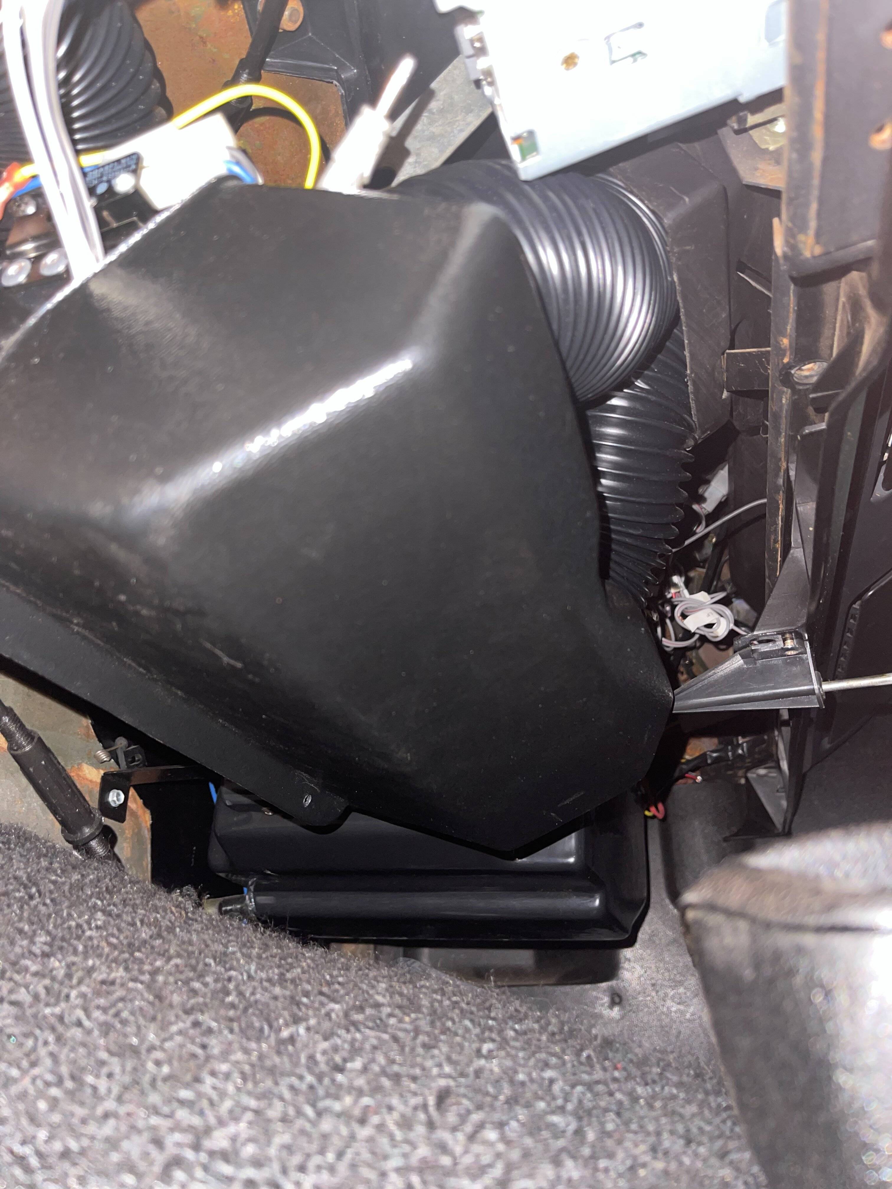

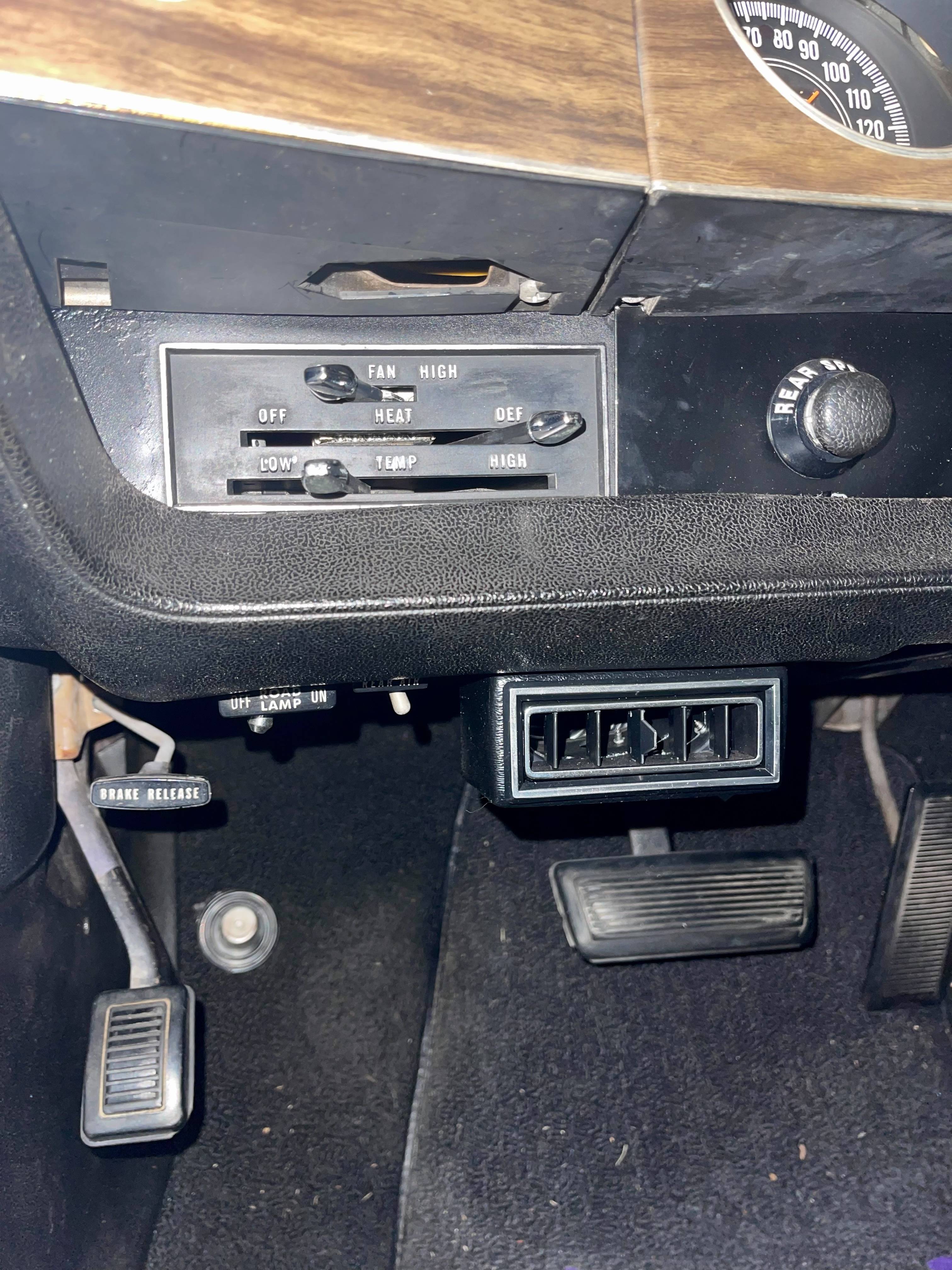

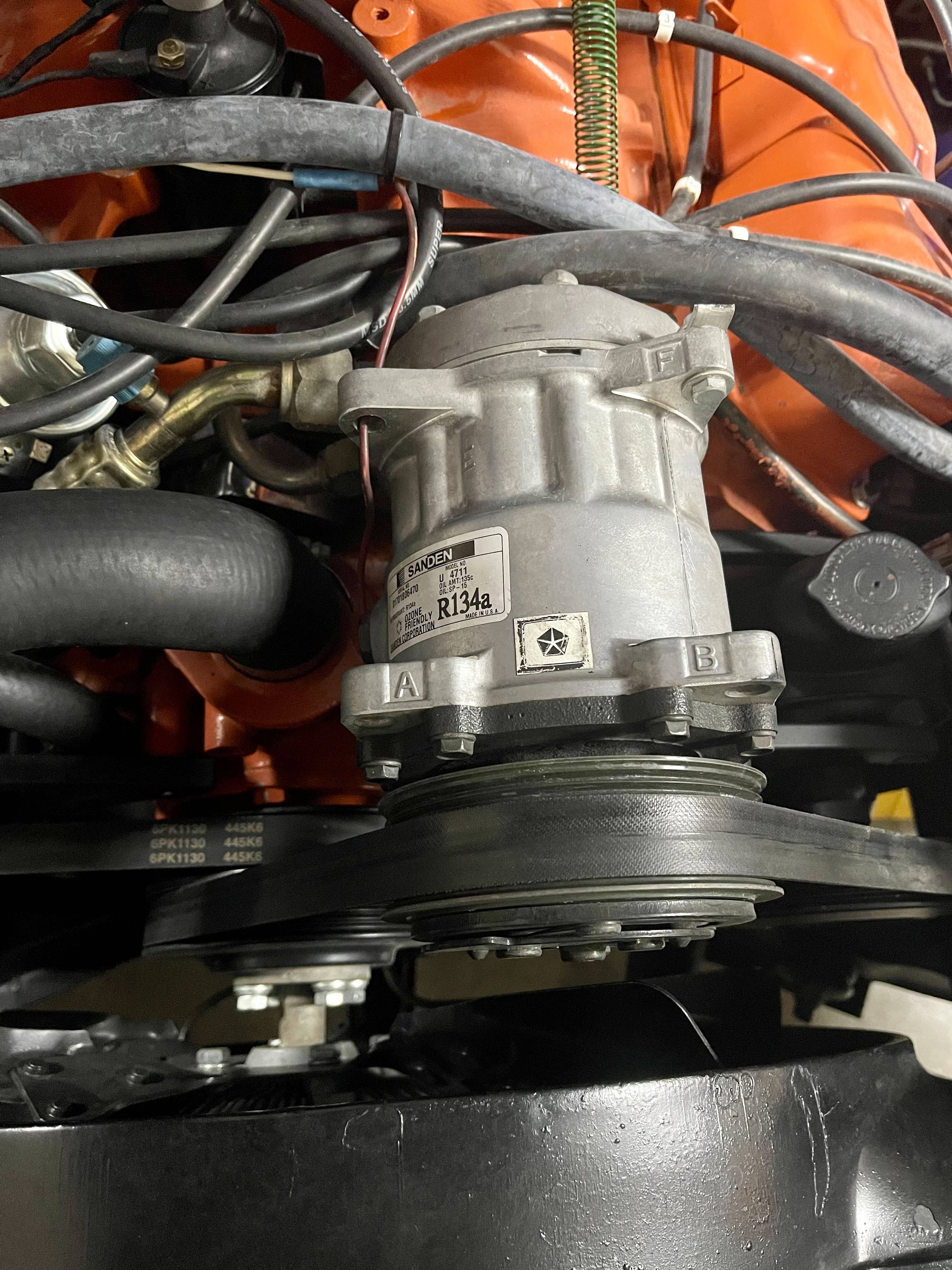

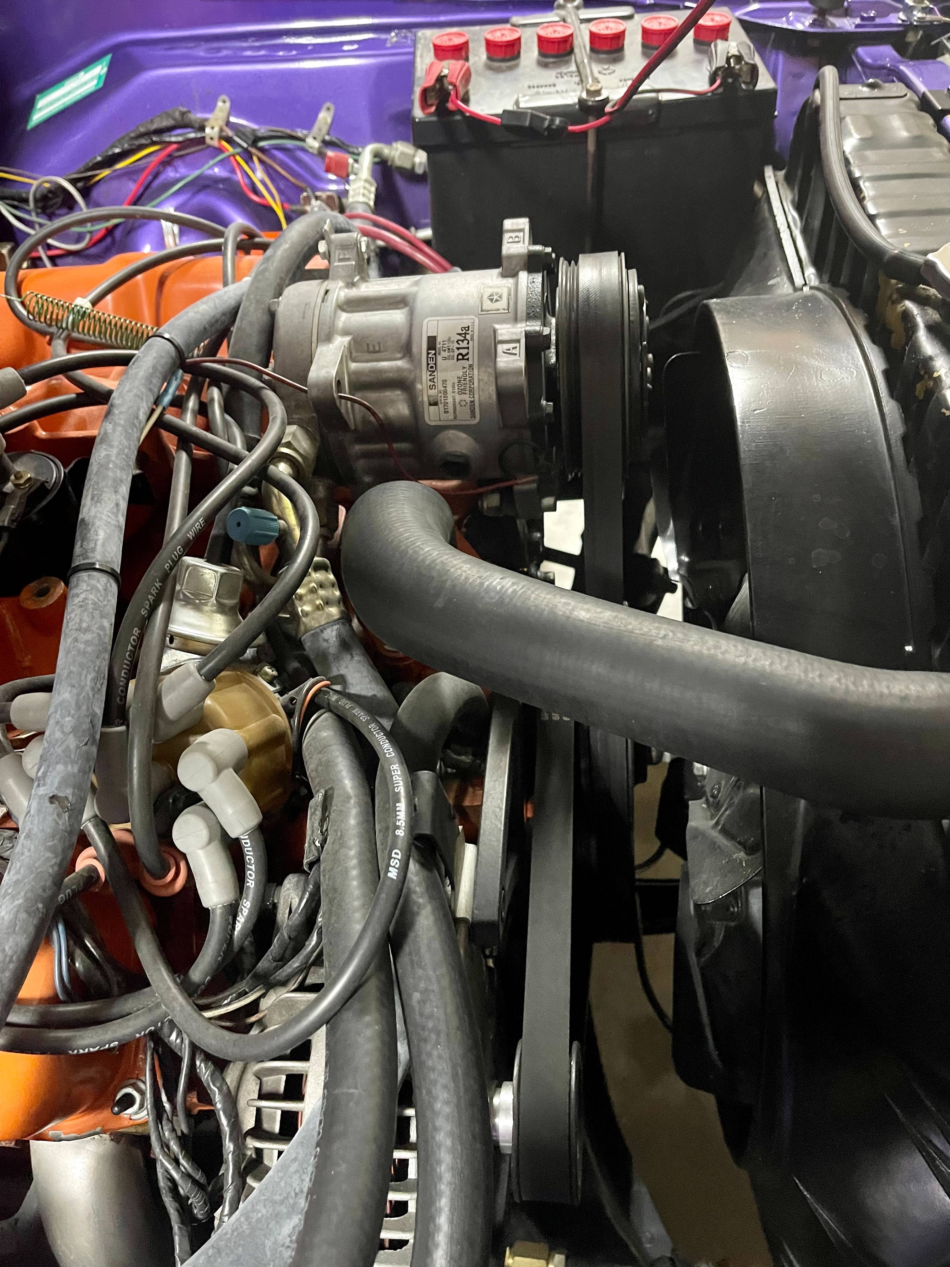

The aftermarket A/C will hook up to your factory dash vents using the hoses they provide in the kits. Just jam the hoses into the factory vent (see pic).
I have a factory-air 340 Cuda with a Classic Auto Air kit. New Sanden R134a compressor, underdash box, evaporator, heater core, heater control valve, drier, condenser, and all lines, etc. It is all in the kit. You should check out both Vintage and Classic to see which you prefer. There are control panel and cable versus servo differences that may sway you one way or the other.
I also used aftermarket March pulleys and brackets (powder coated satin black) for the compressor, water pump, power steering pump, alternator, and crank pulley. Two gilmer tooth belts (flat serpentine-style) drive everything with March turnbuckles to tension the belts. No belts slipping or flying off at high RPM, ever. It is a rare occasion that anyone even notices the drive belts are not V-belts. LOL And these belts have been on the car since 2000.
I installed my kit over 13 years ago and it runs the same today as the day I charged the system. The cost to do everything adds up quickly but that 40°F air blowing out the vents is worth it. You will not regret it.
