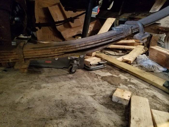

Weird things bolted to my leaf springs
bullet18
Jan 4, 2017
311
97
Anyone know what these things are? They look like segments of leaf springs but theyre clamped on behind the axle and they dont actually extend underneath the axle. When i first took the axle off i figured the leaf springs were just mangled from someone jumping the car or something like that but the bends are symmetrical so im beginning to doubt that. I looked up pictures of stock e body leaf springs and they dont have anything like these. My guess is theyre the equivalent of bondo but for leaf springs as the last person who tried to fix the car half assed the whole job.

They look like helper springs for towing these days people use airbags to help keep the vehicle level while towing before they had these helper springs they are like an extra leaf that bolts on to stiffen it up air shocks were another option.

Thanks! It also has air shocks (albeit wasted ones) so that would make sense. Im slowly figuring out more about the cars past as i go. It had a 318 originally so i guess it must have had a towing package because it also has an 8 3/4 instead of a 7 1/4.

well all the helper springs I have seen have more of a arch to them looks more like some one tried a half ass fix for a bad set of springs. bests to replace them instead of a quick fix like that.

I've had a few cars with those gizmos on them. I always assumed they were helpers or stiffeners. Might be an old time racer's trick to keep the rear from winding up, sort of like traction bars. Might just be snake oil.

I also thought it could be to control axle wrap but i dont think so after finding out it has 2.76s and an open diff.

Just a set of old helpers. Remove the airshocks and toss them. Inspect the upper shock mounts for damage as they were not intended to support any weight. If they are good, get a good set of modern shocks and a new set of springs or have the old ones rebuilt/reached if practical.

Thats pretty much my plan after i get it running but before i get it registered. I need the motivation of the car actually running because ive been working on it for 2 years now.

Air shocks were popular in the late 70's and early 80's you'd put them in and pump them up for that low front raised rear funny car look and then the extra wide tyres wouldn't scrape on the rear fenders, the car would handle real bad the rear end would kind of bounce around corners I remember them well. Eventually you would take it all off and be amazed how well the car handles with the standard parts.
