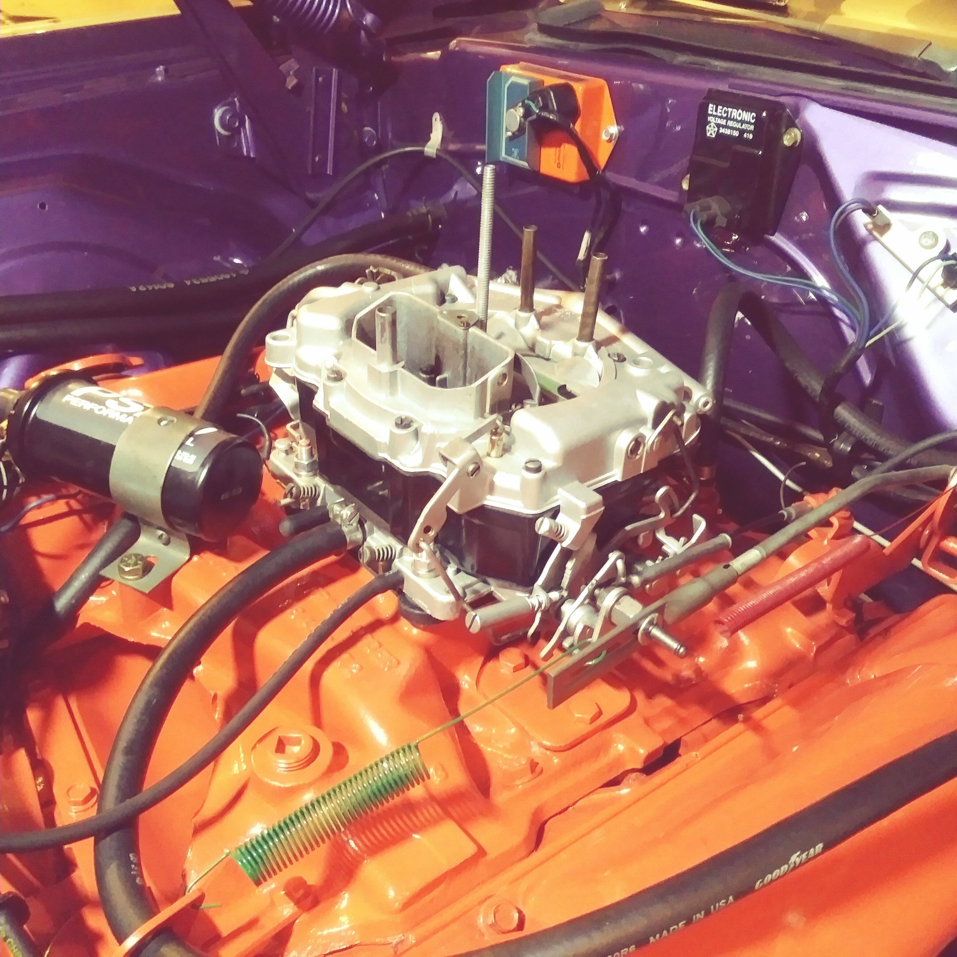

Having spent time tuning a 1411 Edelbrock I never felt comfortable with it. Always seemed like it wanted to run rich and difficult starting especially when hot. I started thinking if there was a modern carburetor that could give you performance and economy the spreadbore route is the way to go and there's only 1 carb that fit the bill. None other than the phenom known as the Thermo-quad (yes, you read that right). 15+ yrs of refinement, like the Q-jet cannot be equaled so I rolled the dice and let me tell you something, maybe because it's a factory carb not generic and an original AVS would perform just as well but it has such smoooooth power delivery and starting is a snap and that's with no choke, I really can't believe it....and looks like all get out....!!! Like it was meant to be there...

Agree, the Thermo-quad was the pinnacle. Out of production but can be found.
The Holley Street Demon carb is based in the Thermo-quad design.
Not only that but the same guy had a hand in both.... I tried one on for size and there are street kits available. It's actually bigger than a TQ with the electric choke hanging off it but a square bore. If the Thermo-quad didn't work out I probably would've went with that.....
