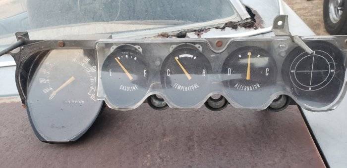

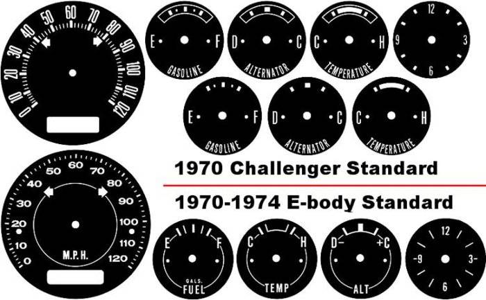

What would have determined whether a 1970 standard dash used the outlined hash marks (top row in the picture) or the non-outlined ones (2nd row)? My brothers 1970 Challenger has the outlined ones, but the cluster I picked up has the non-outlined 1970 gauges. Cuda/Barracuda/Challenger difference? Early/Late?

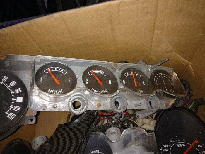

My 1971 Challenger uses the set in the 3rd row.
Credit to Performancecargraphics.com for the picture I borrowed.

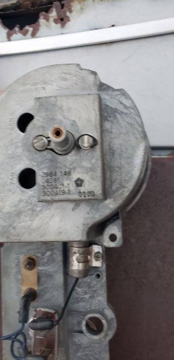

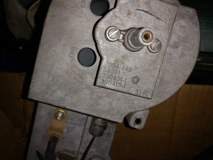

Here’s the one I have and it’s date code.

To add fuel to the fire my 71 Cuda also has the 3rd row gauge markings.
