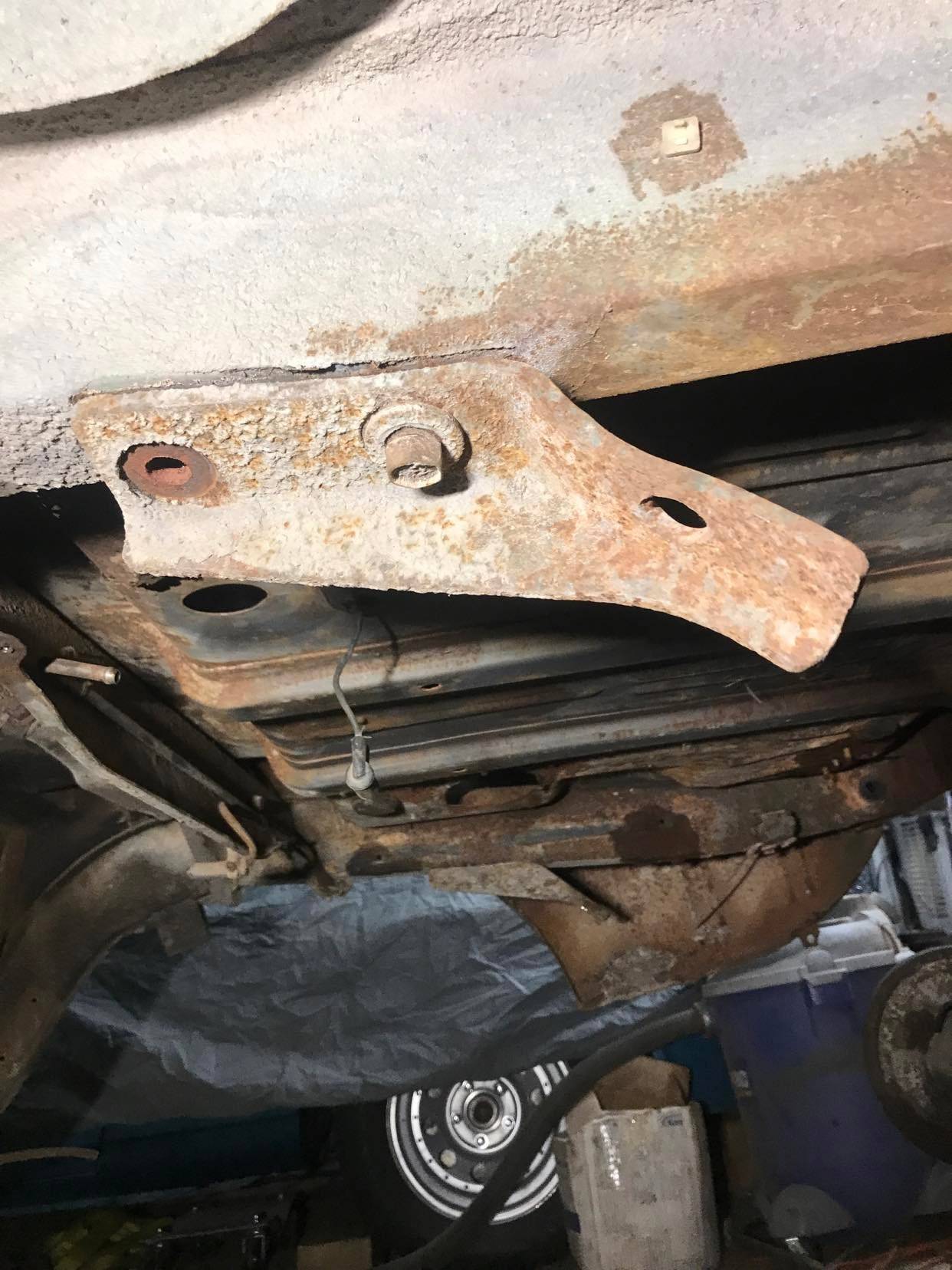

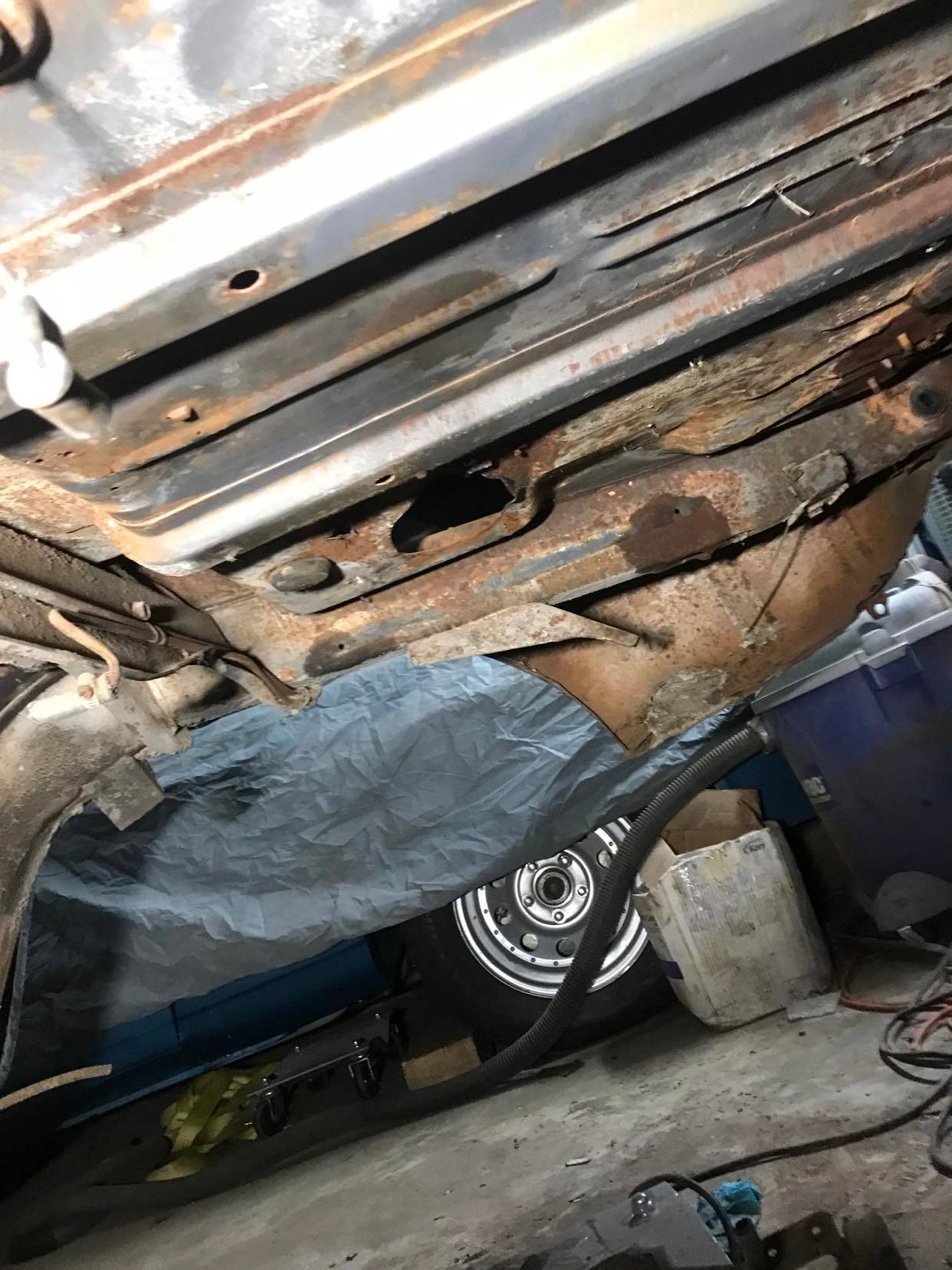

Apr 26, 2022 #1 Moespar Well-Known Member Joined Jun 26, 2020 Messages 55 Reaction score 15 Location Texas Stupid question... what is this? nothing was attached to it, and I can't figure out what it is for. Thanks

Apr 26, 2022 #2 floyd Well-Known Member Joined Mar 18, 2012 Messages 460 Reaction score 312 Tie downs used during shipment from the factory.
Apr 26, 2022 #3 doubleyellow Well-Known Member Joined Aug 3, 2015 Messages 363 Reaction score 97 Location Metro Detroit Thanks Floyd. I was also wondering what the heck those were. Do you happen to know the factory finish? Bare steel?
Apr 26, 2022 #4 floyd Well-Known Member Joined Mar 18, 2012 Messages 460 Reaction score 312 Correct, bare steel.
Apr 26, 2022 #5 Moespar Well-Known Member Joined Jun 26, 2020 Messages 55 Reaction score 15 Location Texas Thanks floyd, I'd a never guessed that !

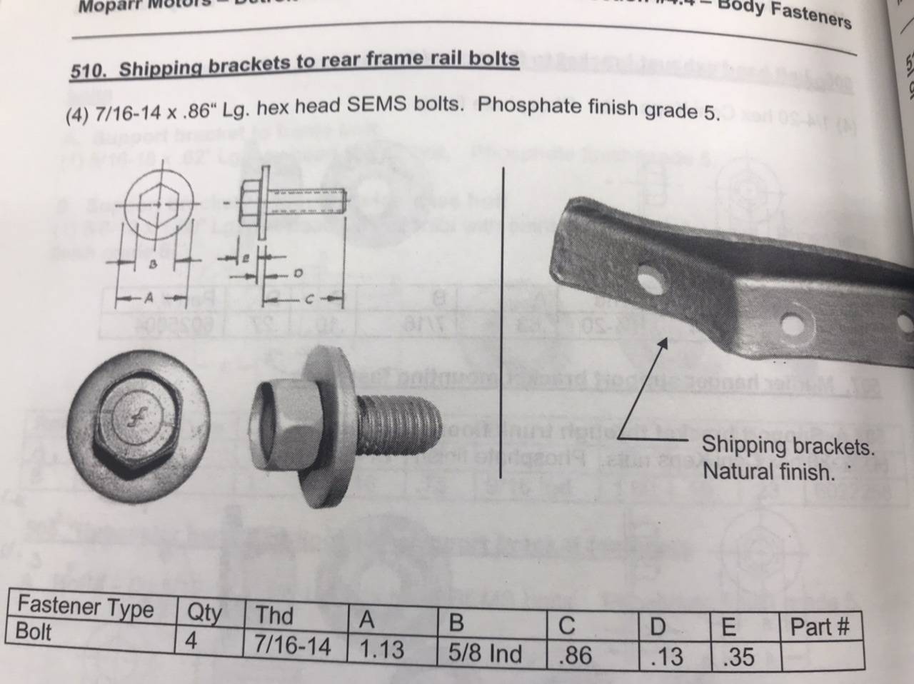

Apr 28, 2022 #6 doubleyellow Well-Known Member Joined Aug 3, 2015 Messages 363 Reaction score 97 Location Metro Detroit Hi Floyd, since on the subject, you happen to now the finish on the Bolts for the tie downs? Thanks again
Apr 28, 2022 #7 floyd Well-Known Member Joined Mar 18, 2012 Messages 460 Reaction score 312 Here you go
May 2, 2022 #8 doubleyellow Well-Known Member Joined Aug 3, 2015 Messages 363 Reaction score 97 Location Metro Detroit Thanks Floyd. Hate to bother you one last time, but I assume "Phosphate" means back, not silver correct?
May 2, 2022 #9 rklein71 Well-Known Member Joined Feb 27, 2015 Messages 1,256 Reaction score 615 Location Amarillo Texas Phosphate is black, but it’s not paint. More like gun blueing.
May 4, 2022 #10 M michael bucklew Well-Known Member Joined Aug 24, 2019 Messages 329 Reaction score 44 floyd said: Tie downs used during shipment from the factory. Click to expand... have those on my challenger. put them back on now can be eliminated
