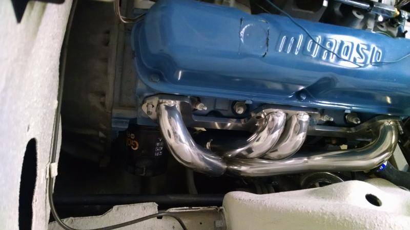

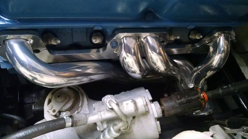

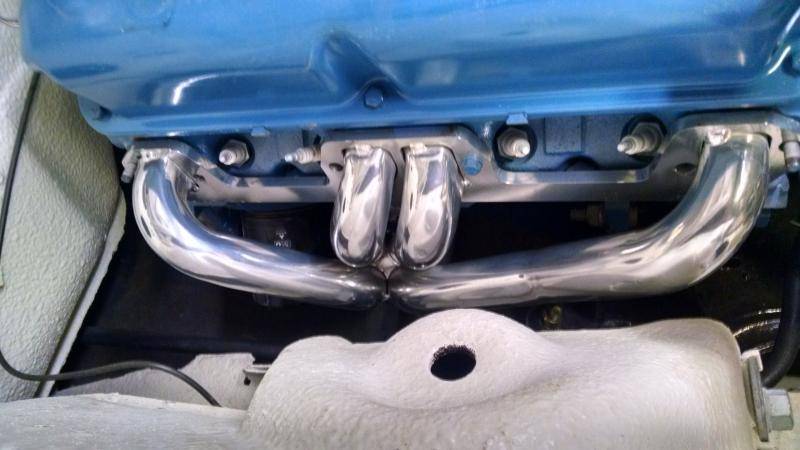

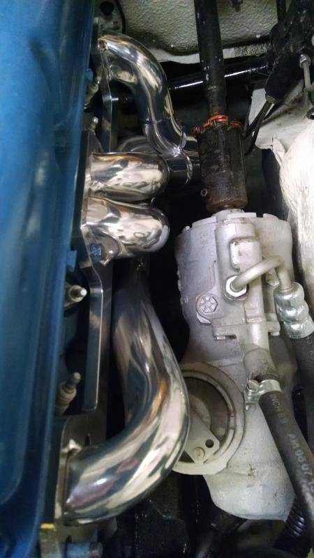

The polished ceramic coated headers with the exhaust pipes and mufflers less the trumpet tips totaled about $1,600 with freight. Rob's sold to me at the listed price on the TTi website. TTi's website has prices listed on it. Customer service is great at Rob's. Very friendly to deal with. They own and drive a 73 Challenger.
View attachment 23066View attachment 23067View attachment 23068View attachment 23069
Can you post a part number Used for the headers can't seem to find Them on TTI 's website

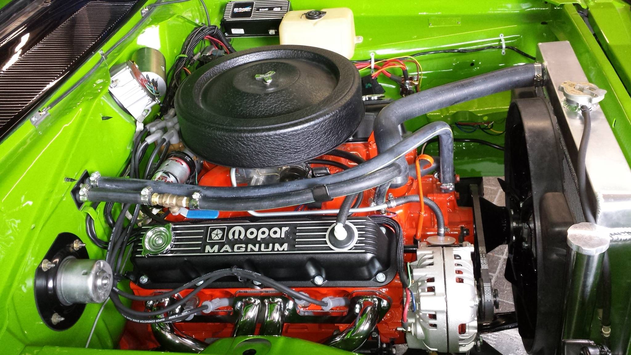

I've used a few sets of TTI BB and Hemi big tube headers and have always been real happy with them.
On my 72 Dart with a 5.9 Magnum and 4-spd In used their shorties and head pipes because they were the only shorties for an A body with a 4-spd. Headers fit great. Had to do a little messaging on the left head pipe but no biggie.

The TTI shortys do go in from the top and no need to remove starter at all. One bolt on the flange is over the starter I welded the bolt in to make it easier.

That is what I have they are very easy to fit and work on.
As I said I have removed them and reinstalled them from up top so I know it can be done.
